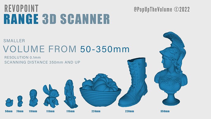

Here on request , how small objects you can scan with Range 3D Scanner
the volume for the smallest object at this moment is 50 x 50 x 50 mm , scanning distance starts at 300-350 mm where POP2 ends in Feature Mode .
To better understand , Range starts where POP2 ends , but starting at 300mm scanning distance an object scanned with POP2 and Range will have the same quality , however higher scanning distance will decline POP2 quality but not the one of Range .
in this image below you see where POP2 ends and Range starts
and here some smaller volume tests examples between 50-350mm
of course it is still just Beta prototype so nothing is written yet in a stone.
But it will give you an idea what you actually can do with Range when scanning smaller volumes on its own.
Note: RANGE is not a replacement for POP2 , POP2 will still deliver better accuracy at 15cm distance scanning the same objects above.
All scanned objects above with Range was scanned just with one 360 degrees rotation between 360-450 frames.

Stunning scanning quality. Absolutely beautiful the pose, the theme, and the framing. Eager to see more of your new scans!
Amazing topology and detail. I’m curious about the textures. Can you show us how it looks with color/texture in a future post? Thanks in advance!

Thank you Richard , I am not really allowed to post yet the color scans since we use very early prototype at this moment and not everything is ready yet.
I just posted the scan render converting the RGB data to textures manually , I posted it above ( white boots 2 x 3D color renders )
