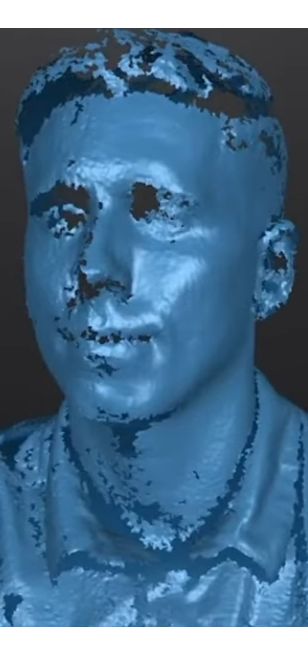

When you look at one pass of Einstar result by Shining3D expert.

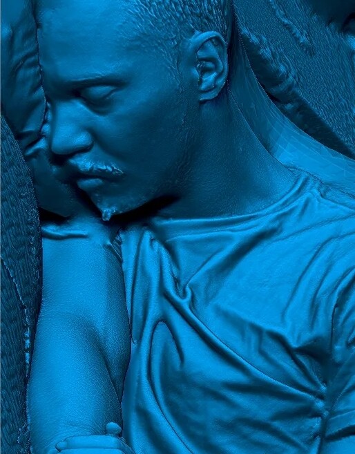

And one pass of Range
(Not edited raw one pass handheld scan meshed in Revo Studio)
The result is clear

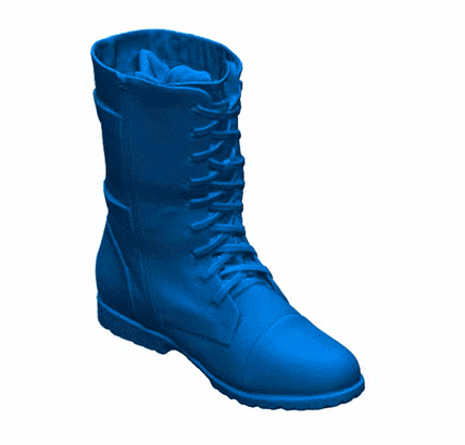

Some smaller scan with Range , only one pass 360 degrees around 400 frames at around 40cm distance .
No edited , fused point cloud meshed in Revo Studio

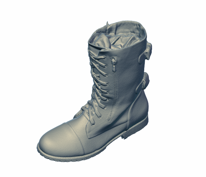

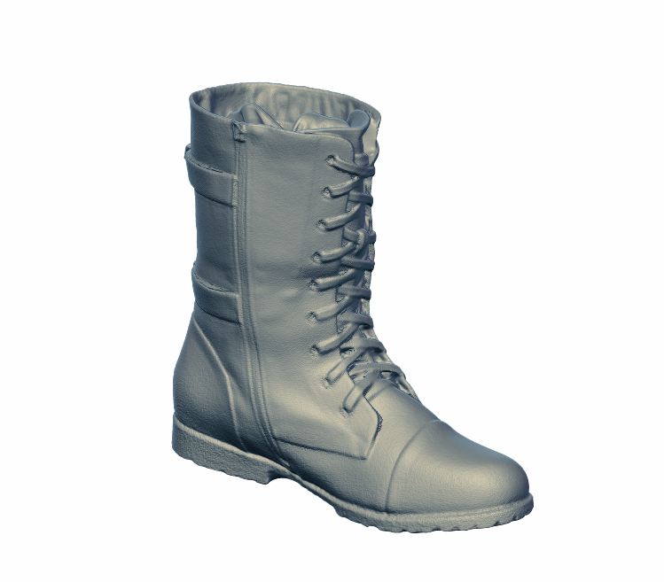

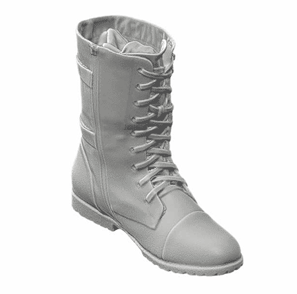

Here 3D renders of the 3D Scan
The 8 million poly scan was simplified to just 2K poly and rendered with Displacement , Normal and Albedo maps extracted from the mesh.
Nothing really mind blowing here , but the fact that was scanned with just one rotation of 360 degrees make it kind of special if you into assets for games or organic modeling etc…
