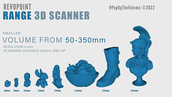

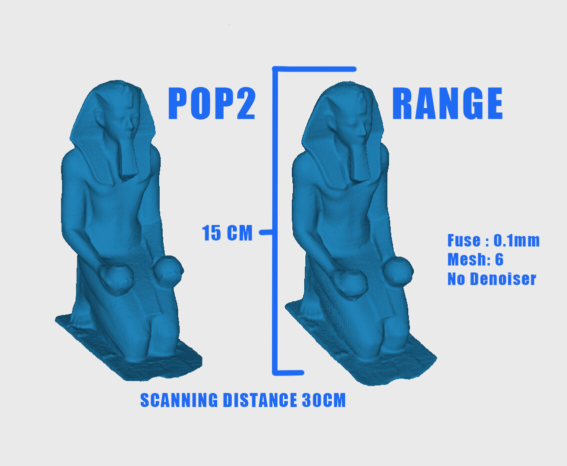

What happens I scan something like an owl? Size 280mm x 80mm x 70mm. Will it lose track?

Not really , I have perfect scans with 150mm height as long you keep the distance at 30cm exactly from the center of the object .
Here reference for you
And here the smaller sizes scanned starting from 50mm height
