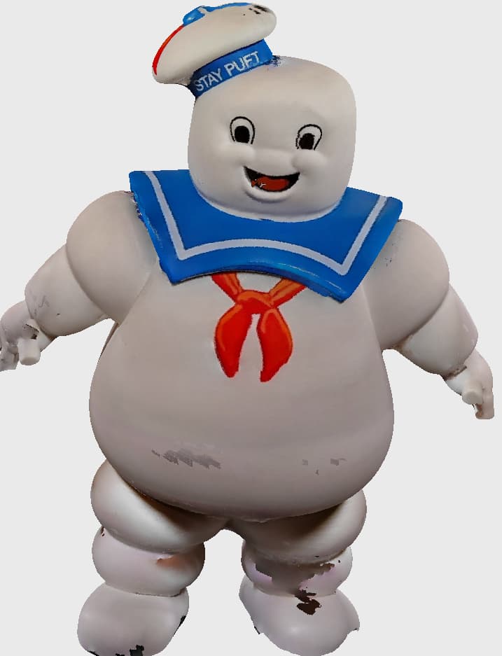

did some quick tests, looked ok, my lighting wasn’t very good, included a screen shot of the version I used
hope it helps
Thank you Johnathan, I see slightly shift to the right on the blue collar, but the rest looks ok as for POP2.
