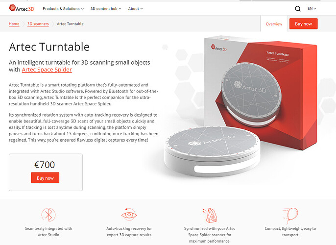

the closest thing i could find was a 700€ Bluetooth single axis turntable from Artec:
https://www.artec3d.com/portable-3d-scanners/turntable

Well…you know Artec price tags. I’m not surprised about that :sweat_smile:
But i liked the way the turntable is synchronized with the software and is able to turn back to the point where the scanner lost track. It’s not really difficult to implement (if Revopoint hasn’t done it yet) having already Bluetooth connection.
