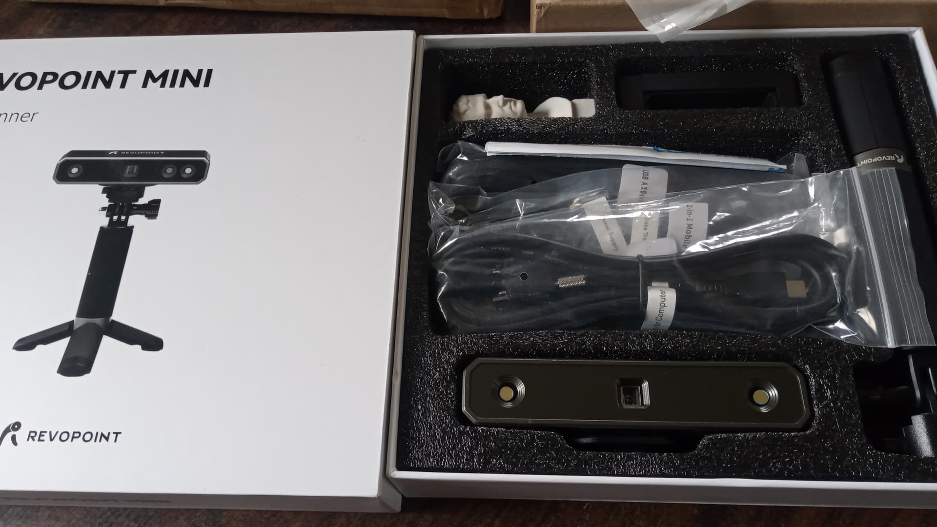

Just got the Revopoint MINI Beta Unit a few days ago and have to say I’m happy with the results

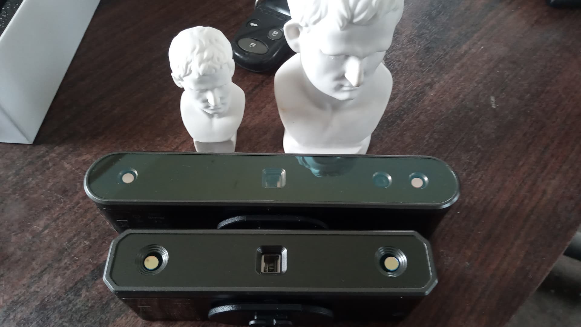

POP2 & MINI companions
Deadpool figure with POP2 bust for size comparison
3D printed Deadpool POP2 V MINI

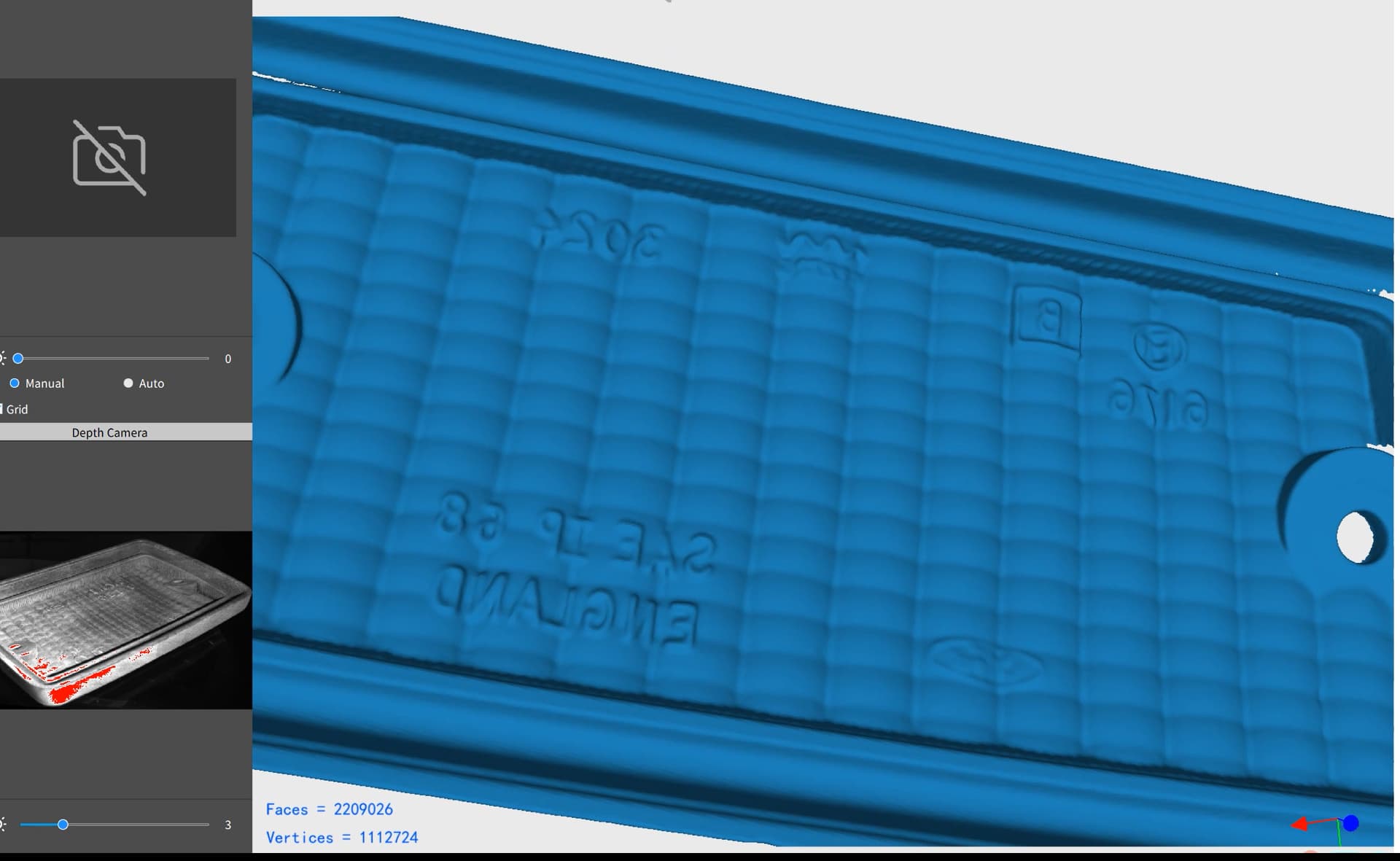

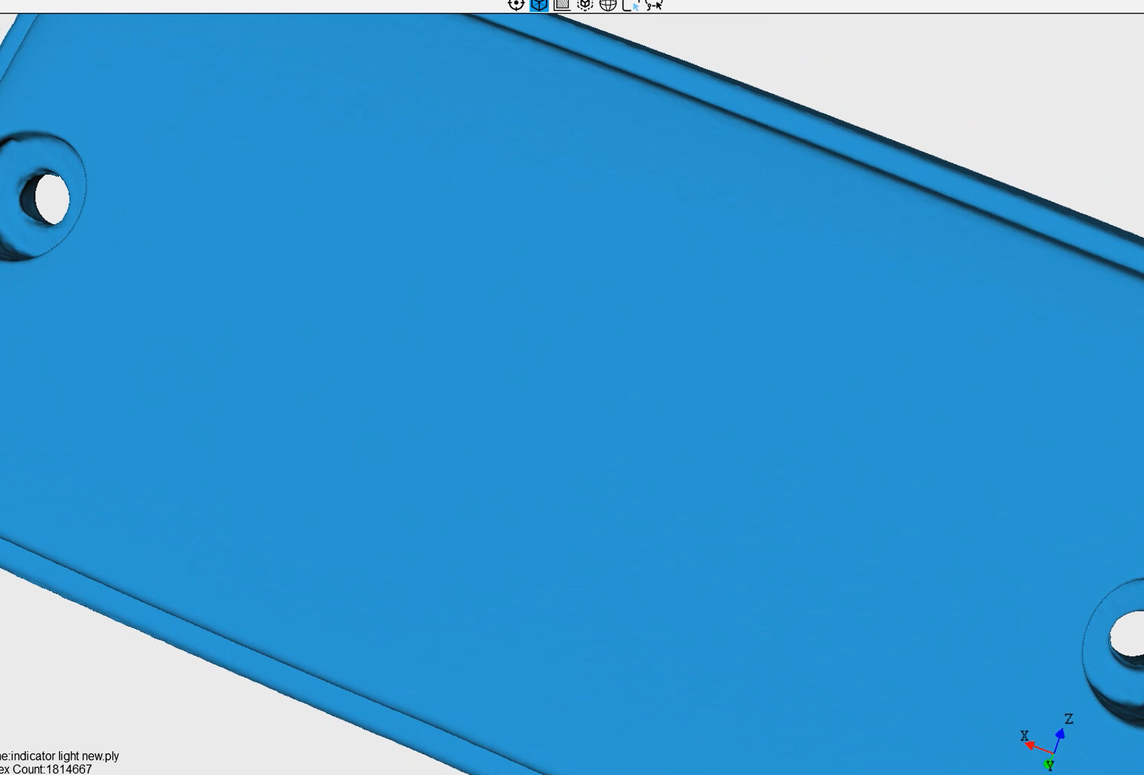

MK1 Escort Indicator lens
POP2 scan of a second lens which has different text detail that didn’t scan well, I must add that until I got the MINI I was more than happy with this scan by the POP2 the MINI just takes it to another level of detail
MINI picked up the text perfectly
compared to my old scanner done a few years ago I think the MINI did a better job and was a lot quicker

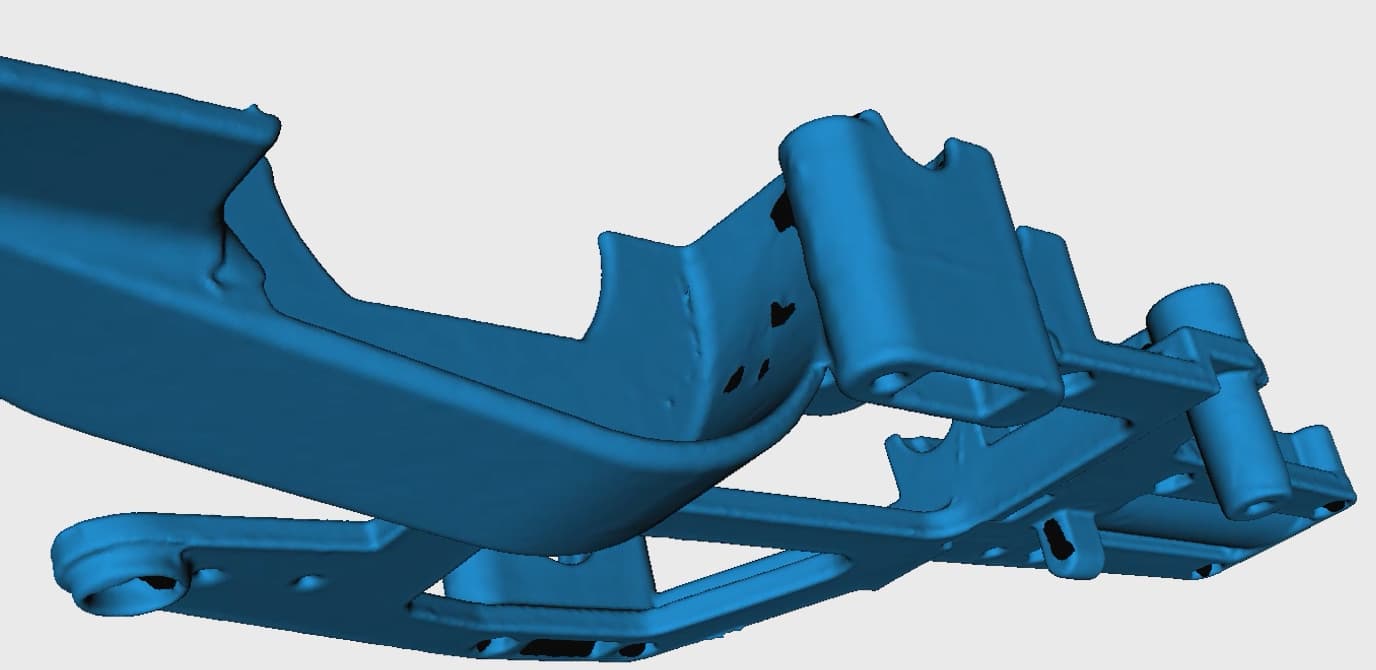

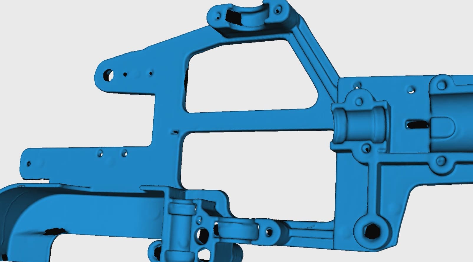

RC Helicopter side frame scanned with MINI point pitch at 0.1, mesh at 5.8 zero de-noise, used AESUB Orange scanning spray which worked well except in areas that still had some oil residue that I hadn’t cleaned off correctly
That looks like a very complex scanning … Very cool Johnathan , thanks for sharing !
Thx for sharing! That looks GREAT! Any difficulties while scanning and stitching? With or without scanning spray used? What are the roughly dimensions of the frame? Can you share pics of the original part, too? TIA!

Did it in 2 sides with enough overlap to align in Revo Studio without much trouble
Yes a little complex but MINI handled well,
I Will try with POP2 tonight to see how it goes, probably do it quicker but less detail, with the smaller viewing area of the MINI it took a little planning to get everything but turned out ok
You did the planning well , so many corners still you was able to capture everything with so small window capture frame , well done ! It looks very good !
