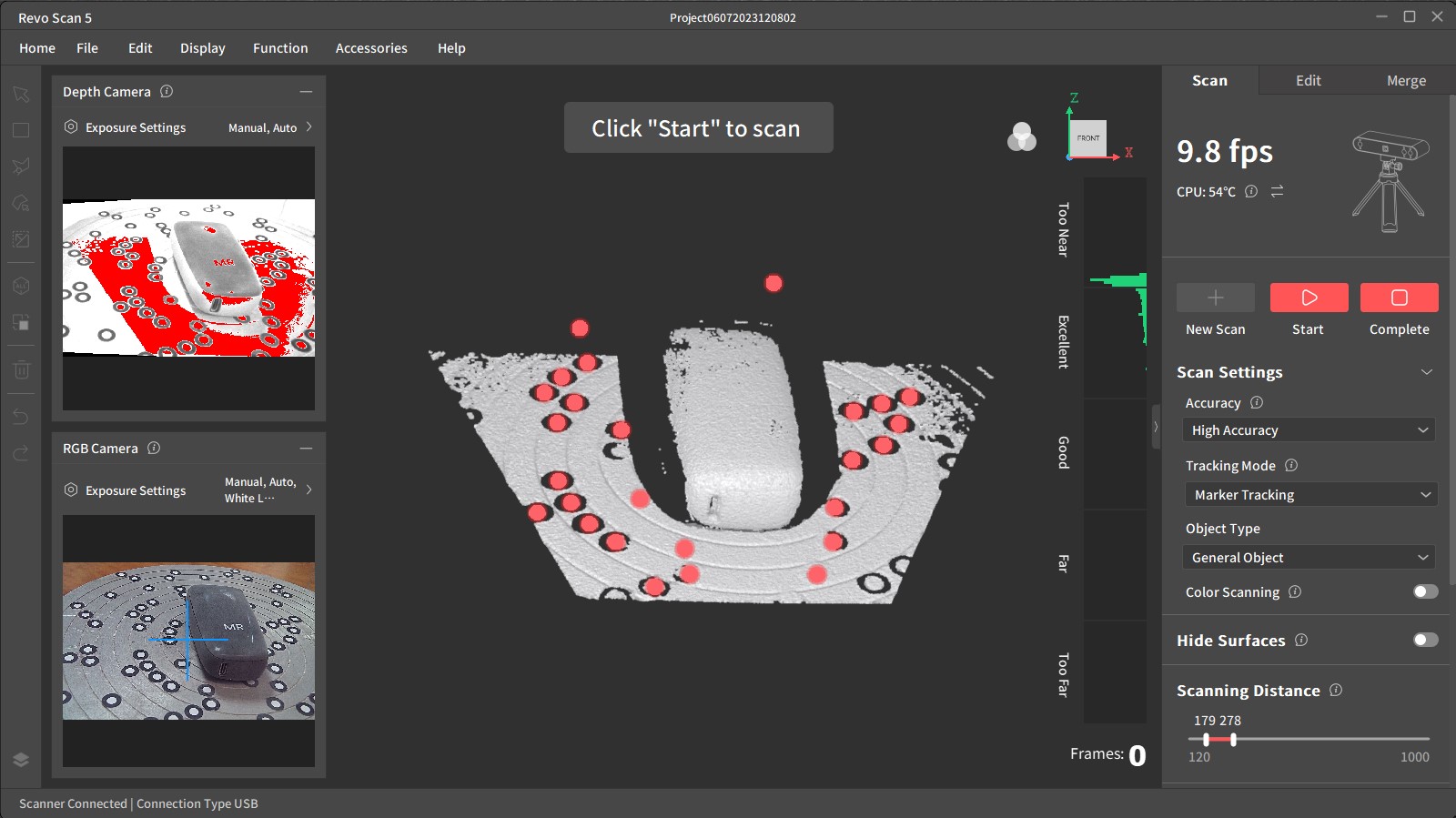

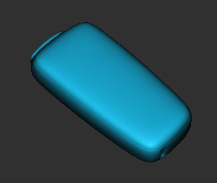

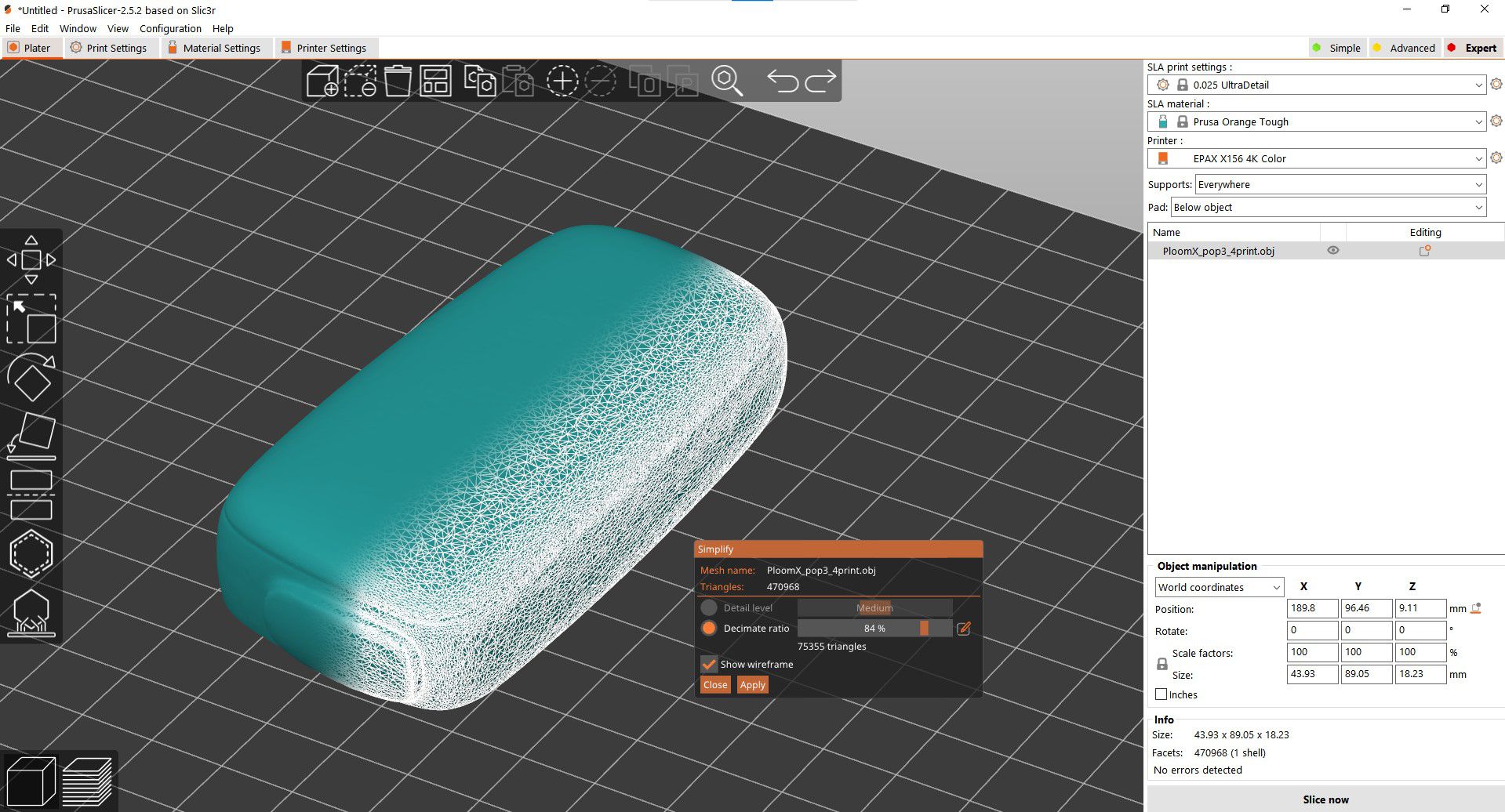

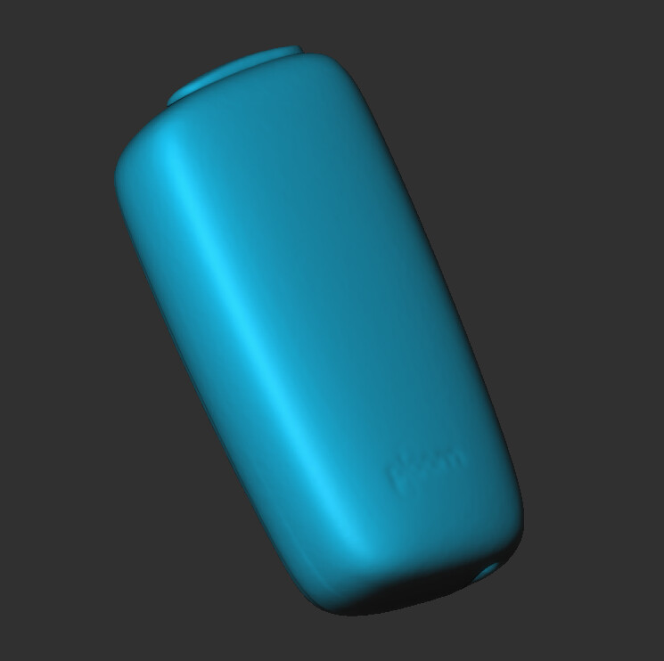

Reverse engineering a vape for mockup production

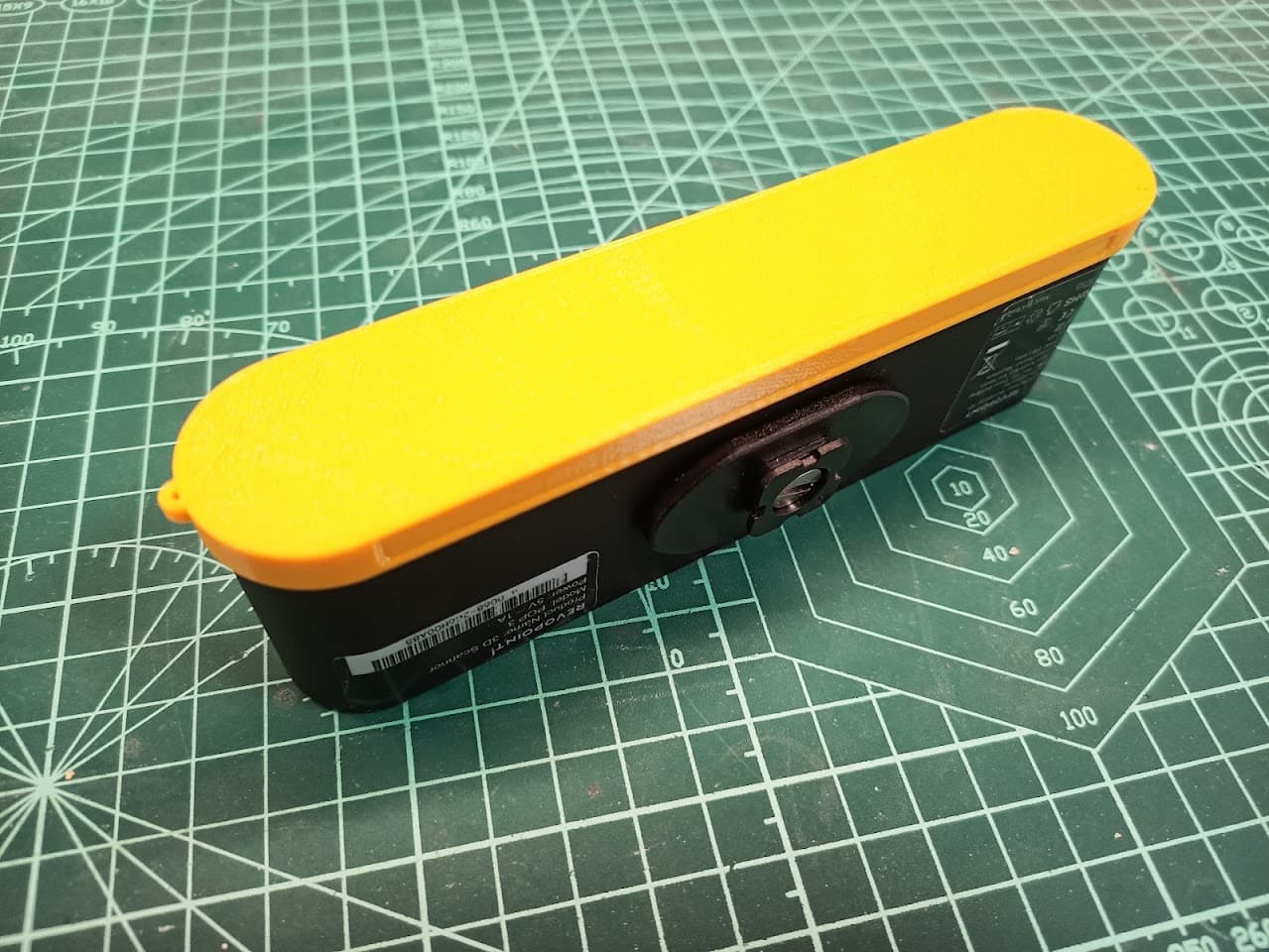

Lenscap
STEP and STL files here: 24.4 KB file on MEGA

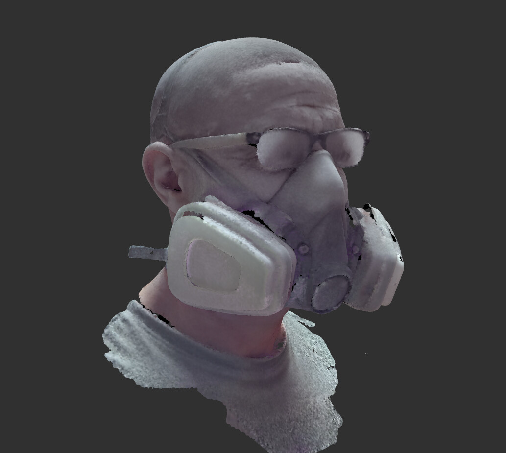

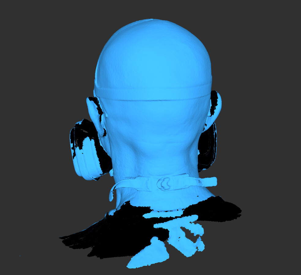

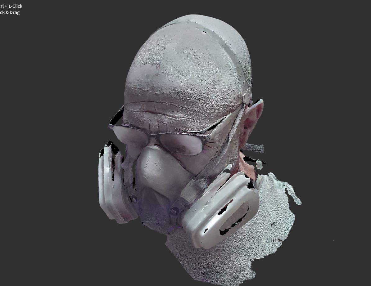

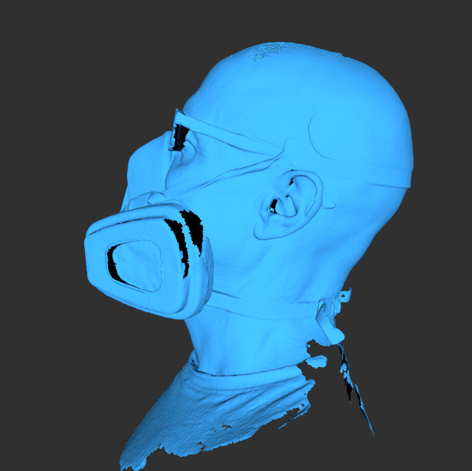

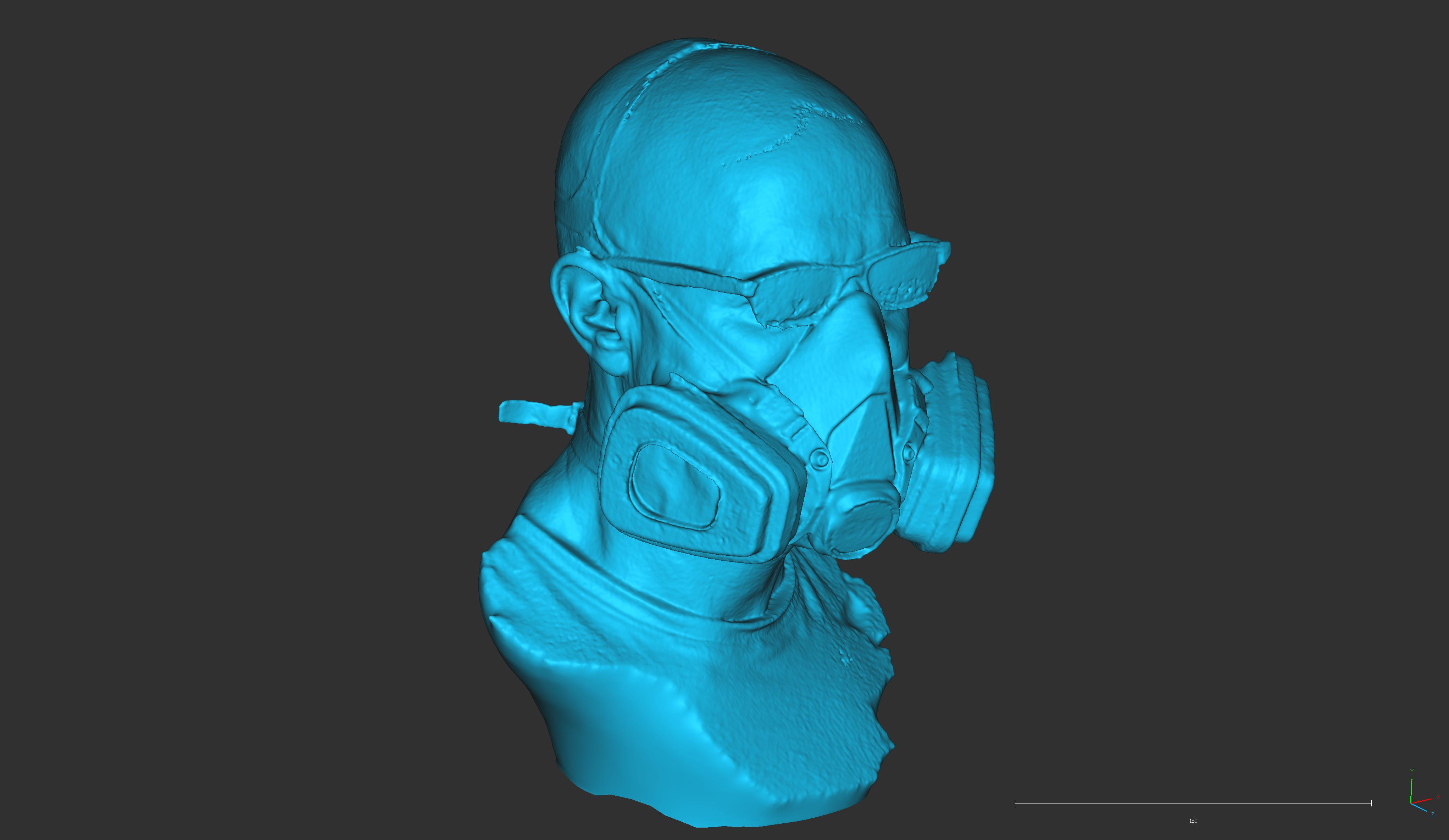

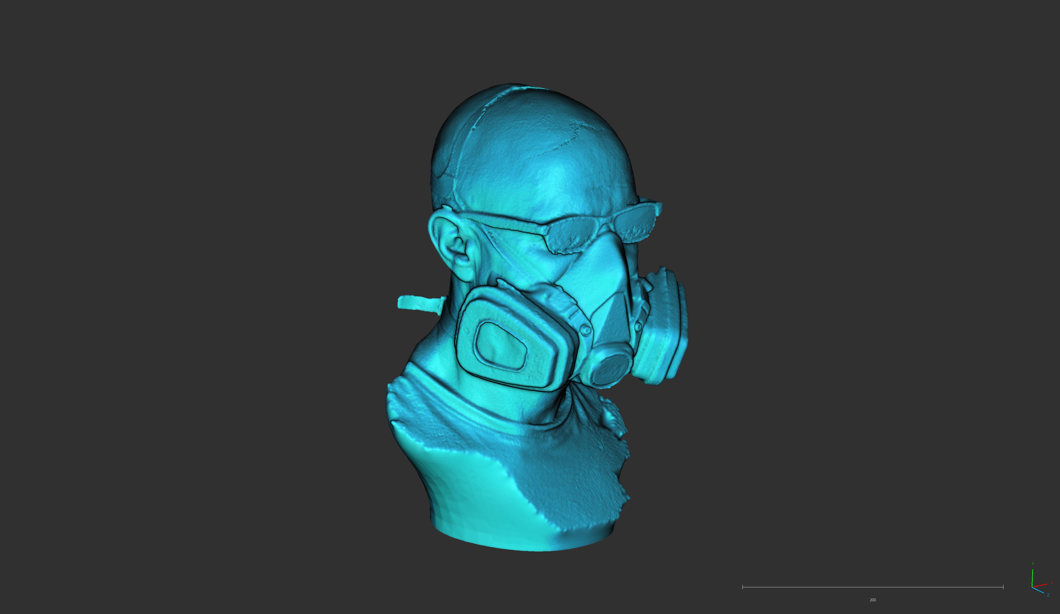

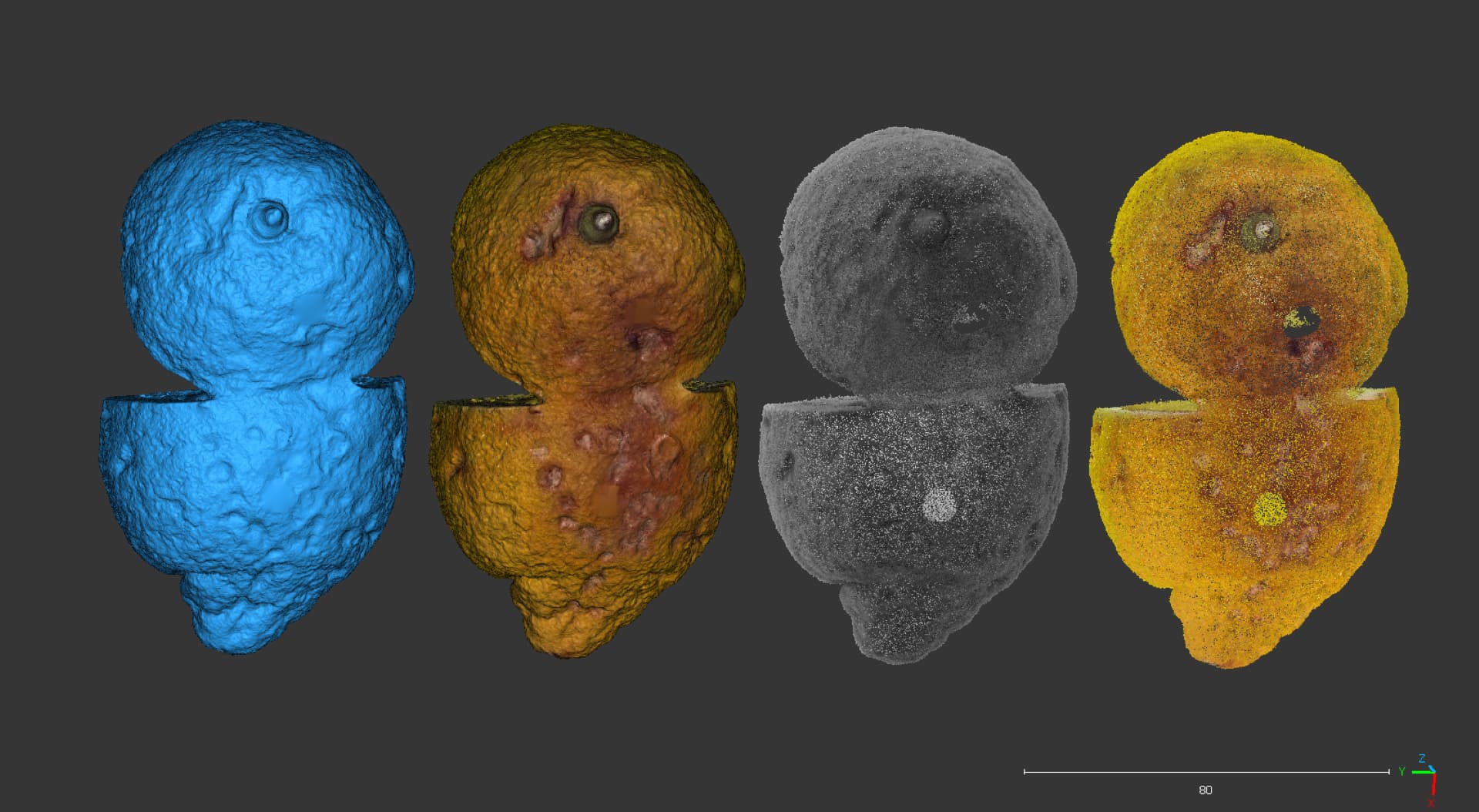

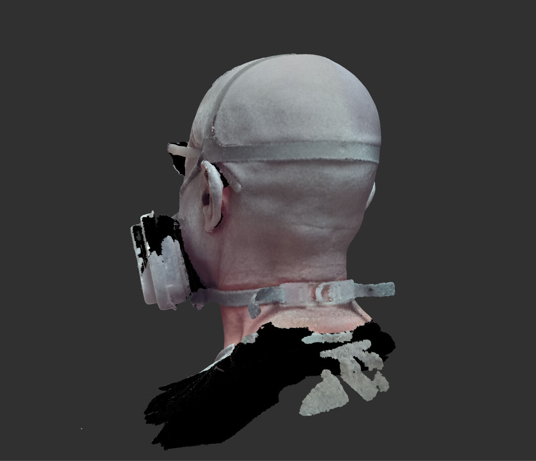

Madmax dusty road
RS5 - Android + Android auto processing
With Color
Model
Android Model Textured on PC
Cloud Compare L10
Real model
Capture frames

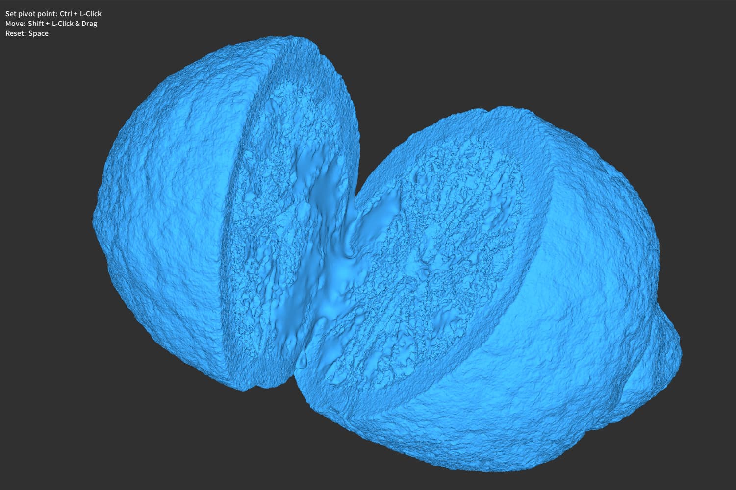

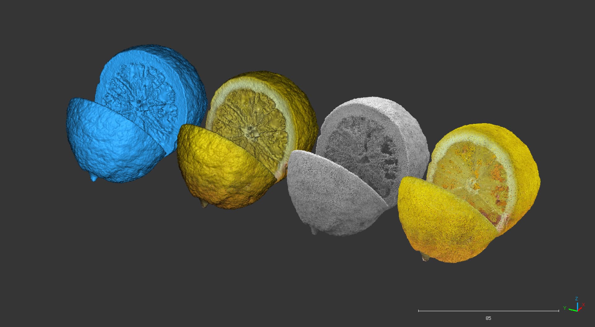

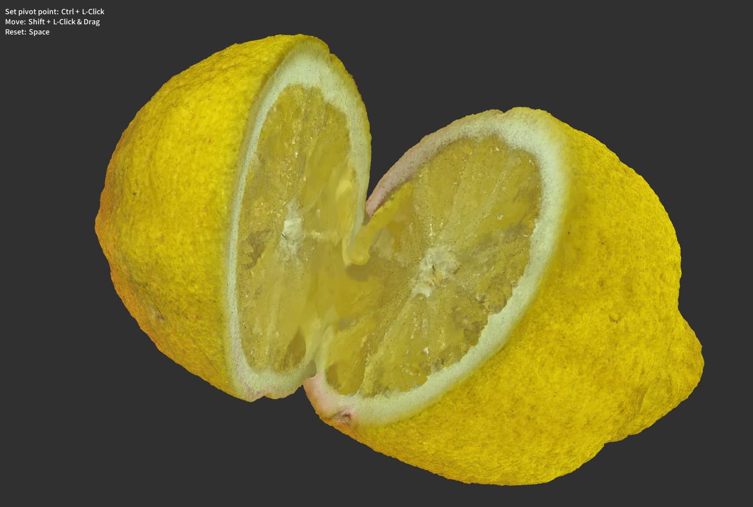

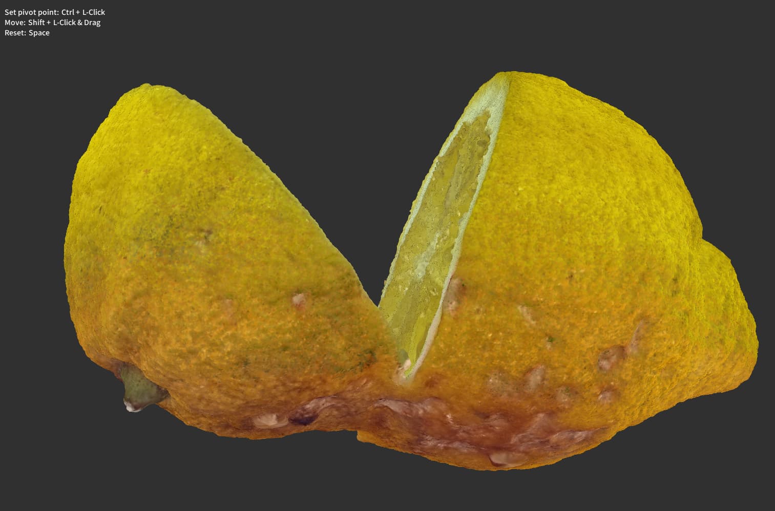

Not a Lemon
RS5.0.6.256 L6
TEXTURED
NO COLOR
Original setup
Cloudcompare L10

I gotta really finish my vape bumper project I started ages ago… I’ve gotten much better at reverse engineering stuff from scans since i started it lol

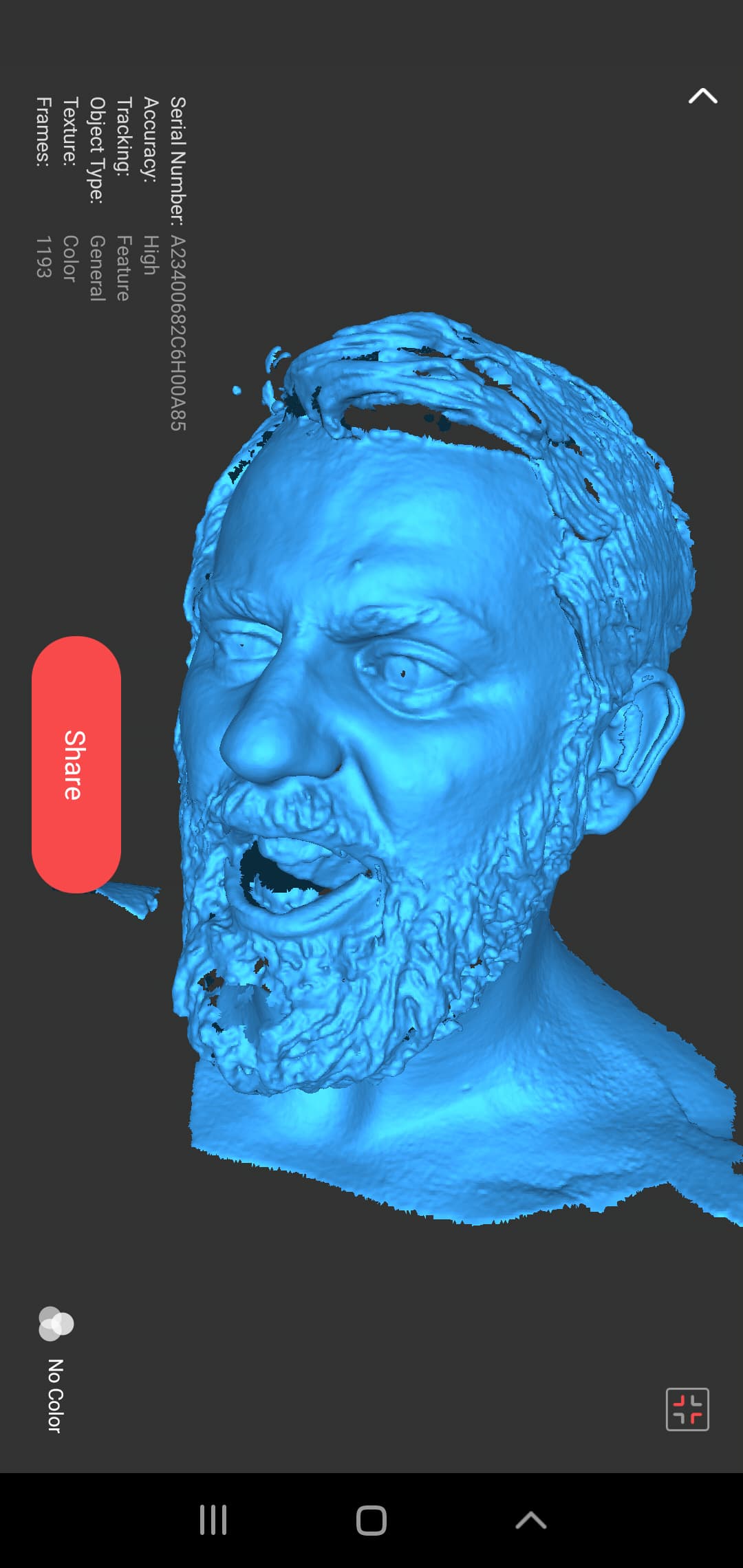

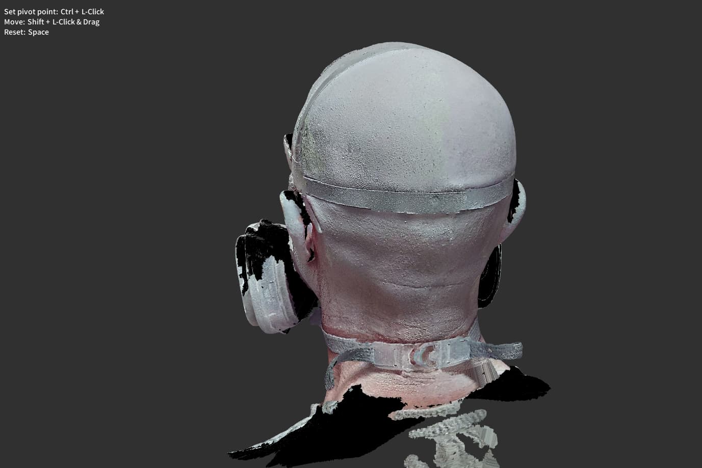

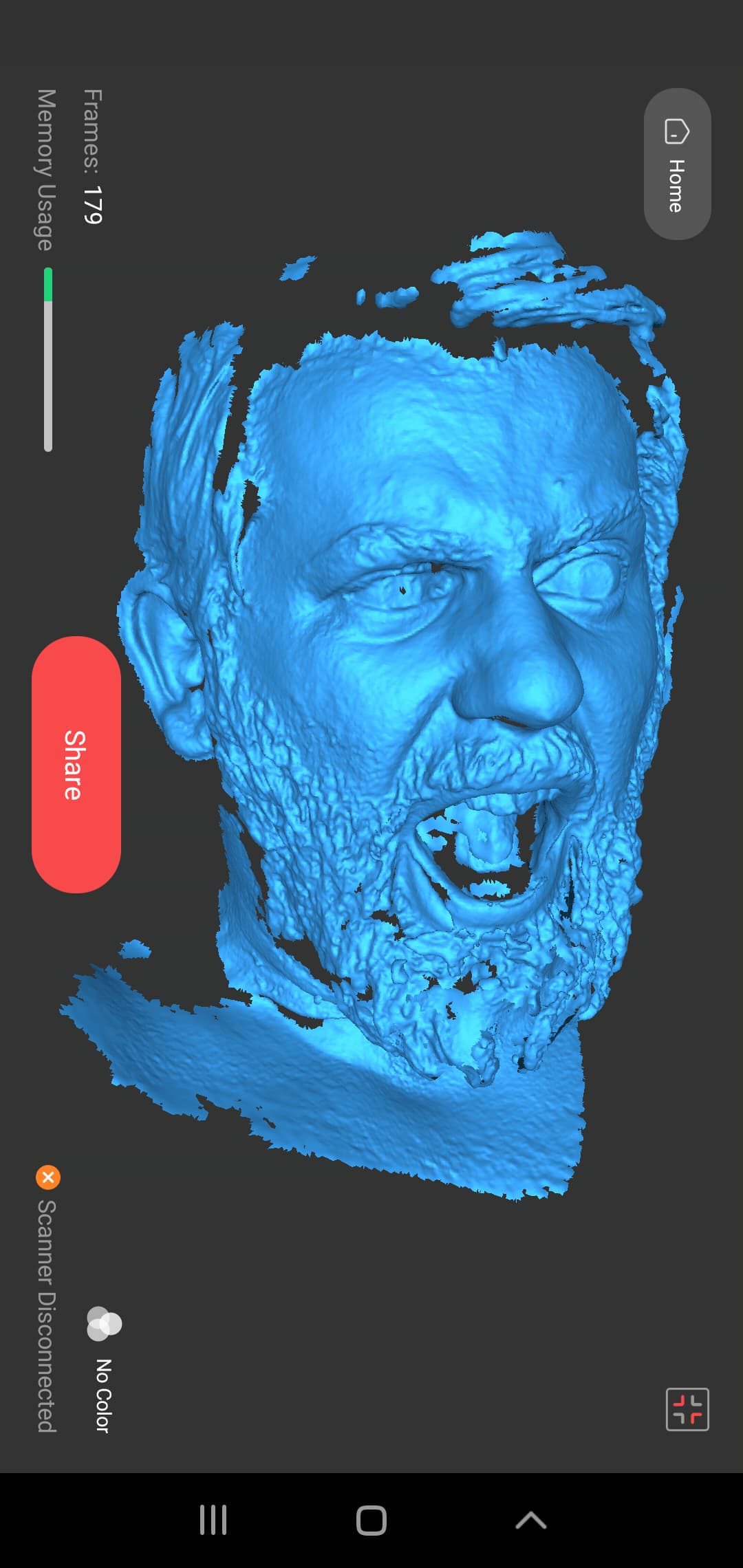

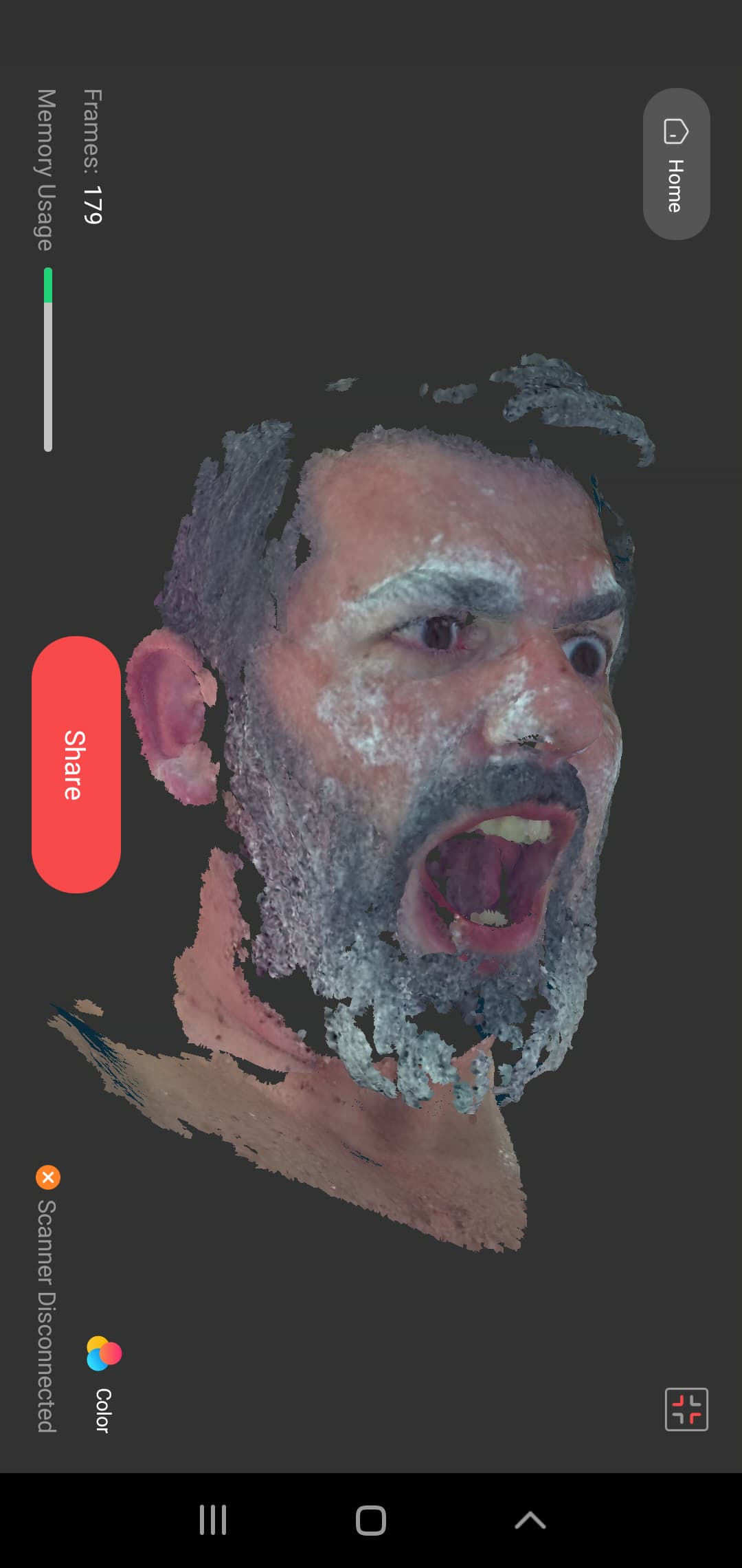

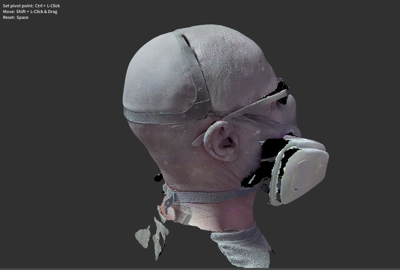

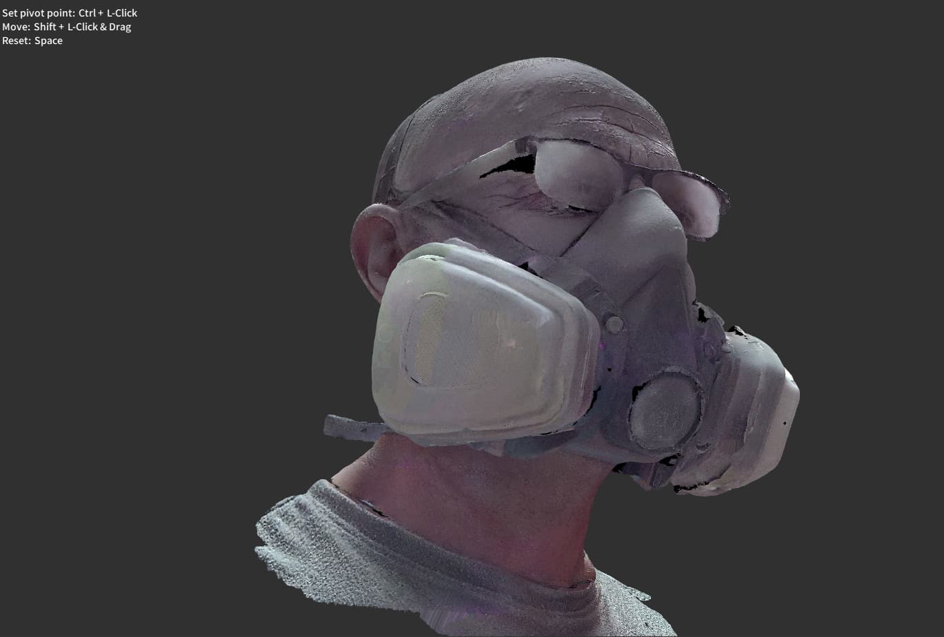

Expressions quick capture, PC RS5
These are all android RS5 scan, align, mesh

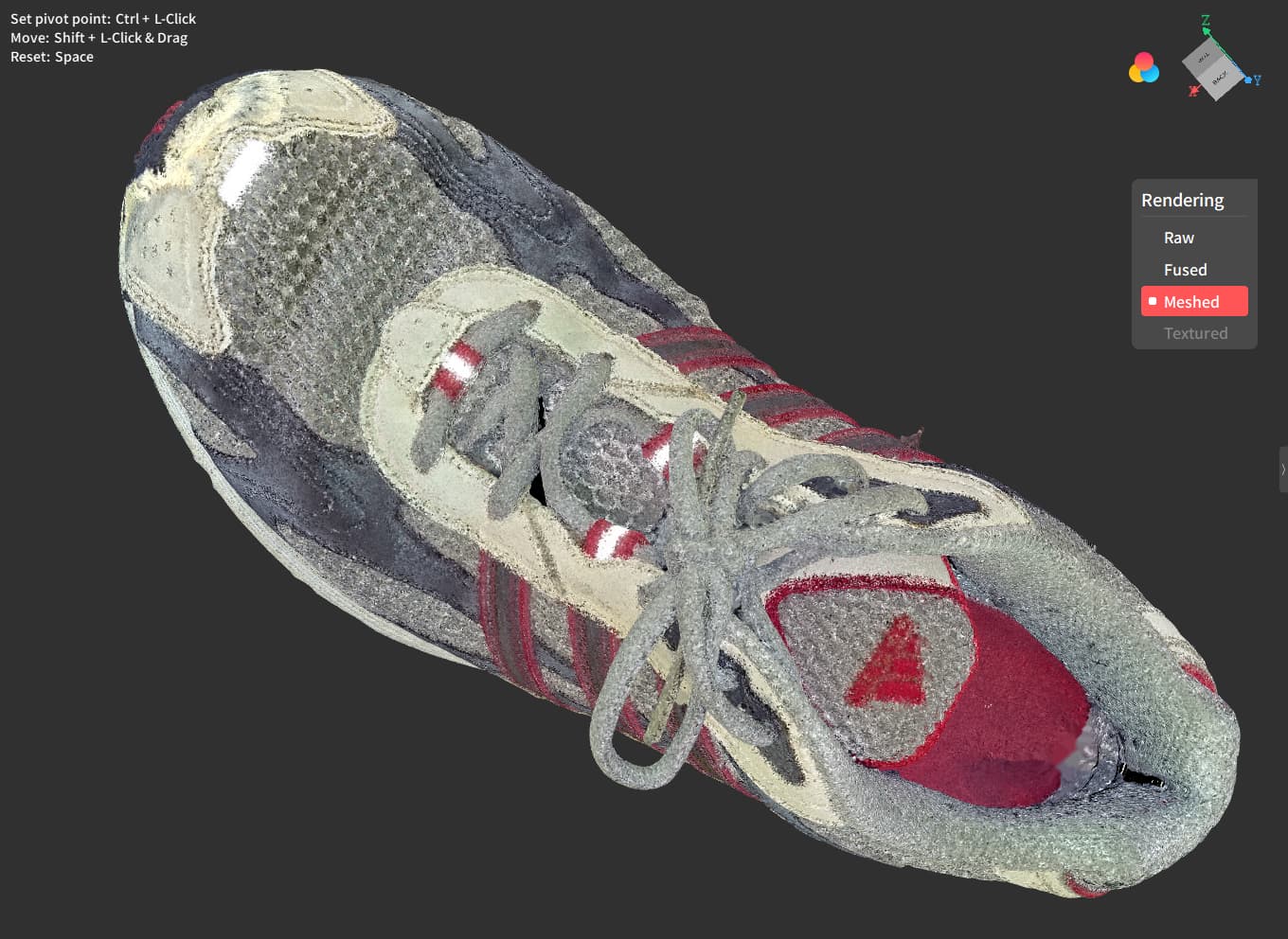

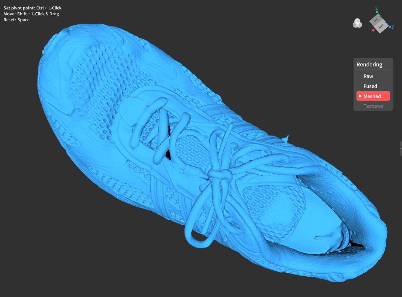

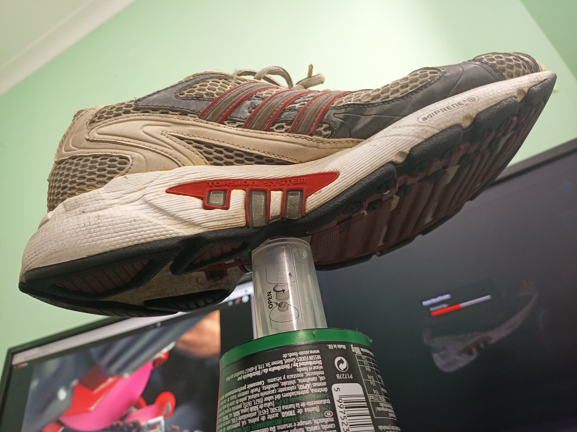

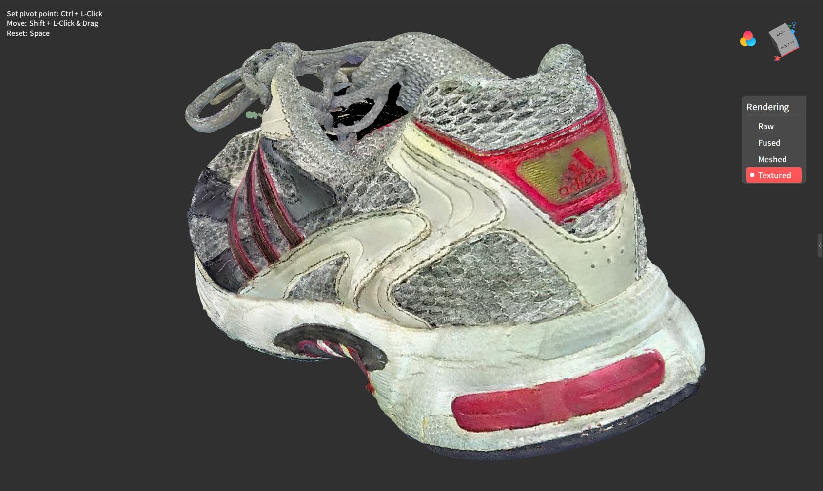

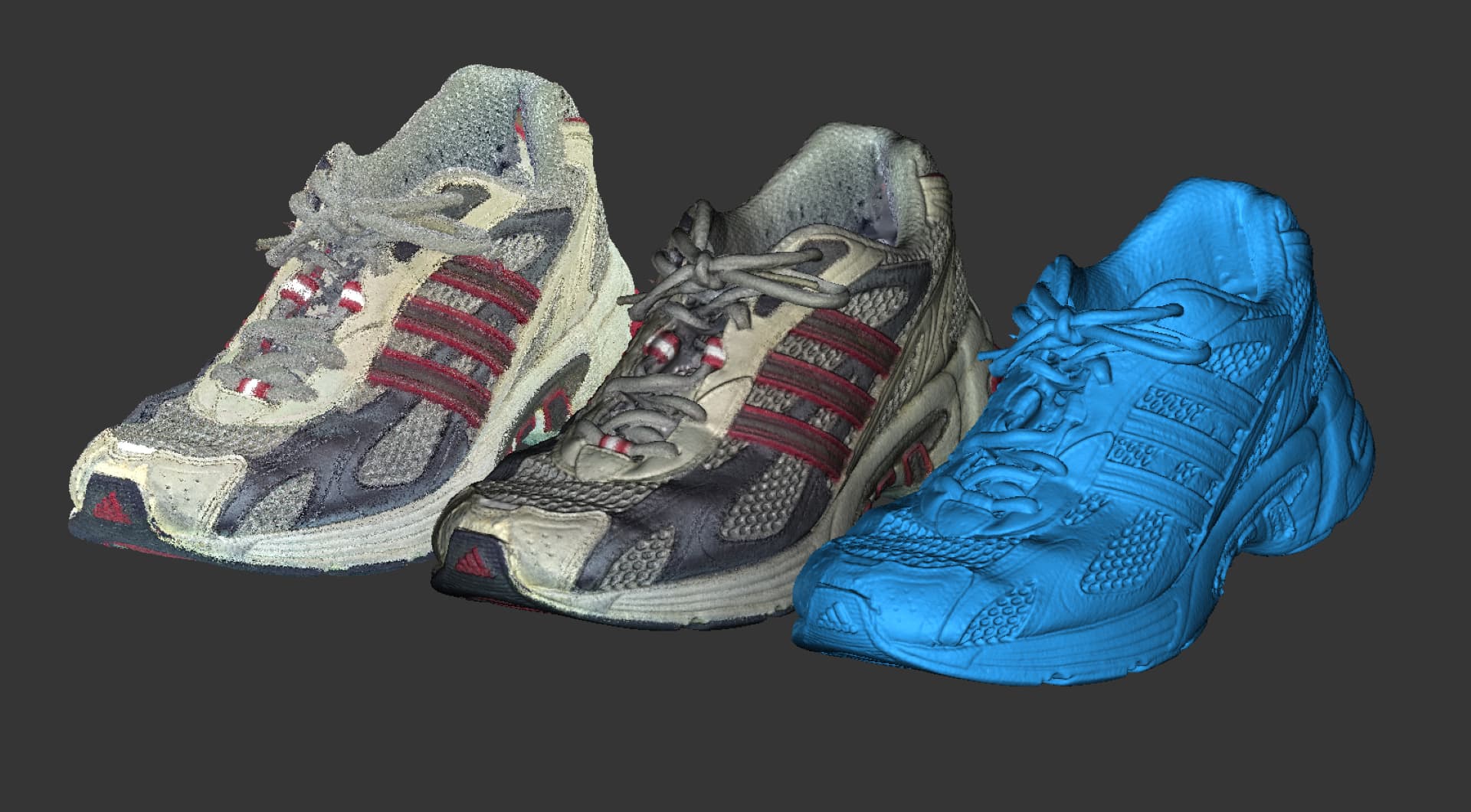

Shoe fits
All single capture with pop turntable and textures
RS Rebuild L6 + Texture
Real model
shoe_pop3_showcase
Cloudcompare CloudClean, Level + Rebuild L10
shoe_pop3_showcase_CC_pointcloud

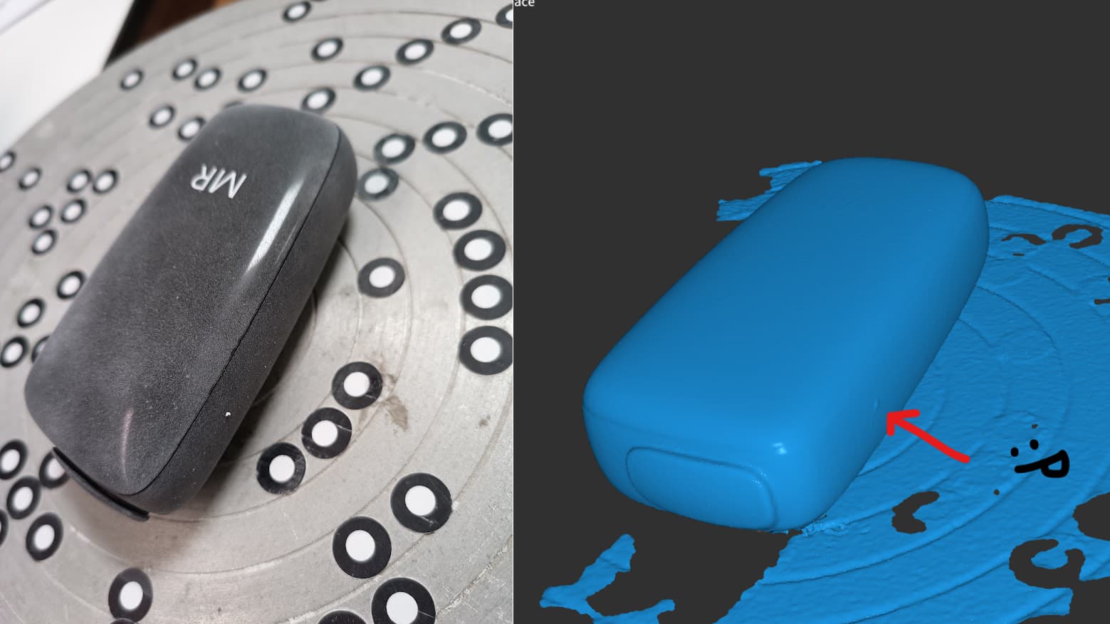

Can scan!
Cleanup and remesh outside RS5 andl texture inside RS5.
RS5 has to be capturing snapshots of the frames and these shots must be referenced to the fram point align, somewhat like what happens on Reality Capture or Meshroom. Most likely there is a “camera” shot that the software can access but users cannot.
The trick is to mesh the model you want to use as texture, and overwrite that meshed model with the mesh you want to texture. as lond as the position is the same it will work great. If one however translates the matrix of the model this will be the result :stuck_out_tongue:

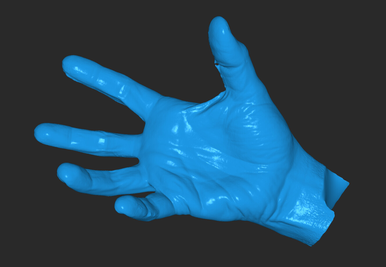

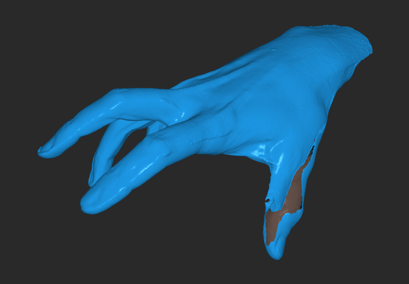

Gerard’s Hand
POP3 quick and dirty scan, holes and thumb misregistration fixed in meshmixer
gerards_hand
Matcap only sketchfab model - downloadable :wink:
The quick and dirty (before fixing in meshmixer)
Pretty much only fixed the thumb
Video from the scanner POV (RGB captured frames)
I presume that the misregistration happened between the frames that the “video” goes erratic.
Resin Print
Want to buy the POP3?
Great job !

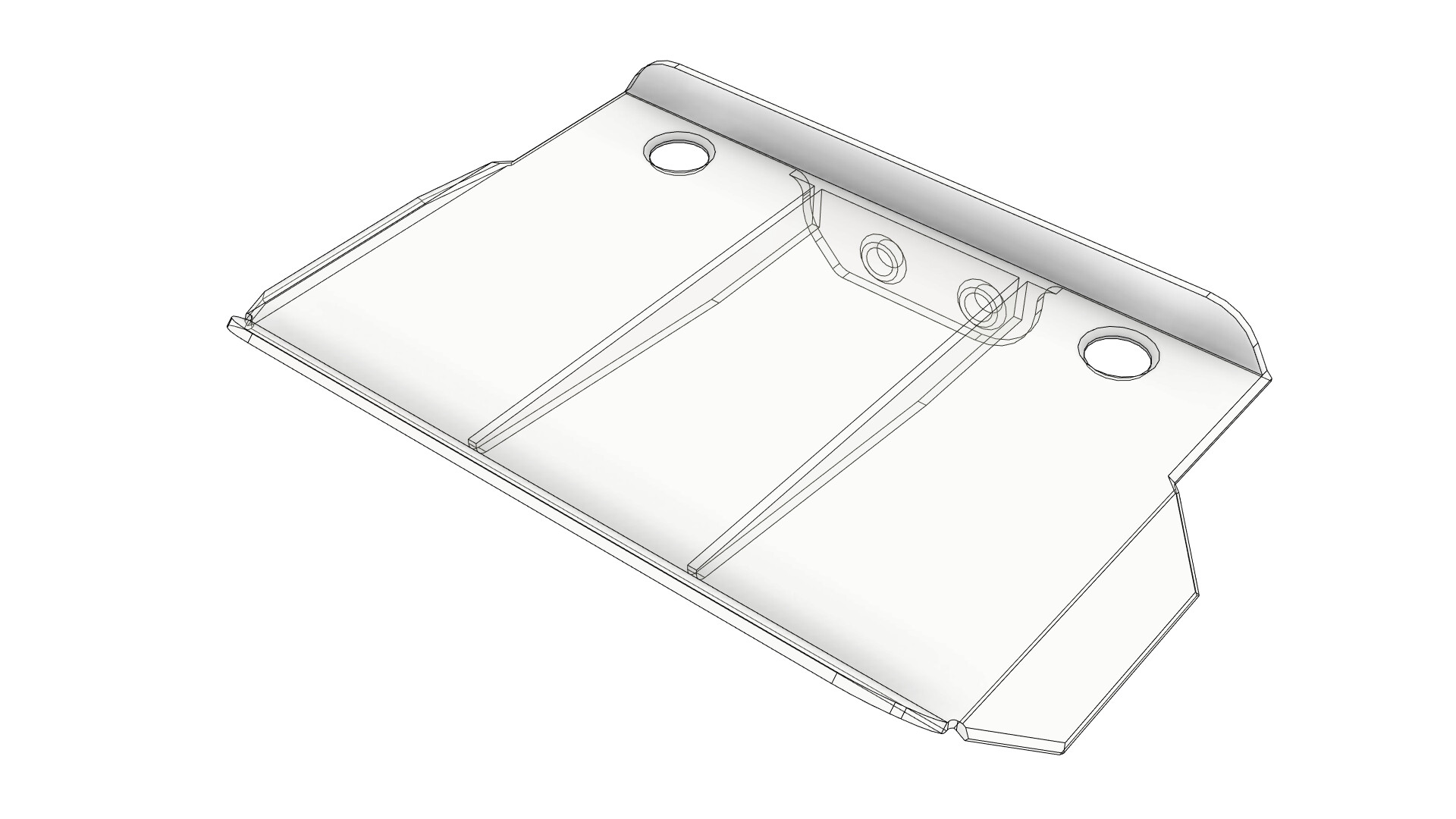

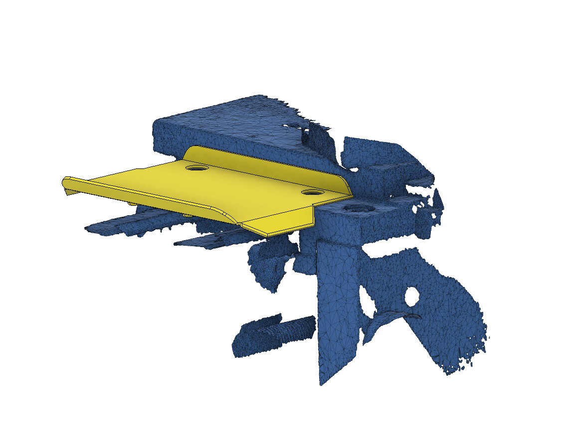

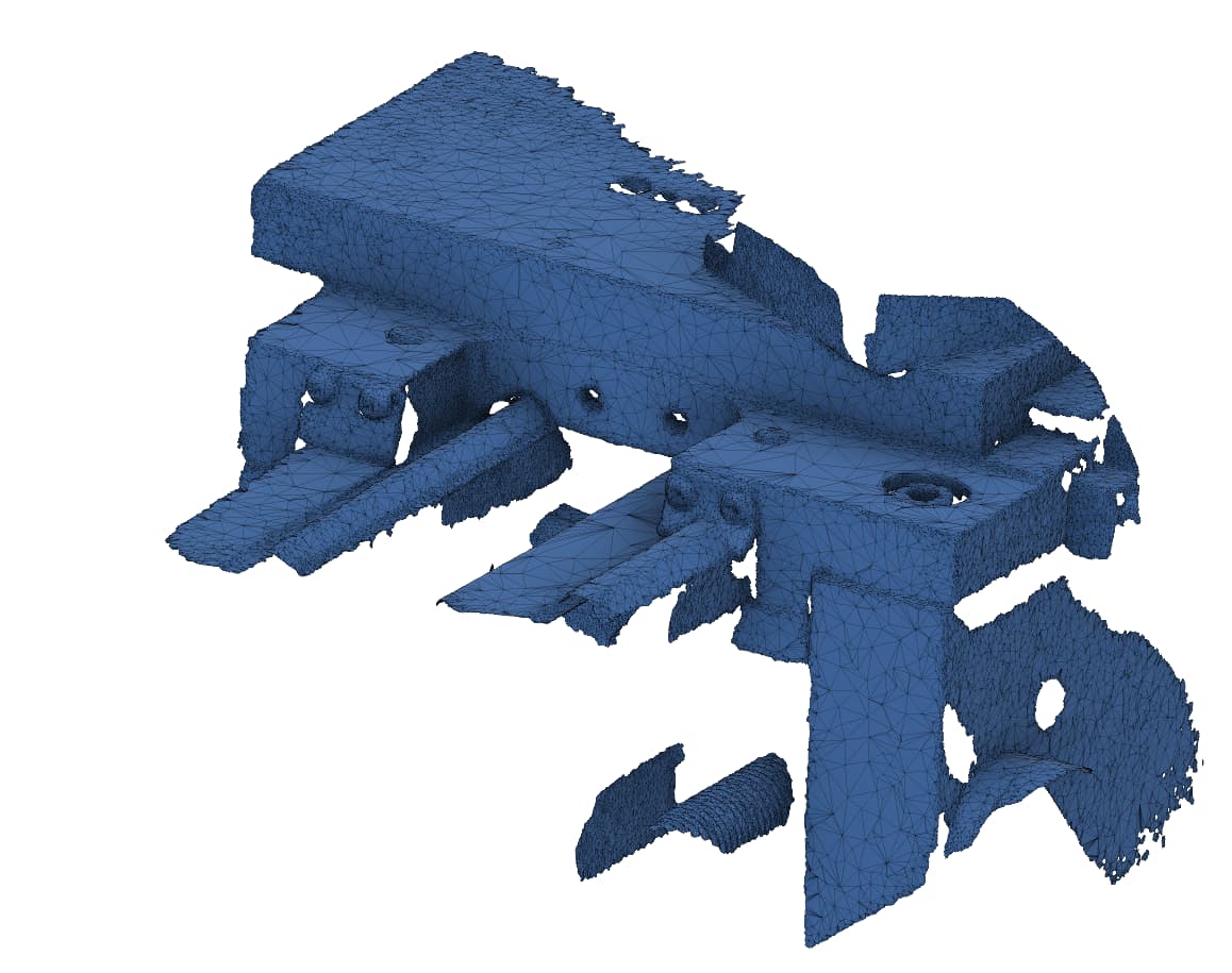

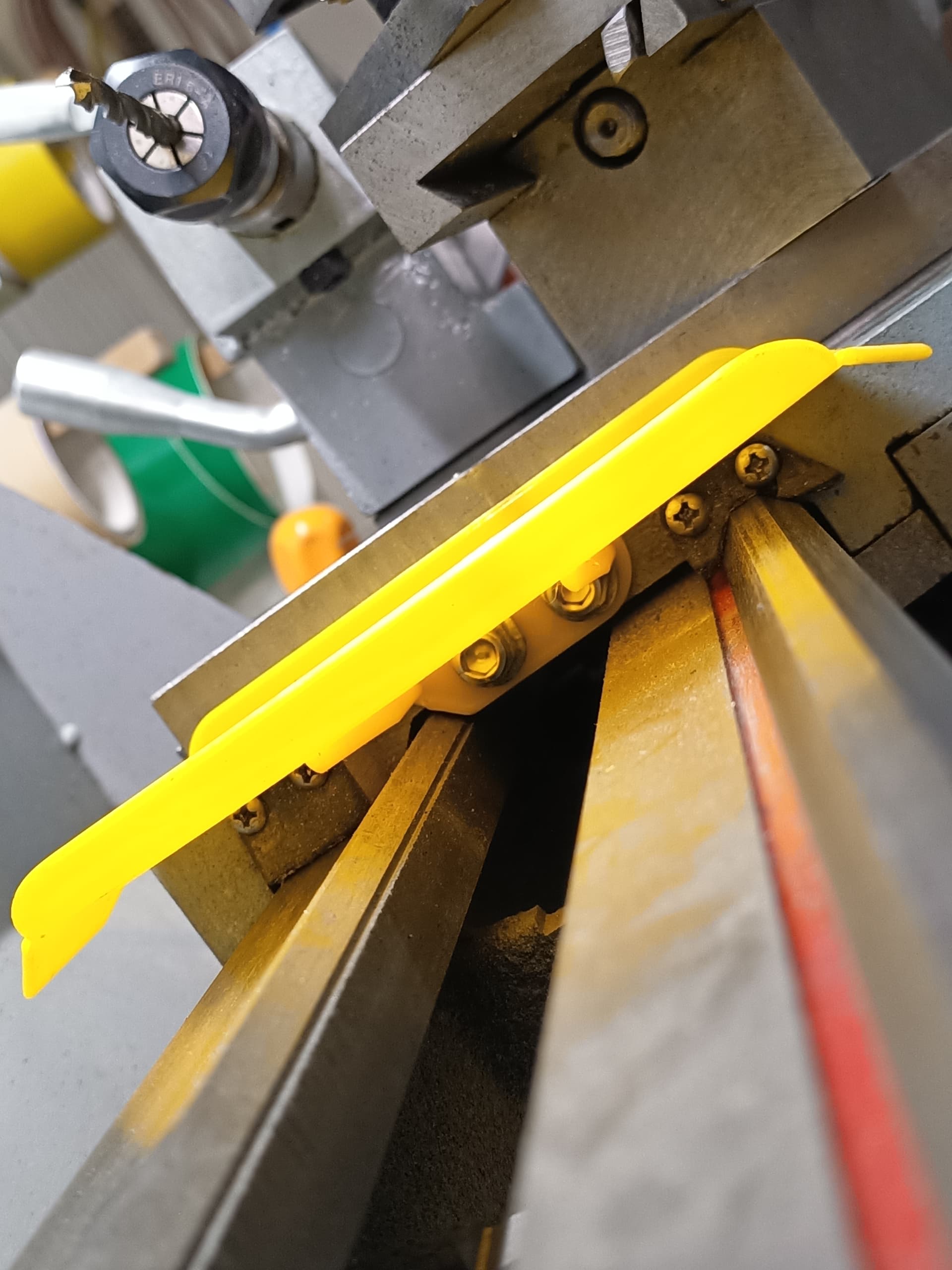

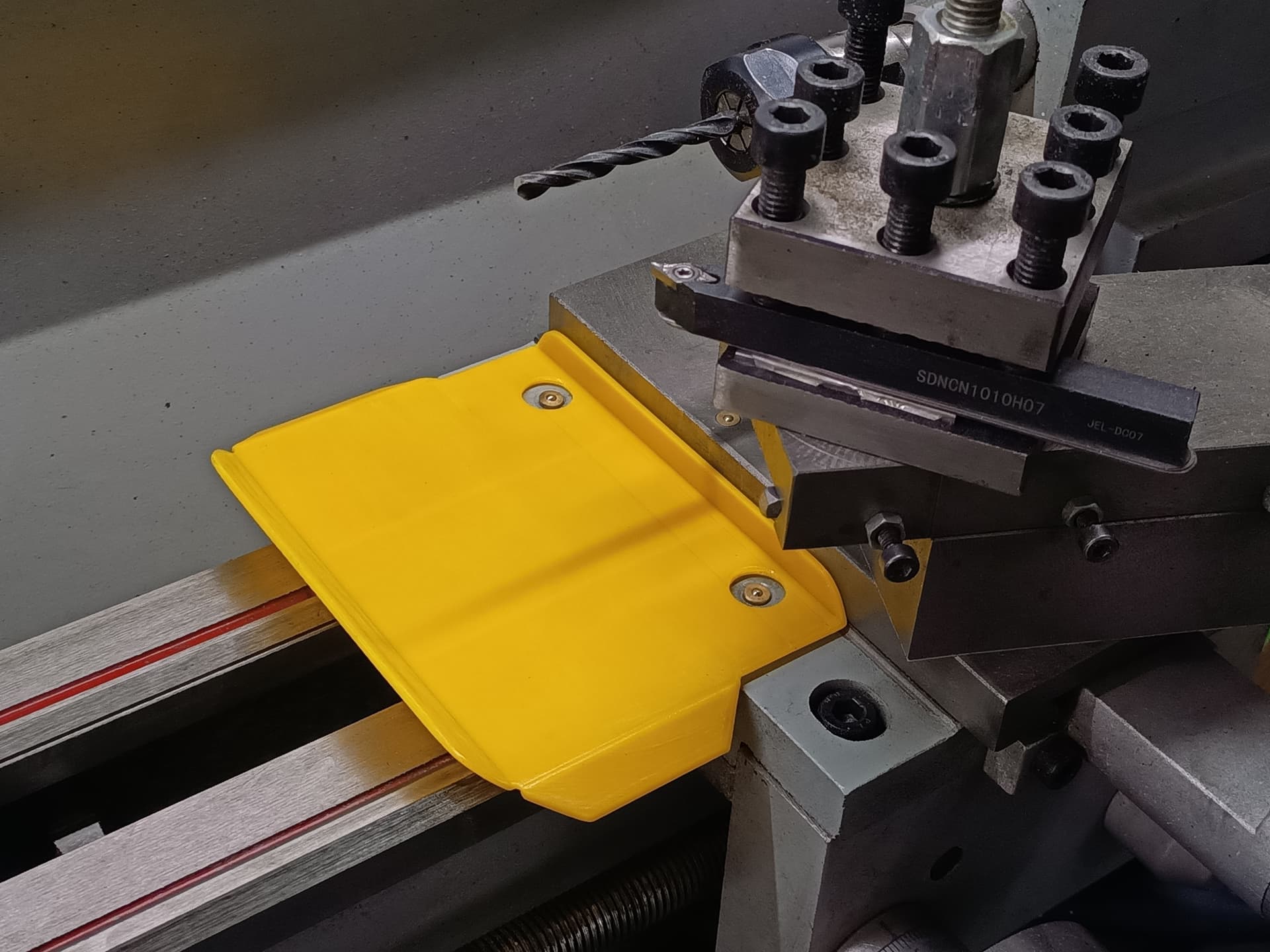

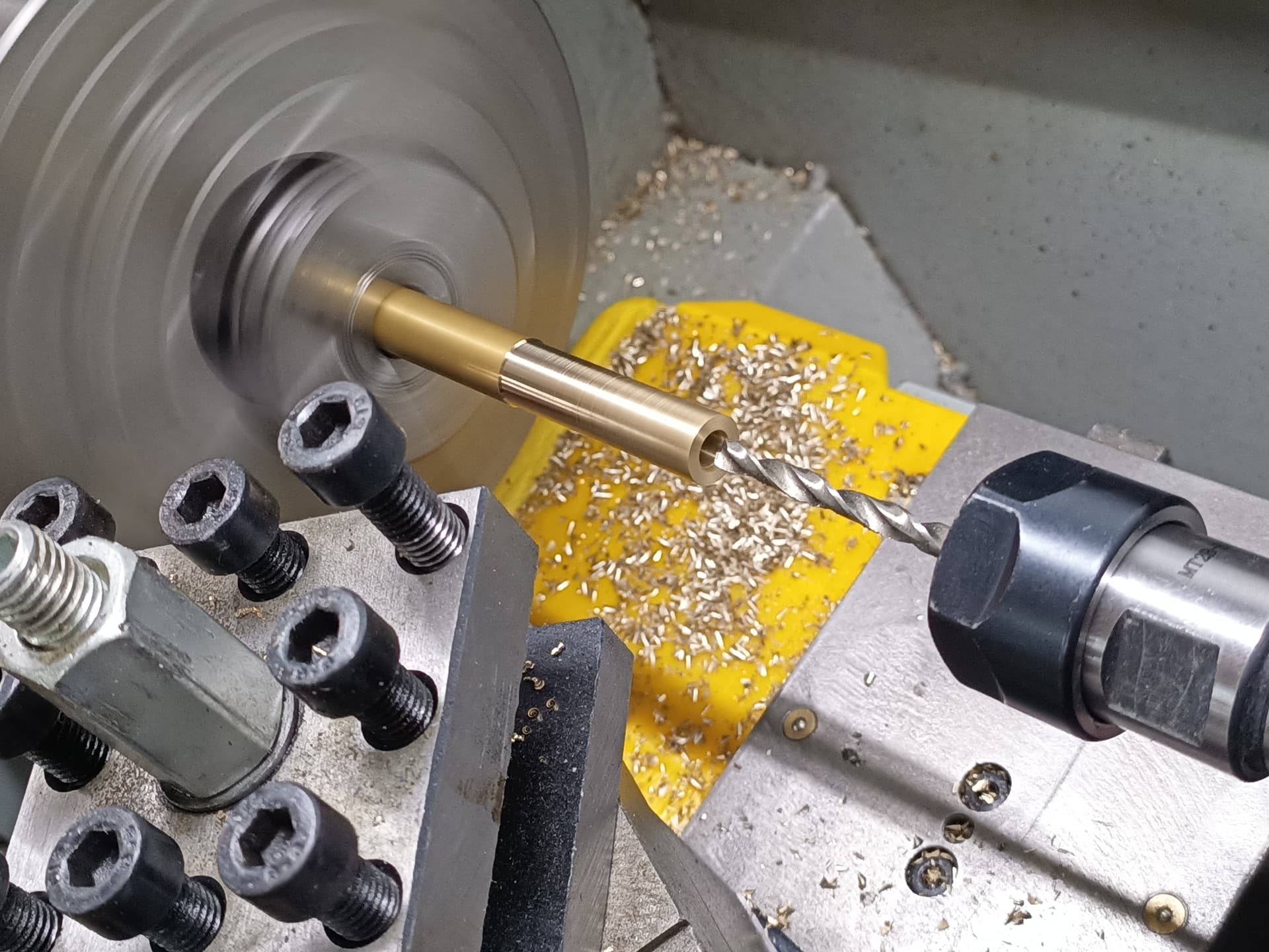

Vevor minilathe mx210 printable swarf tray
Used Pop3 to scan and reference volumetric dimensions to design a 3D printable swarf tray that can be printed flat to plate without supports
The capture
Building the mesh
CAD design
CAD model and source files

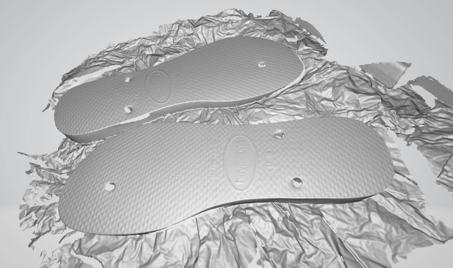

Havaianas scan for JIG
Scan of a couple of “havaianas” to extract the outline for cutting a acrylic jig for printing.
Scan was done using the crumpled paper method to add features for easy scan tracking
Here is the downloadable model
Pop3 capture frames animation
Here is the capture frames as a video, video was made with a new tool i have developed for this pourpose that take the cached frame images (when capturing with texture) and generates a player that one can scrub and analize and also export to a video.
This one is still in alpha but it is a (MVP) and should work fine with any system. As always executable single file is available for download for windows only… other systems must use the python script :wink:
Final work (JIG - perfect fit)

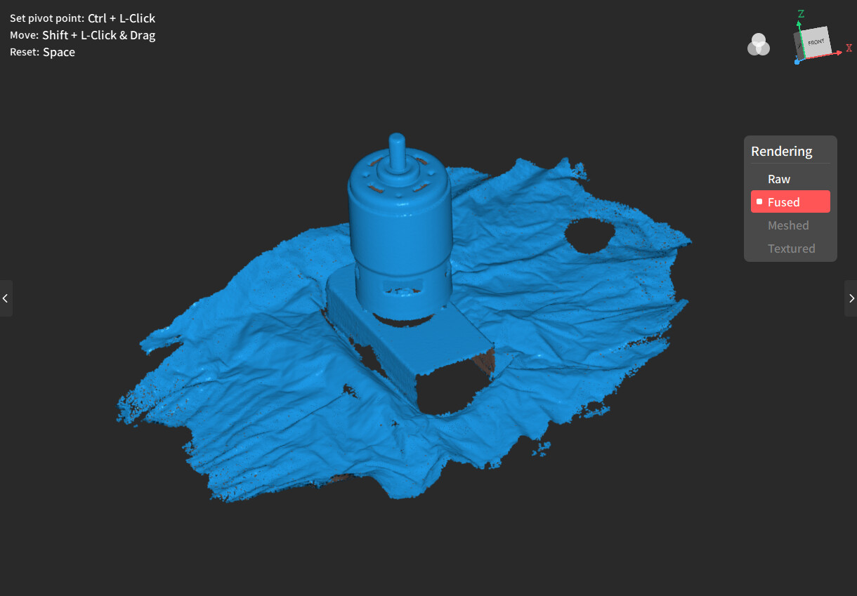

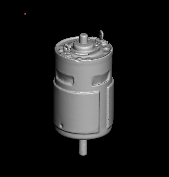

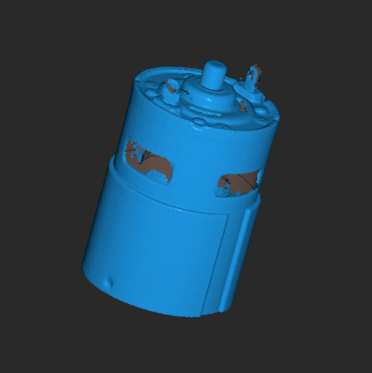

Vevor CNC 3018 Motor
Revopoint Pop3 scan of a VEVOR cnc machine motor for reverse engineering reference
Scanned and fused an meshed with Revostudio, oriented and merged with cloudocompare, minor parting line cleanup in meshmixer

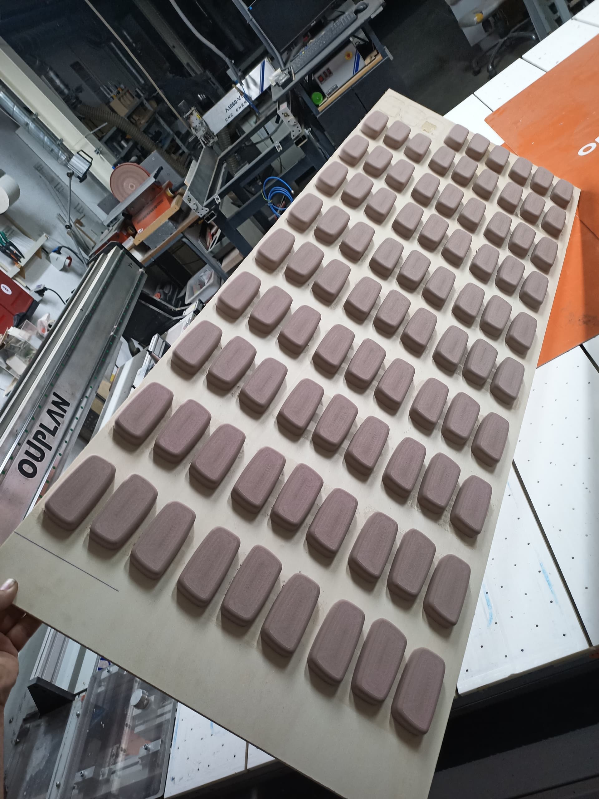

Tile mold rework
Case studie: using revopoint Pop3 to acelerate and improve CNC mold remachining ease and precision - Pop3 was used to quickly scan the model already aligned and fixed to the CNC table - Model was then decimated in PrusaSlicer for use with fusion 360 - Referecended and aligned to planes - Used as stock to for the CAM software - CAM programed and simuated over the stock part and mold was remachined
Worktable
Scan
3D Model / Decimated
New tile model to pattern
Stock referenced and new negative model added
Fusion360 CAM paths
CNC remachining
Final product
