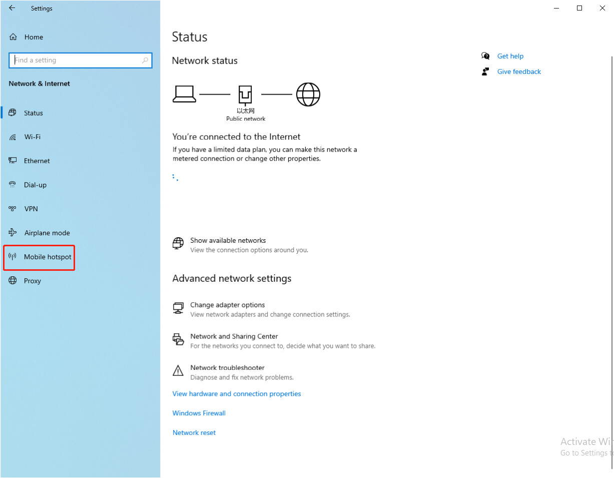

Click “Setting” on your computer;
Click " Network & Internet";
Click “Mobile hotspot”;

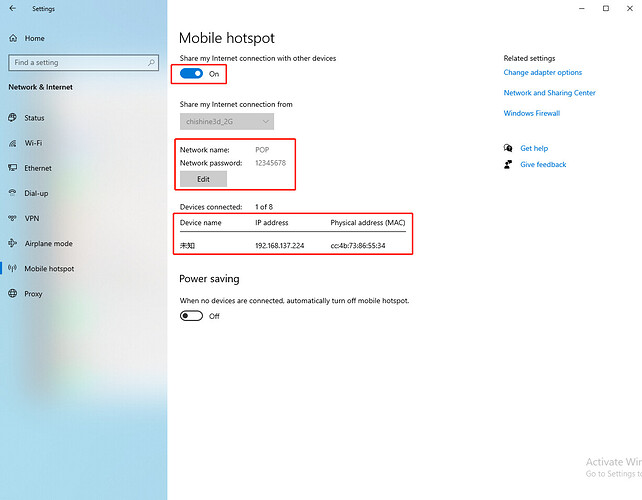

Turn on the “Share my internet connection with other devices”, and edit the network name as “POP” and password as “12345678”; (if you had revised the default name and password, then set it according to the revised one)
Open “Handy Scan” and wait for a while.
