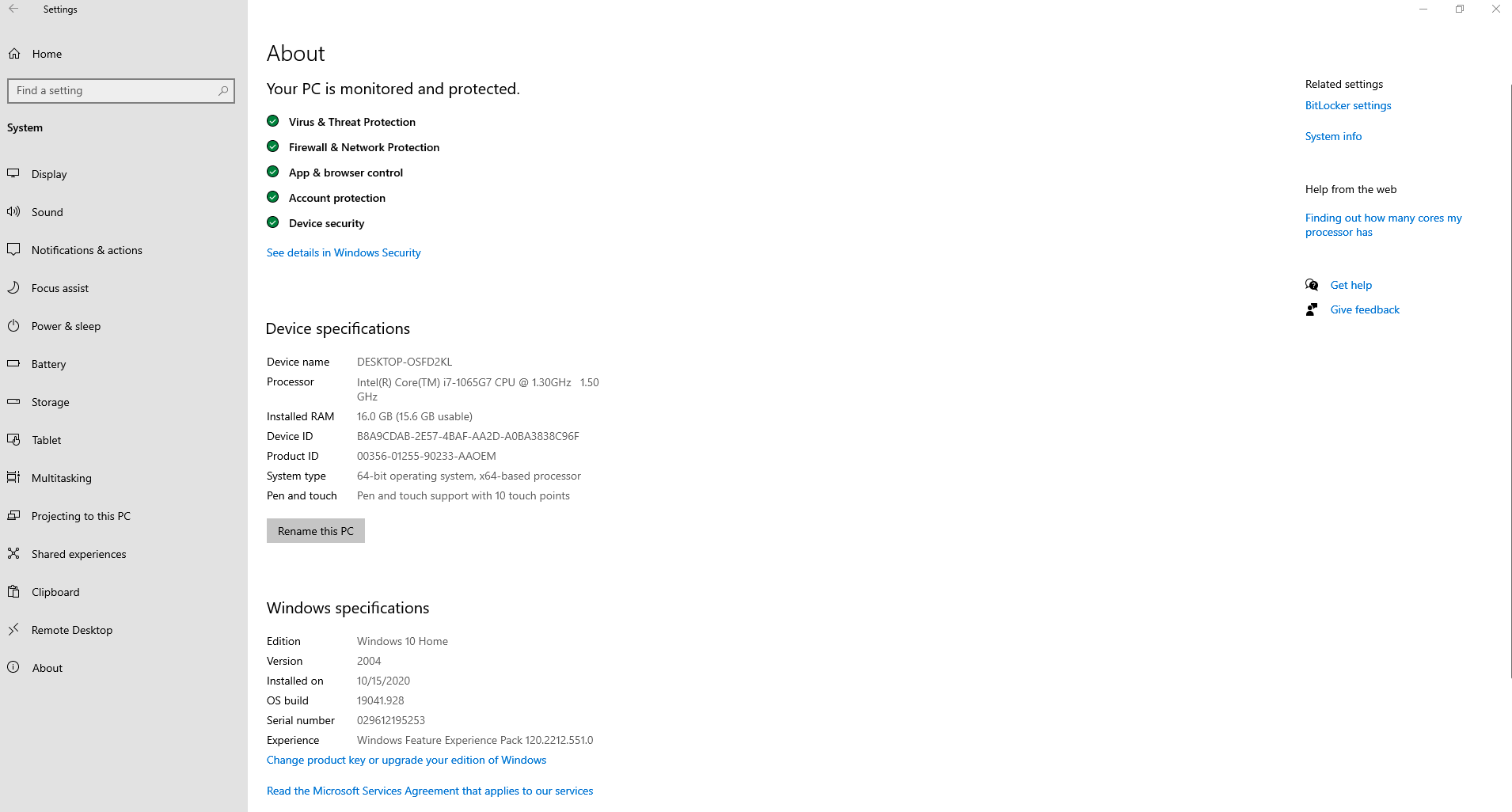

Could you please provide us the spec of the two computers you tested? We try to find a similar one and test it. (Below is the screenshot for your reference)
