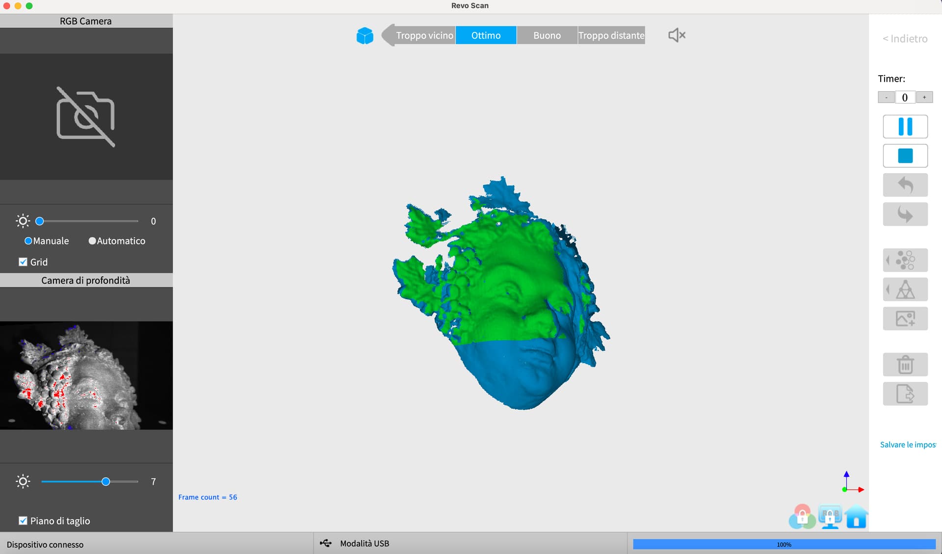

And, “Last but not least”, a 3D scanning of a small (12 cm) beautiful Bacchus bronze head:
The small bronze sculpture has a richly patterned surface, with fine details. The surface was coated with a thin layer of a 3D scan spray (aesub). It is a product that leaves the surface intact, and it is not necessary to remove mechanically, but vanishing after a few hours.
Editing in RevoStudio for point cloud “cleaning”
And after meshing, the final result:
