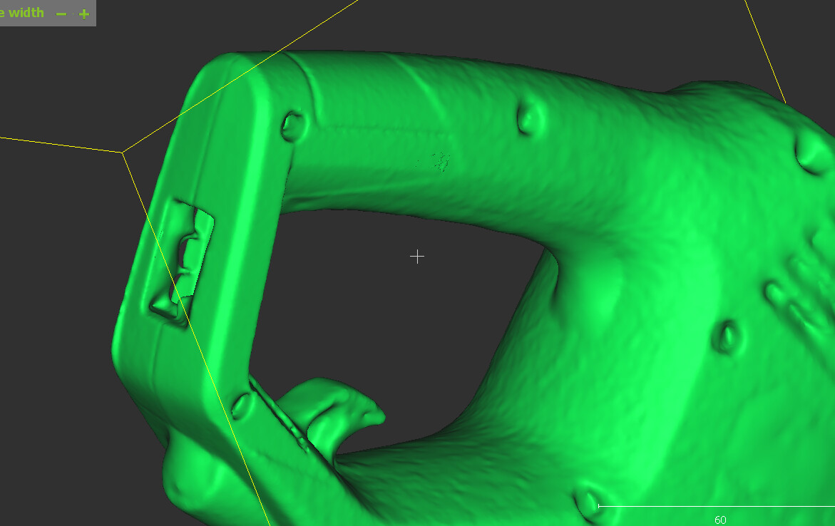

Setup
Fusion 0.02
Meshing 6.0 no cleaning
1x F20 C0.5
