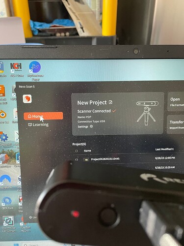

Just a couple of photos to let you see when connected to the software might make it easier to diagnose
Mike
This one showing green light
Thanks Mike , I will move the issue to the Customer Service so they can check it out , I donated my own POP1 so can’t confirm if the light changes to red after connection to RS5.1.0 , we have to wait for the office to open in next 12 hours to find out why .
