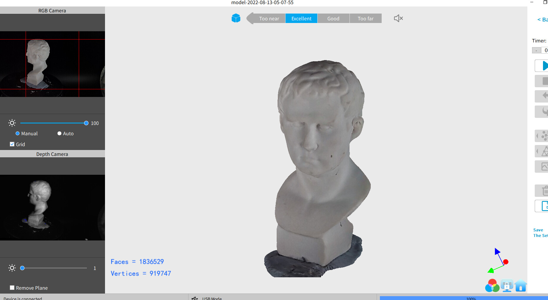

The textures definitely improved , also I see less usage in RAM and faster processing , fusing takes just couple of second , also texturing time improved rapidly.
I also noticed the model size is reduced in the last Software build.
before update of the software, last firmware POP2
After Software update POP2 last firmware
Works great with old and latest firmware devices .
The RAM while meshing never reached 4GB , while fusing and texturing never reached 2GB
Very good improvements on the win10 version !
