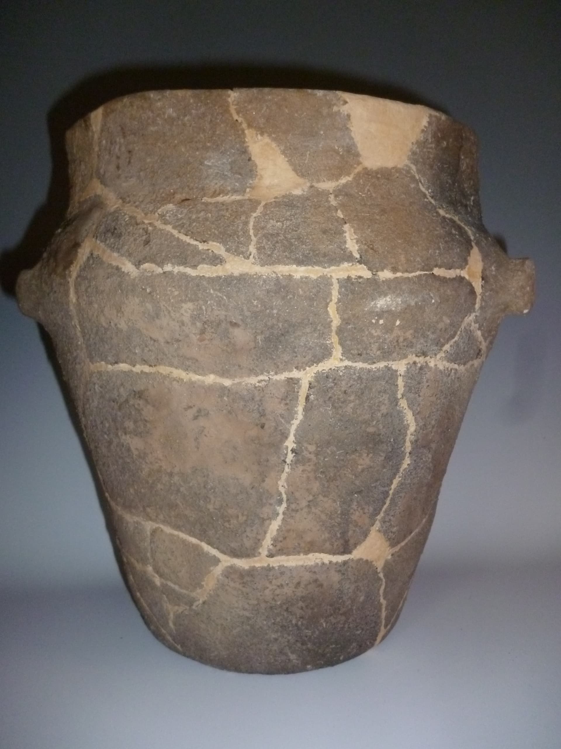

Smaller vessels up to 20 cm in height were good to scan with metrox:
But there must be a bug in the newer software versions: with bigger vessels MetroX lost tracking very often in auto TT mode - without frames getting red. The surface of this pots is hand made and rich of features, so this can’t be the reason. I noticed it got better the more distance differenes were to be seen, e.g. the back and the front part of the rim in the FOV.
See this, there is only ONE knob on the real vessel:

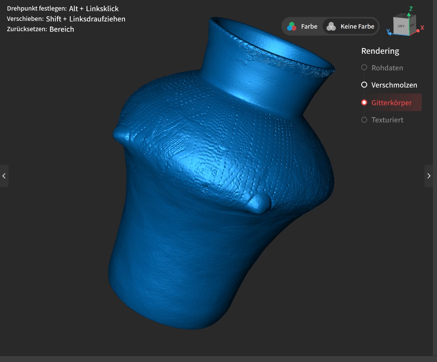

With Miraco I scanned in continuous mode because I didn’t find the single shot button in the PC version of the software and so I got huge amounts of noisy data which didn’t satisfy me very well. It took very much time to process, even with i9 and 64gb ram.
This is about 70 cm in height. Overall it is good, but the incised decoration is whashed out, because I had to do it in far mode:
This is better, about 50 cm, but see the rim: merging went wrong…
I had only 7 hours to scan 8 vessels, so it was a race against time…
Thanks for sharing your results. A shame that there were problems, but I know only too well the pressure of having to scan many objects in very little (not enough) time. Maybe the laser modes of MetroX along with markers and unique objects around the base might be useful next time?
Did you try photogrammetry as a fallback?
