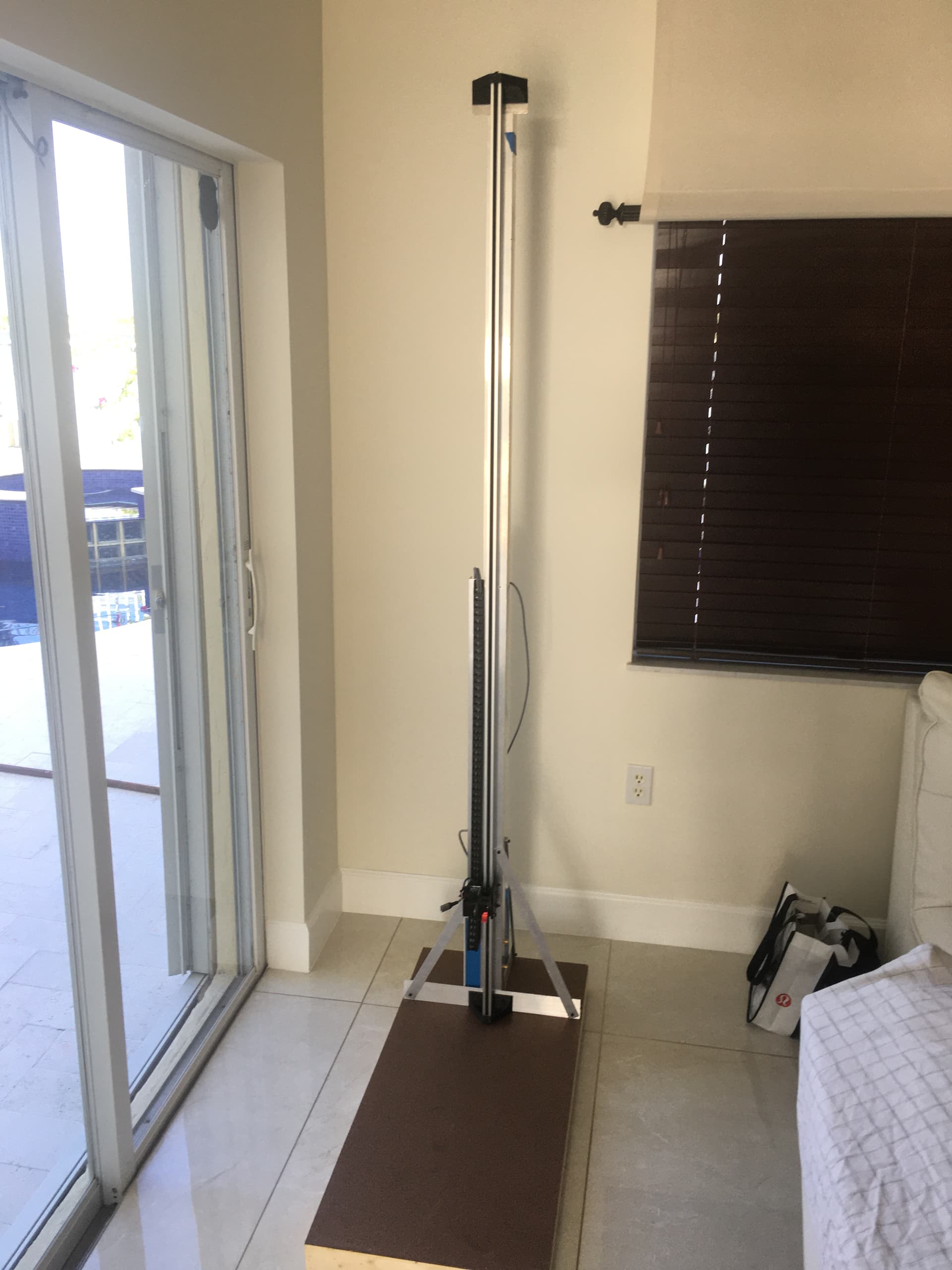

Here is my build so far, CNCjs works fine.
great installation, it’s nice to see POPers using what we do
