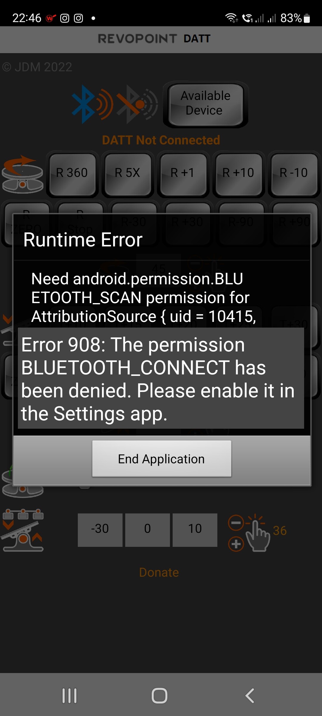

@Johnathan next test. Result the samen. Old version deinstalled. New installt and started
I also get the same error on my Samsung S21 ultra on android 12.

Ok i had testet
Edit: App rights for units in range i had activated manual in app after installation, but no change by error message.
Ok then it will have to wait until I can get an updated library for BLE as I have tried all the options to manually get round it in this version, the current BLE library does not support Android 12
For now Android 12 & above are not supposed

Ok it connects and i think it works now. Congratulations. ![]()
cool thanks, simple mistake made a difference to 12 and above only, bellow still worked lol, now it detects the version it’s using two different bits of code to connect the Bluetooth
