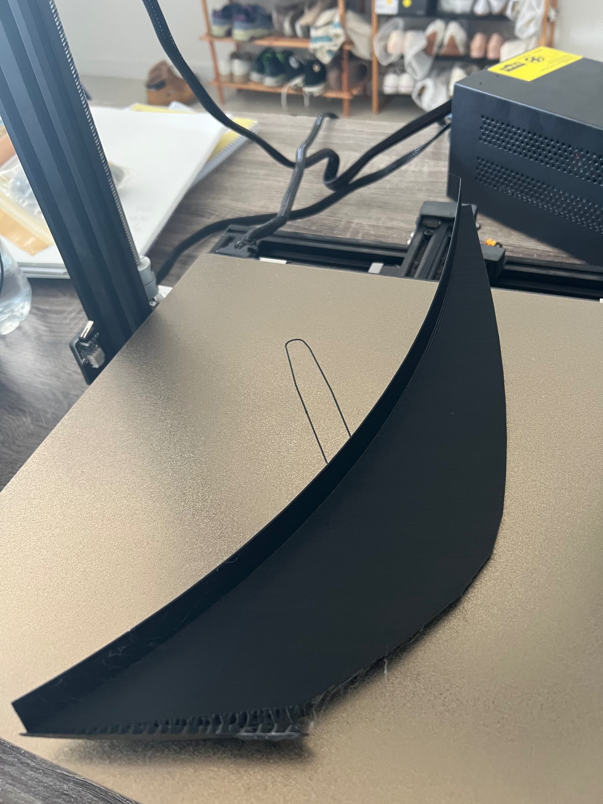

furthermore, tips for success to scan a car, believe or not, , it would have the incredible result, if you dont wash your car for 1month before scan😂
blackfront lip is scanable without marker, no 3d scan spray and stablizer/ low light environment. of coz headlight and fog light cannot be catch up obviously.
dark purple color also caught up with dark mode, RGB wasnt great in Range scanner, but i wont care about the color model
scanning the Mirca (car above) (low light indoor garage, because Range doesnt like sunlight), feature mode, without stabliazer, bumper curve is highly accurate, mesh imported into blender for boolean parts, it’s touch the surface perfectly
