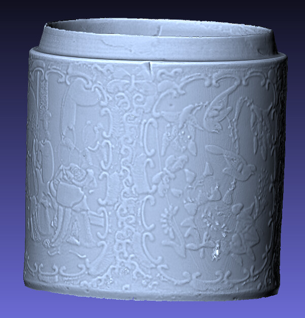

Let me show you the result of a not at all simple scan, an ancient polychrome vase. With MetroX I was able to acquire the entire object with a truly amazing surface quality (look at the snapshots of the object without the color texture) and also the very rich polychrome decoration.
Ancient Chinese Canton-style vase (10 cm high)
Another smooth scan with color
Scanning mode: Auto Turntable - color
All automatic scan with only 72 frames with MetroX

The vase’s fine surface morpholgy in Meshlab
The thin layer of the decoration paint is perfectly recorded by the 3D scan
