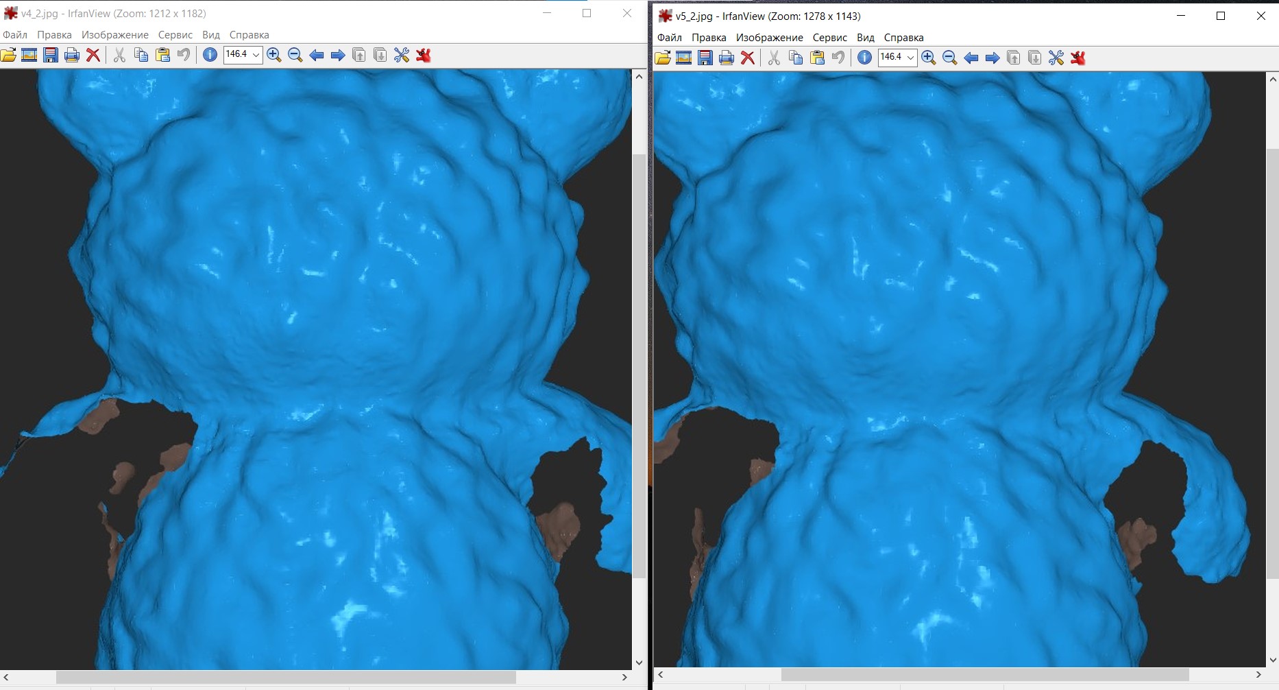

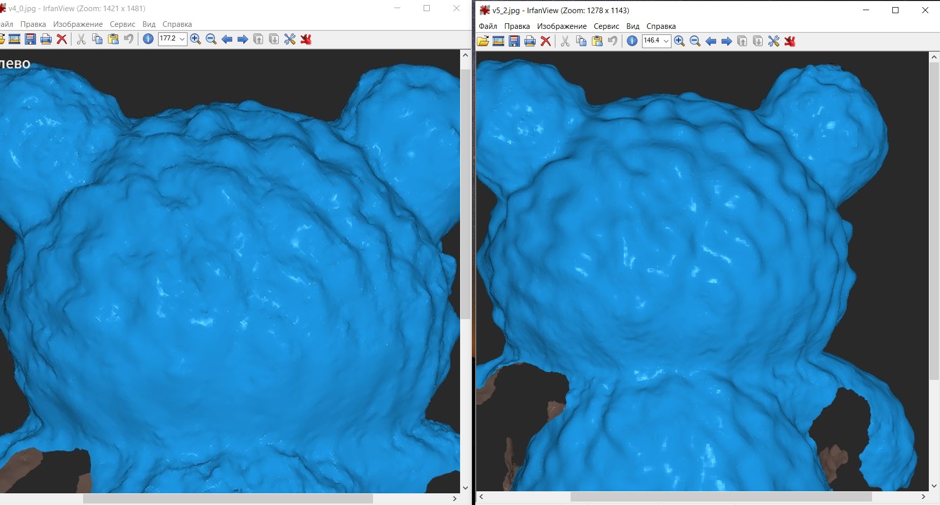

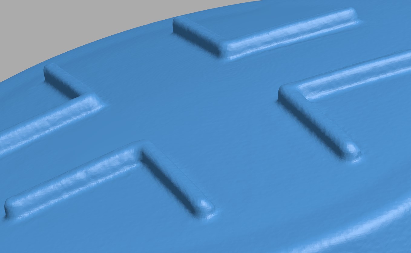

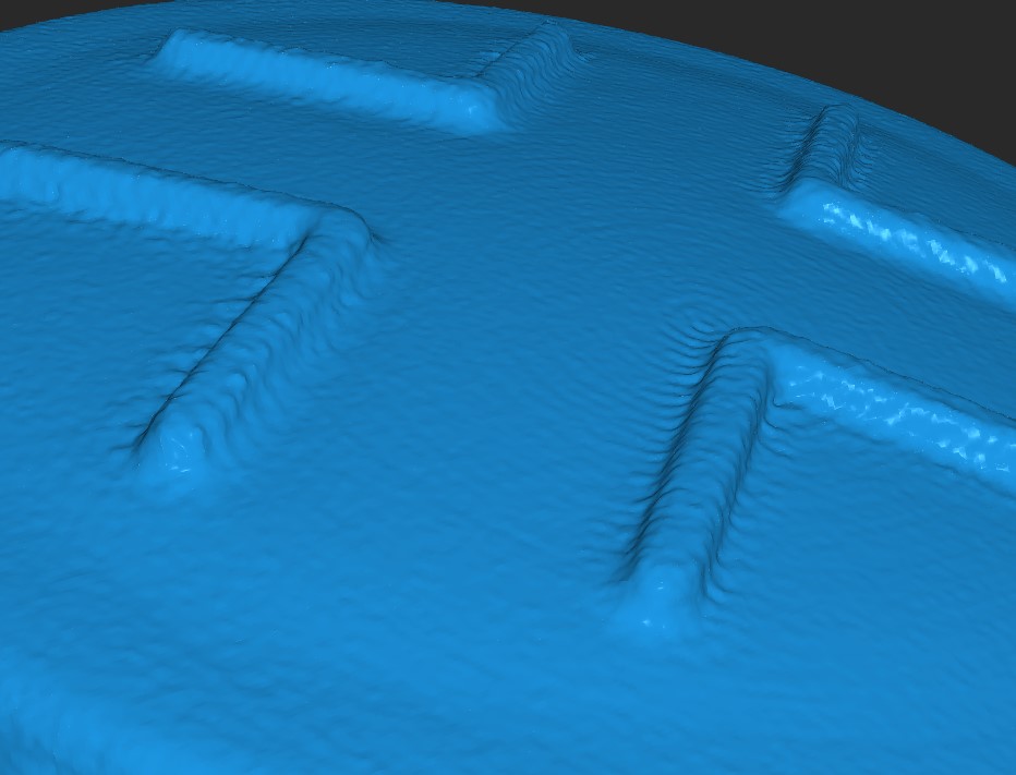

I want to show the results of comparing the performance of version 4.x and version 5.x
I tried to do minimal cloud cleaning and the same camera settings.
As I said, I am new to 3D scanning but have over 20 years of programming and engineering experience.
I can evaluate the result.
I understand that such parts are not suitable for the Range scanner, but at the same time it can scan them and get a different result under the same conditions
