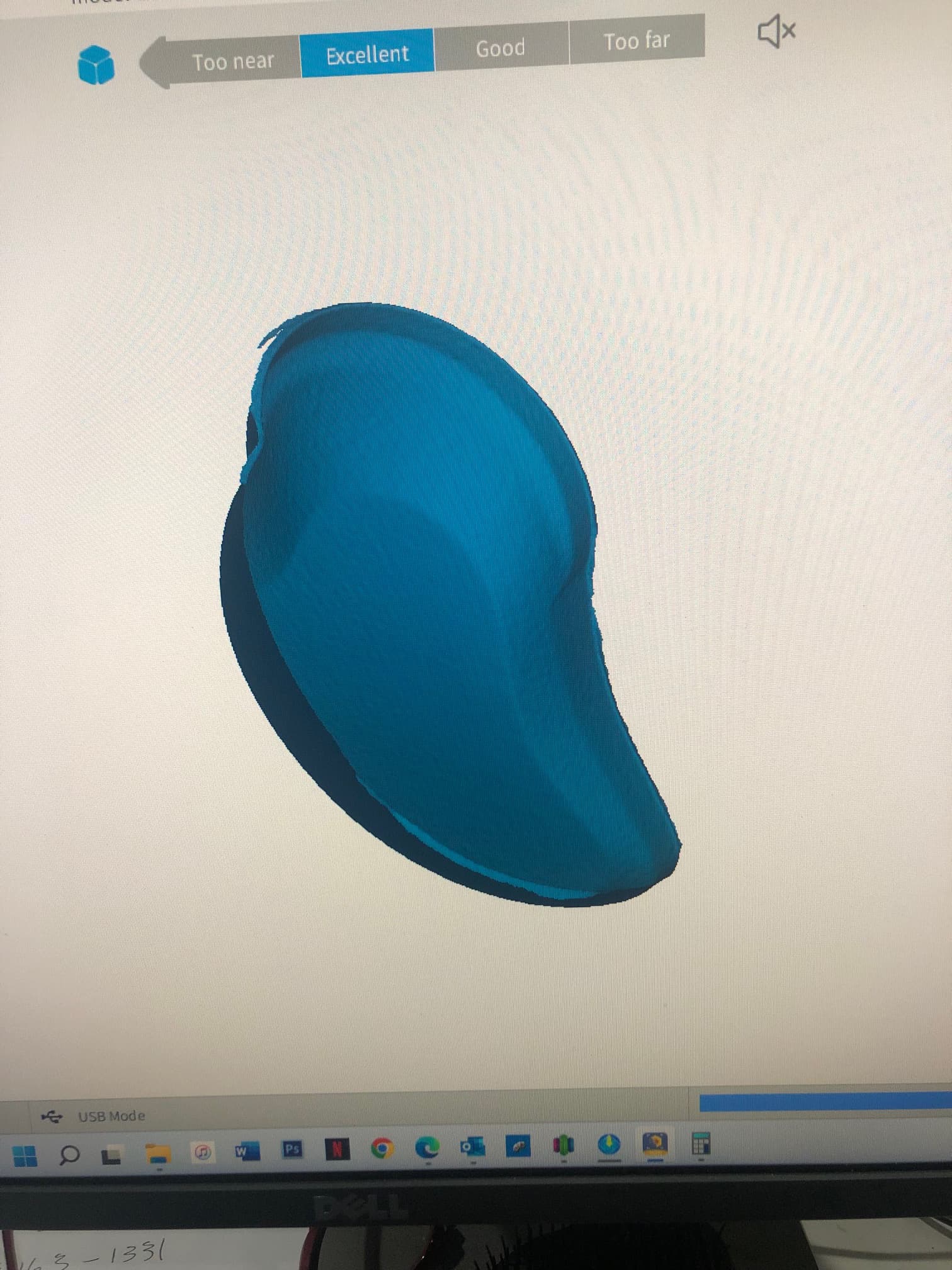

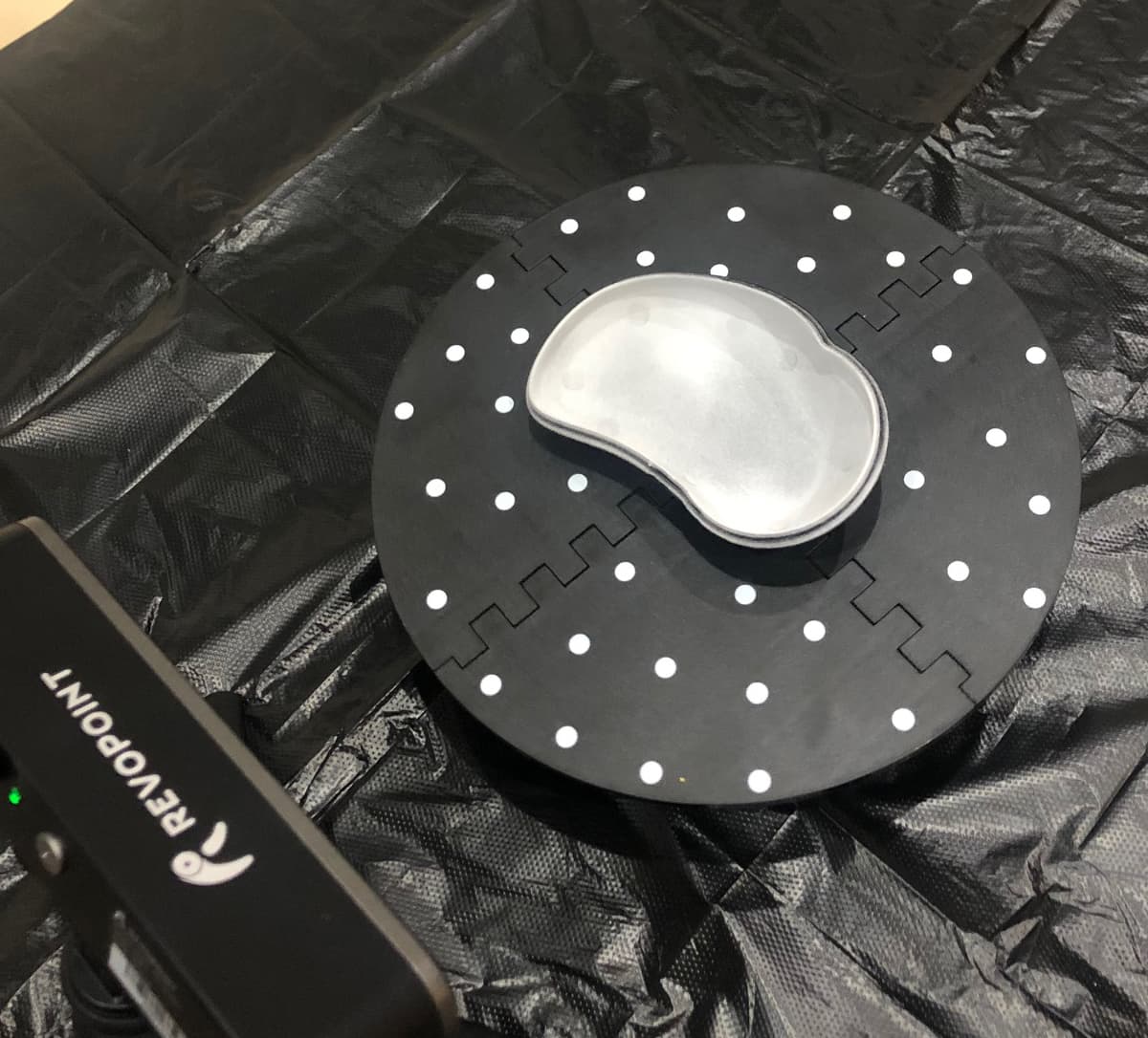

Results continue to amaze me. I recently had a difficult job - scanning a glossy black object. I had some difficulty until I used a scanning spray (AESUB Blue). Results using the spray are fantastic!
The other thing I did was an accuracy test and achieved a result of 0.14mm. Which is more then needed for my tasks.

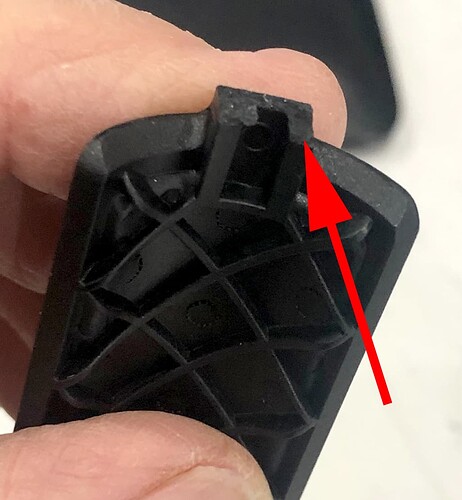

My only complaint remains the tripod. In the past I have been critical of this part and considered it poor quality. I can now revise that view and consider it absolute rubbish! One of the legs broke off simply pushing the extension downwards! The hinge part of the legs is very weak (see photos). I fully understand the concept that Revopoint want to achieve (quick connect and up/down motion) but this part simply lets the complete package down. Everything else is SO GOOD…. The scanner itself, the turn table and the carry case etc.
I hope this is addressed in the future and a more robust tripod supplied.

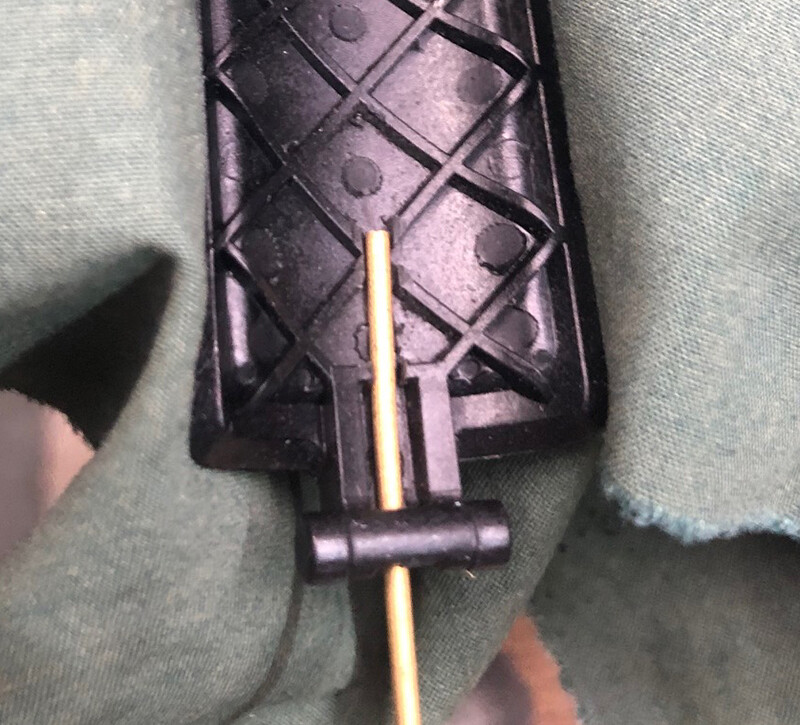

Re Tripod Repair:
There is a simple mod/repair job that I have now done to avoid this tripod going to landfill….
The photos explain the repair and strengthening of the parts.

I agree on the poor quality of the tripod that comes with POP2. With mine, the three screws that hold the hinges of the legs just broke out at day four. The tripod that came with POP(1) seems to have been better, but unfortunately they aren’t interchangable without some disassembling und reassembling.
