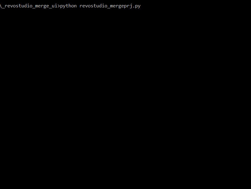

Just created this basic project merger app to allow me to merge multiple projects into a single project. I found i have this need specially when using mobile captures, it creates a new project instead of a new scan like in the desktop app.
revostudio_file_merger
This would ideally be done natively inside the software but for now it solves this issue.
One can merge the project files manually by copying the data folder into the merge project and editing the .revo file with notepad++ copying the blocks for the childs that give the program the reference of the files to load in the scanline
project is in my github, should work on all platforms, requiring only python to be installed with no other dependencies.
if there is interest i can build a self contained exec
utable for windows/mac
