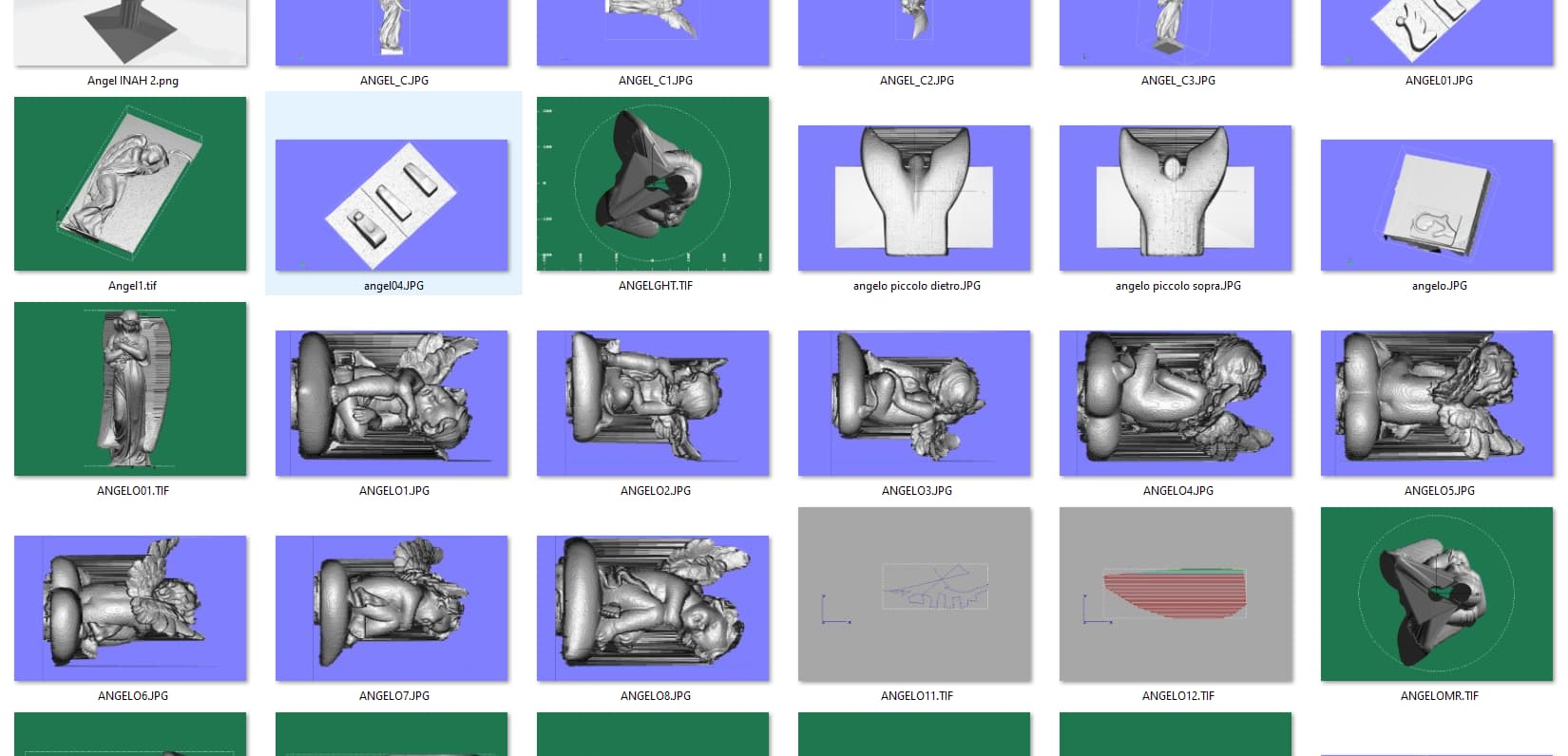

here an example I have put all the image of my scan into one directory so I can find the name and have a list of all the scan to remember how I have…
I looking a way to catalog all that… and all the new scan made with revo…
thaks for all help you can give me…
