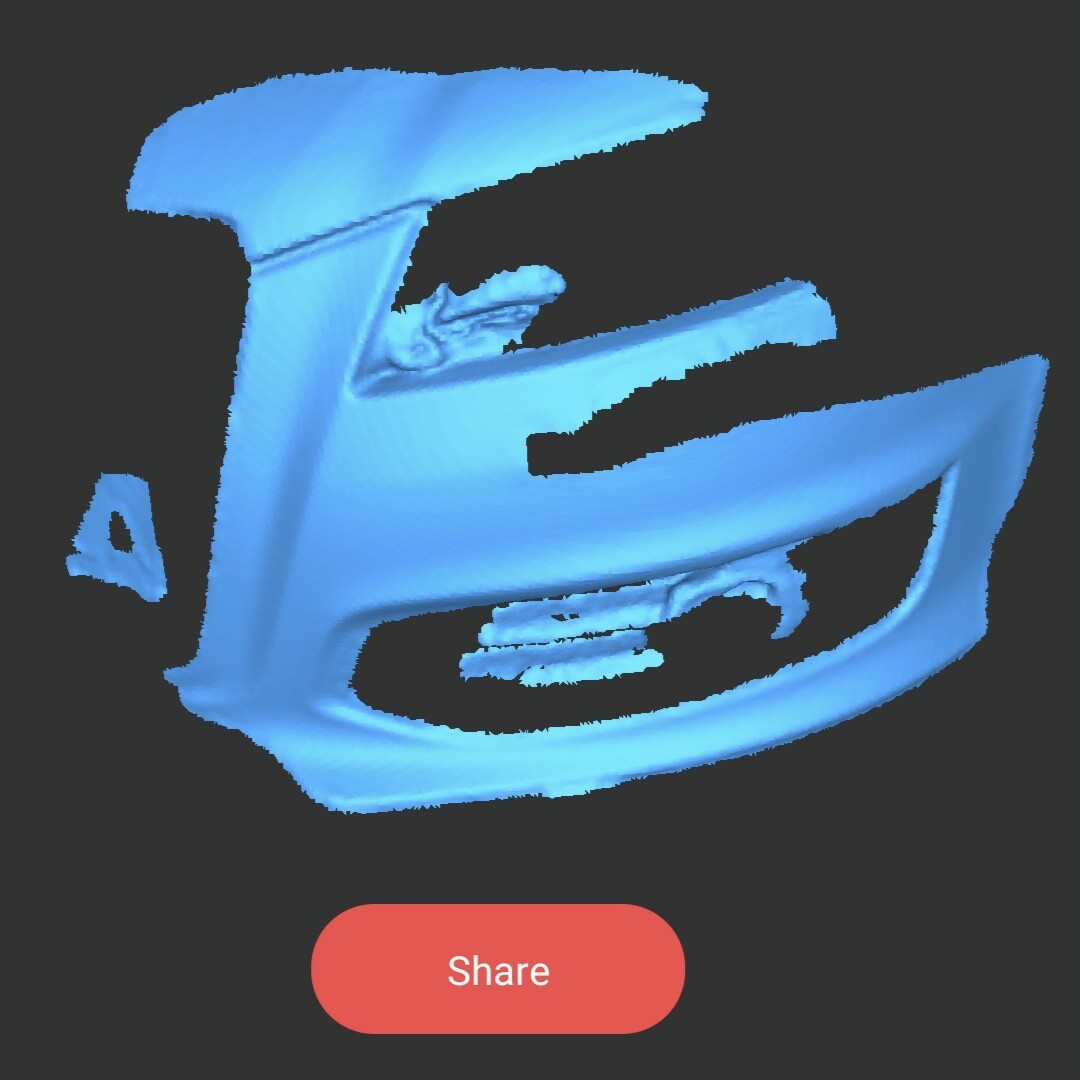

Here’s a quick test from today.
No markers. No spray. Just dusty/dirty car.
Single scans.
All done on the phone. Also post-processed on the phone.
