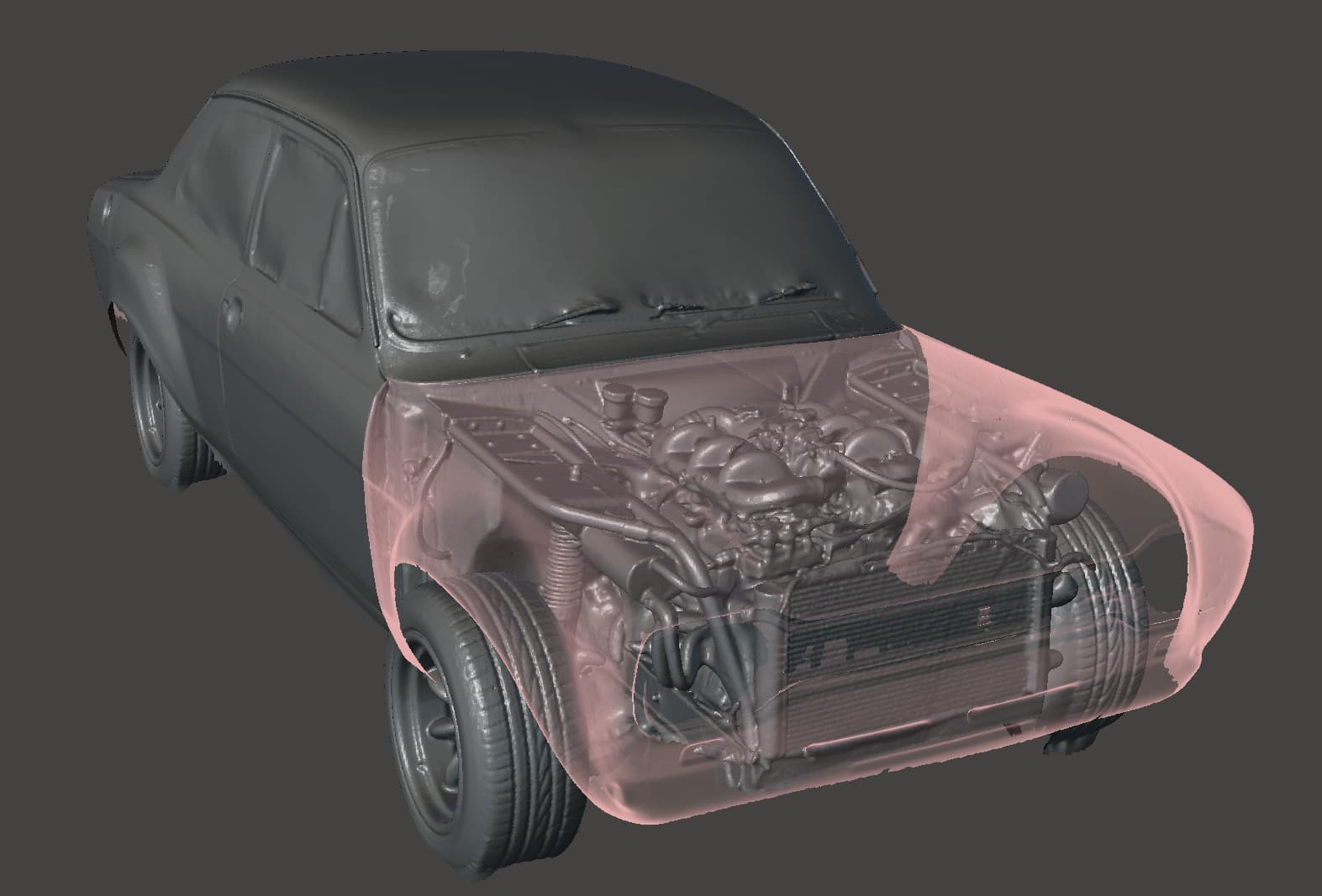

Just some more views of the Escort scans
the view through the front end is cool, its a fiberglass all in one part hinged at the front ![]()
underside scanned in feature mode,
custom rear suspension
Excellent work Johnathan!
Very Nice Johnathan.
soooo good! can’t wait to get mine what are the fuse/ mesh settings for this? and high accuracy scan right?
yes General mode high accuracy, fused at 0.1, meshing and alignment was in Cloud Compare meshed at 11, I did try at a few different settings but 11 was the best I think
What was the Fuse and Mesh time (and what is your system’s build description)?
I used an acer Switch 5 tablet PC with 8GB RAM i5 7th gen, meshing took a little while but I didn’t time it as was busy doing other jobs , i could mesh it again and time it, fusing was done in about 5 sections, engine bay, main body, rear floor, front floor and engine area, and rear wheel ( because the suspension moves on the lift ) fusing took approx 5-10 minutes each section again I didn’t sit and time it I just left it to it while I did other jobs in the workshop,
I do know that the engine bay scan meshed in Cloud Compare at 11 using 4.5GB RAM got 14 million triangles and took about 3 minutes on a higher spec desk top PC
Scans like this are going to take a little time and experience to get but the Range is more than capable of doing it and without a fancy computer but a high end PC will do the processing faster, the tablet pc is very convenient with the scanner attached to the top
