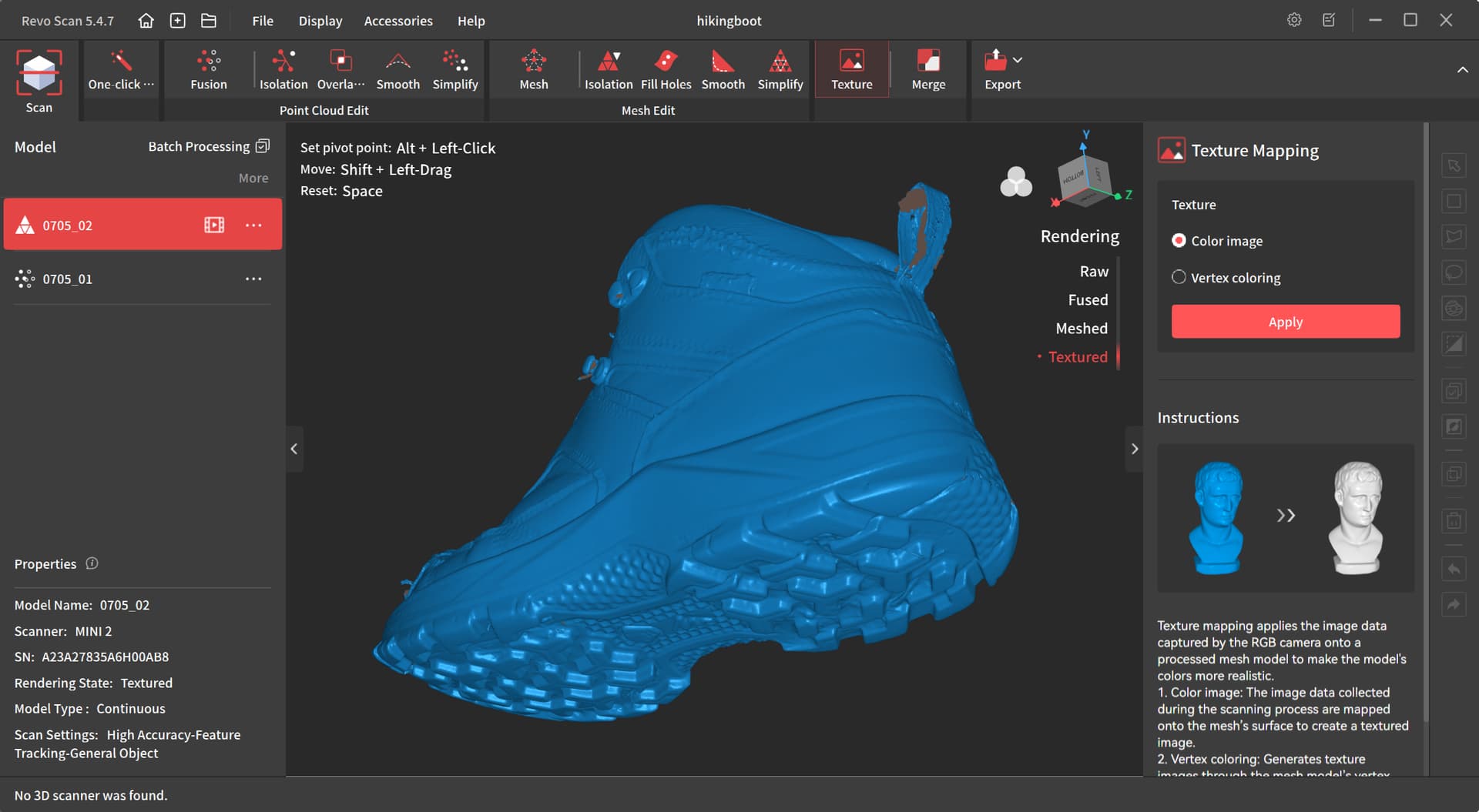

Meanwhile I did a test. I usually don’t do such things as clothing, but I wanted to see for myself. After all, the shoe is the benchy of 3D scanning.
I present you: My hiking shoe, with dogsh!t stuck to its treads.
As you can see, theres nothing special with the setup, no markers, just some dry shampoo was used. It is all about the method.
The scan was made with the mini2 in feature tracking mode.
You can see, there are no misaligned frames or noise. I promise I did nothing at all with the data, except for the isolation and overlap detection. This is not meant to be an examplary work, I did not do a thorough scan of every detail, just a quick one.
I do teach 3D scanning if you are interested :slight_smile:
Look, I brought a white shoe for you and when I scan it, I first scan the front and sides. Then I stop the scan and move it back a little, so I can scan the back side. Can you watch the video to see how the image shifts suddenly?
This is another example, but I don’t pay much attention to it because it doesn’t have much detail or I don’t have any preparation. But as you can see in this shoe video, I can’t even scan the lower part, because the image completely slides until the scan is completed.
Well this shoe doesn’t have much distinct geomerty on it, only some surface details. So when you get to the heel part, that is basically a ball shape, misalignment happens.
The heart shaped thing is just mainly some paralell planar surfaces, theres nothing to track, but the center cylinder-like shape. The software behaves as expected, it will match that cylinder like shape and the planar surface, but not all degrees of freedom is locked down by this, so the data starts pinning out of control. I understand that you can see a heart shaped edge, but for the computer, it is not an edge, it is just an area that has data, next to another area where there isn’t any data.
Both of these cases would have required marker mode.
These principles I just described applies to all the 3D scanners in the world, given the same situation.
Believe me, all your problems stem from your lack of understanding of the technology. Give it some time, read up about it, practise, and you will have success!
I understand very well what you want to say, but you cannot understand me. For example, I still continue to scan that shoe with different methods and somehow I scanned the upper part. Now I will show you the problem again, please watch the video and explain to me how the software combines the sole and the side of the shoe, what does it match and combine them?
You may be right about the sides that are very similar to each other, but he just joined the sole and the sides of the shoe, so every time I scan it, it becomes nonsense in a different way. I also wait especially and start the scanning process again in the most obvious places. You can pay attention to this. I say the same thing again. Revopoint Mini 2 device works really well in terms of hardware, but Revoscan software cannot keep up with this device and ruins the whole scanning.
For the shoe, the scanner is pointed at the bottom of the shoe the majority of the time so you’re not fully utilizing the FOV available. It’s also a long object that gives you a wide variance of scanning distance as it rotates.
Similarly with the heart scan, the turn table is basically in the bottom left of the frame, and the rotation of the object is moving too much of it out of the FOV of the scanner.
For both of these, what do they look like after fusing and meshing? It seems you’re judging only the raw capture, and it’s rare that all those frames will align in the preview window.
