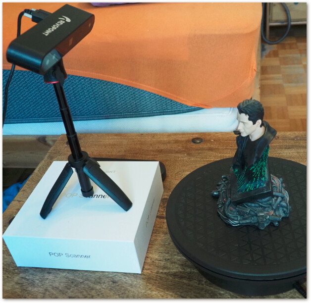

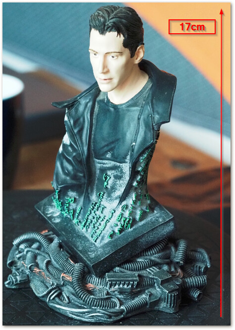

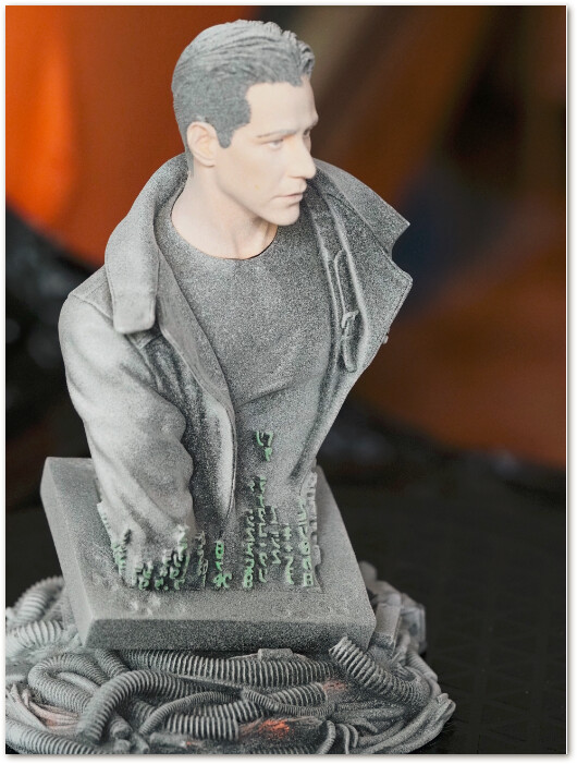

First, here is the model I used, a 17cm bust of Neo (from Matrix), without the sun glasses
I took all these indoor, with the same set-up, same time of the day, using the turntable (I also put a manual turntable on top of it in case I needed to adapt speed)

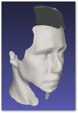

Feature Mode
There I had some issues capturing the whole head, it kept losing track, especially when it was behind the head as most was black

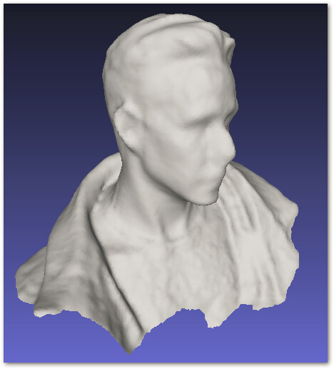

Face Mode
That was better, after some adjustments I could capture the whole head, not bad for an object of this size, but of course you can’t expect miracles
Dark Mode

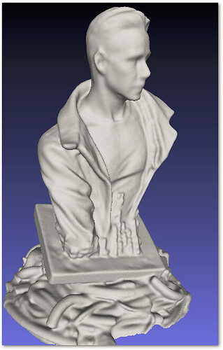

With that mode I could capture more of the bust, especially the dark parts, but it comes with a price, as you can see the resolution isn’t as good

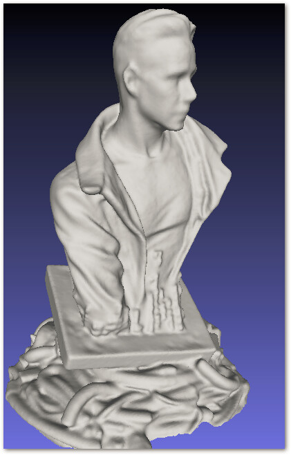

Scanning Spray - Face Mode
So I went on, face mode seemed to give the best results, so I gave the bust a shot of AESUB scanning spray (slight as you can see, that damn thing is expensive),
and I could seamlessly scan the whole bust, the result is not bad, giving the size of it, so yes, the scanner is quite capable, given the price range
