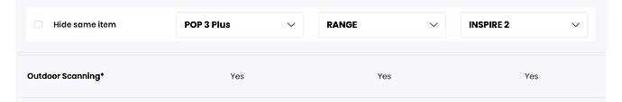

I have an original Range scanner, which for some reason the Revopoint comparison chart shows as compatible with outdoor scanning (along with the POP 3 Plus) but it doesn’t work at all in my tests.

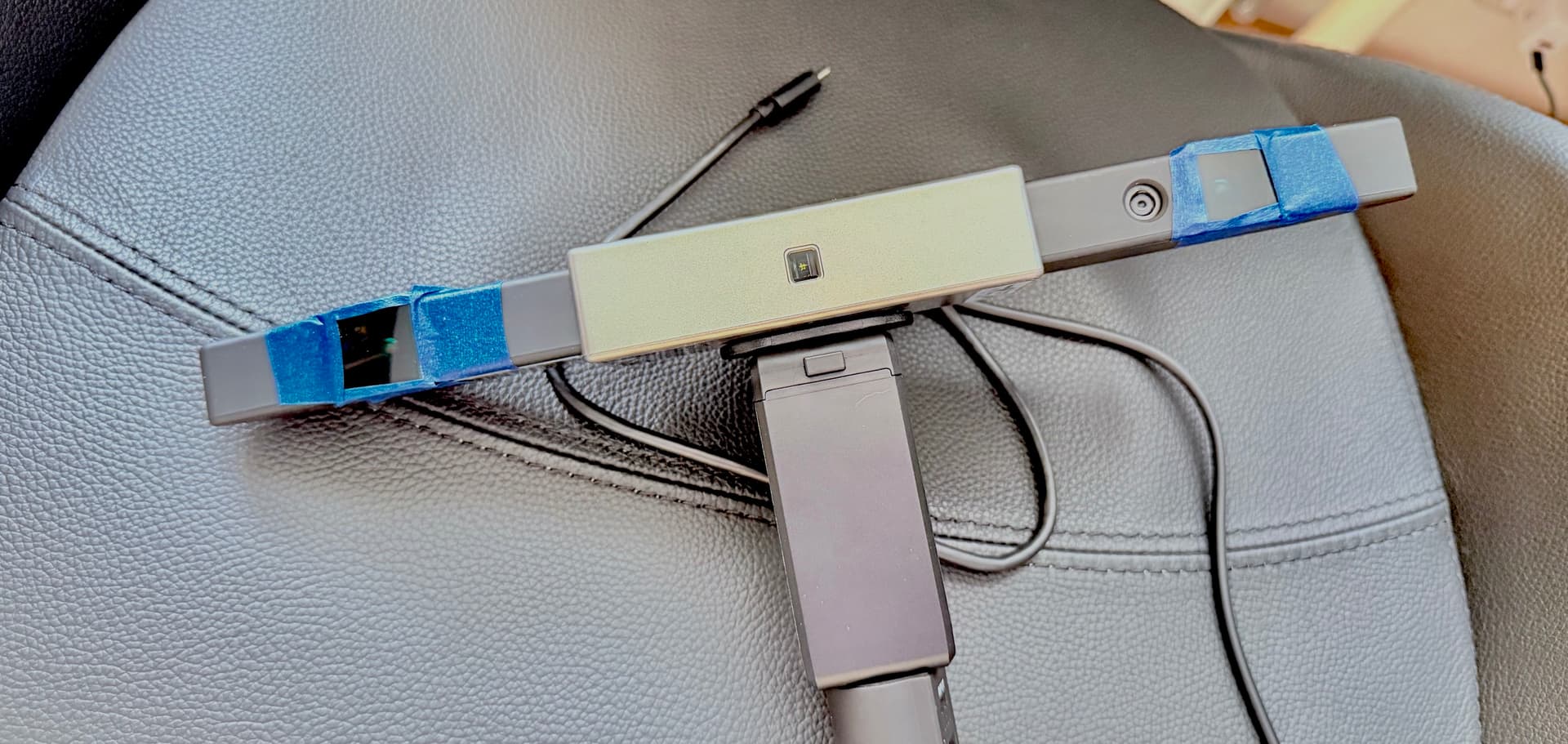

Are there any ‘hacks’ to help NIR scanners work outside? I have already made some ‘shades’ for my Range, which improved the IR sensors from being completely flooded, but it wasn’t good enough for real work.

You can’t filter out infrared light outdoors because the scanners project also infrared so that would make no sense .
I did scanned outdoors with Range 1 and it was on sunny day , the sculpture was inside gazebo , I used dark object settings and set exposure to Auto.
