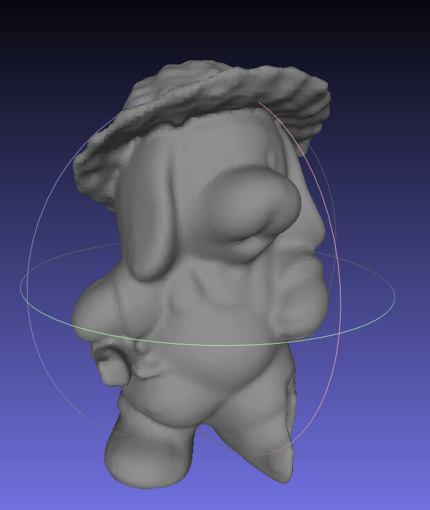

Bonus: Here’s a scan I made today which took about 1000 frames
