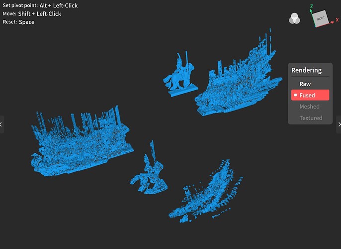

I will investigate further, but something weird is going on where it looks like the scanner position is not being used correctly in the fusion process. It will look OK while scanning, but upon fusing you get this fun with a handheld scan:
This is baked into the project file somewhere, as fusing on PC (screenshot is from PC) gives the same result as fusing in iOS.

The odd alignment I encountered only seems to affect my Mini2. I can’t replicate the issue with my Range2. On the Mini2, if I change scan settings the alignment issue goes away, but it returns when I force quit and reload Revoscan. The issue does not occur with the desktop version.
