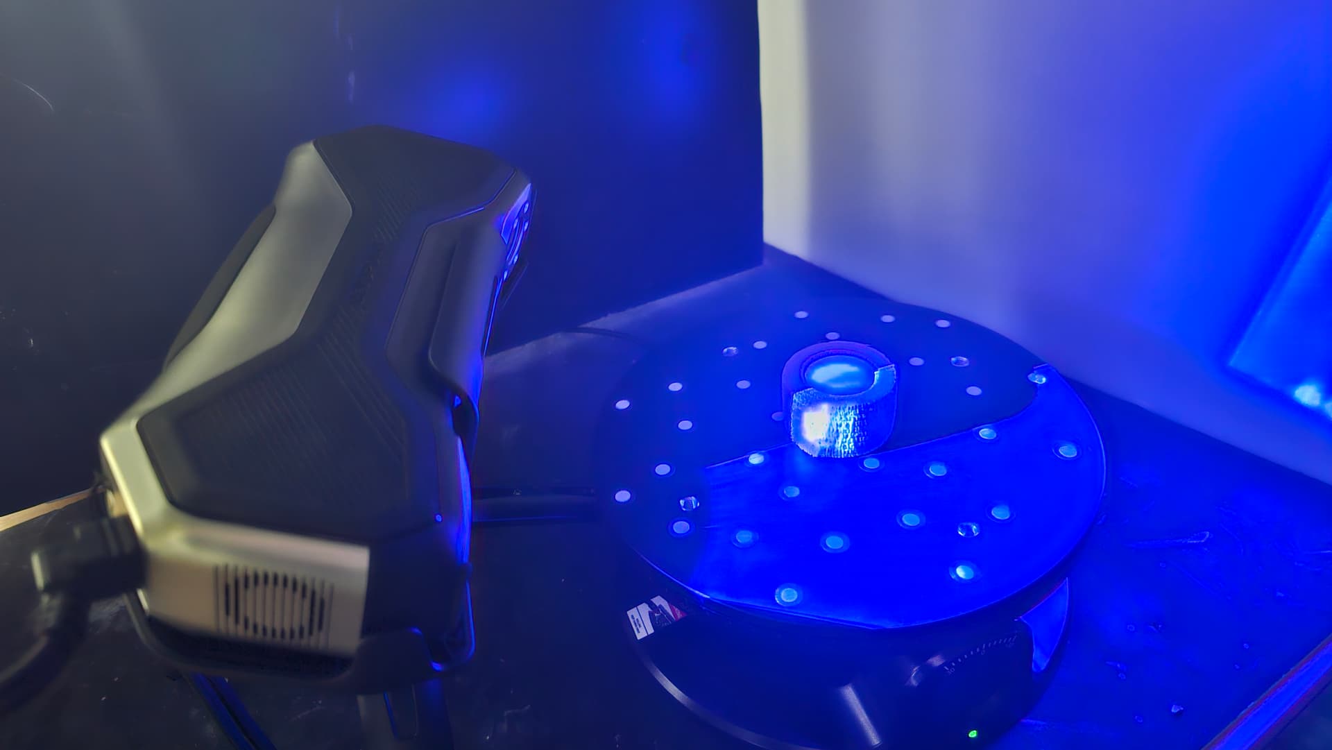

I got my New Metro X Today.
I was really looking forward to the day I tried to scan by Metro X First time.
Read Manual, Re intstalled Revo Scan Program for Metro X, and Connected.
And I tried to scan anything near me. It was a Band Tape.
But When I try to Scan, I couldn’t scan anything By Metro X.
I tried to scan in 2 hours, but I couldn’t find out the reason.
I upload some picture of my metro X’s state.
Please Help me…
I can’t scan anything even The White Sample Bust…
My Metro X can’t Catch anything right infront of it now.

and I’m also keeping try again and again… I can make sure it is the problem of my product. it can’t scan anything. it has a troble. it catch some weird things not straight direction.

7line/14 line laser mode need enough marker to work, might be this cause the issue , in your mode1 picture
The scanning distance in Full Field are too great.
You need to hold your scanner at a specific distance above your object and move your hand back and forth to be able to capture proper an object using Laser mode .

Can you try something for me? Can you point the scanner vertically down at the turntable in laser mode? You won’t get any tracking at all at that shallow angle. You need to hand hold scanning in the laser modes.
If the lasers fail to activate in either cross lines or parallel lines modes when pointing directly at the turntable then you may indeed have a fault.
Something else you can test for me, switch to full field and put the Agrippa bust on the build platform and report back what you see.
Essentially, if you are trying to scan in laser modes with the scanner on the tripod at that angle then you’re not going to get anything. Also if you are trying to scan in feature tracking mode, full field you also won’t get anything because the object you have there on your turntable has no features.
I already tried all way
Differant distance, angle, light on/off
But It can’t catch anything.
I’m going to upload the picture you said soon.
(I’m not my workshop now please wait)
