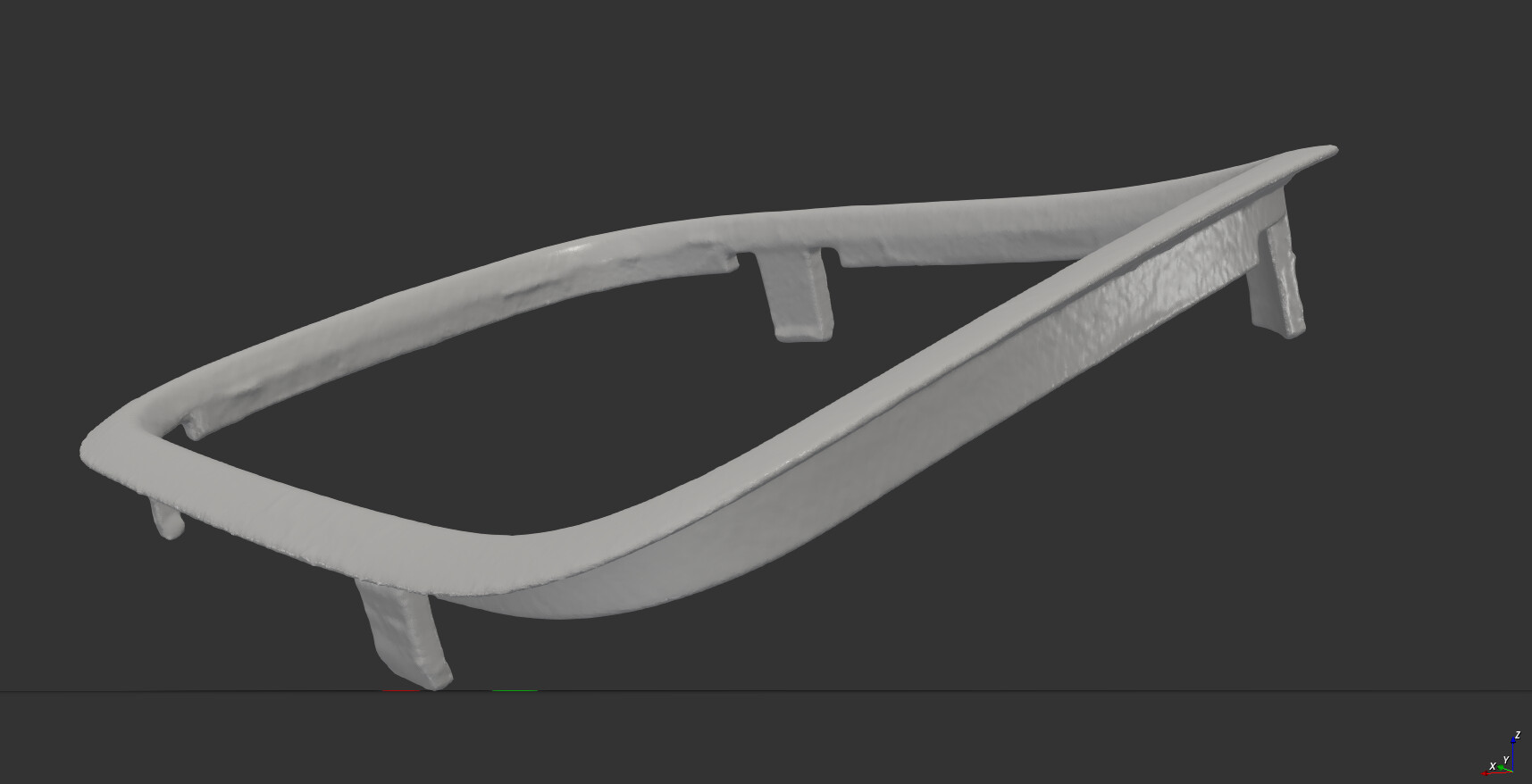

I barely managed to get this result. I stitched 6 scans.
All the parts in blur. Surface not smooth. I want to sell this scanner…no sharp edges =((

If you use laser mode you need at least 8K of frames to be captured for getting the smooth surface per scanned angle.
With Full Field you get the same with just 360 frames and very smooth results.
Don’t use the Fusing settings at the highest as your currently object don’t require that settings 0.2 or 0.1 mm is more than enough , then after clean it from overlapped and lose points and mesh with the same Grid settings as your fusing settings for best results .
