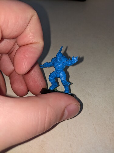

Alright, I got the cable, everything works like it should now. On to the project I need some advice for! I am trying to scan my collection of wargaming models, as I would really like to edit them in a 3d modelling software and have some unique poses on the table, but still have them look thematically the same. I took some photos of the model I want to start with so everyone can see the level of detail I’m hoping to capture (especially after seeing some of the showcases on here!)
Now, for reference, he’s about 2 and a half centimeters tall, not including the base. Here I will show the start of the process of scanning from the screenshots I took, and maybe we can see what I need to do to improve the quality.
I hope those show the settings properly, the reason I meshed it at the quality I did was that I had seen on a different post that someone was talking about needing to keep the grid size close to the cloud point fusion setting. I later tried to mesh it on the highest quality setting, and got much the same result. I am completely ready to admit that I don’t have any idea of what I am doing wrong that so much of the detail is gone, and would appreciate any help I can get. If possible, I would like to avoid having to use scanning spray, due to cost concerns and the fact that most of my models I want to scan are hand painted. If that’s going to be the difference between what I have here and getting a good result, though, I will do that.
First of all the size of the figurines are too small to use with MIRACO , you will need MINI with 0.02mm accuracy to get better results here and capture the details , MIRACO don’t have the capacity to capture 1-1 of that scale .

Materials like shiny plastic , resin , waxes are hard to scan due to IOR or reflection .
Some acrylics paints are not scannable for example black acrylics , not due to the color but the material that makes the color .
Can you get better results ? Yes slightly with 3D Spray but don’t expect 1:1 copy
If your minis are not painted you can use rice starch and alcohol and paint them white with a brush , and after just use dry brush to clean it up .
BTW your fusing and meshing settings are spot on !

You can try single shot mode , make sure you don’t scan resin or shiny plastic , scan at least 3 angles , one angle will not give you sharp edges. At least 2 angles . Keep the distance excellent and Miraco at 45 degrees to your scanned model , the excellent distance is from the center of the turntable to Miraco .
You can get still better results since I scanned a coin with beautiful details so I guess with little practice you can get better results . Just avoid materials that diffuse light … like resin, wax, and anything with that have IOR ( high level of index of refraction )
If you paint your mini with a white matte primer, it would be a good step .
