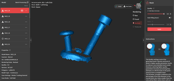

I tested both version and Full Field and Auto Turntable mode
exposure at 1
Fusing settings
Meshing settings according to Grid /Fusing parameters
Full Field mode result
Auto Turntable mode results
both full scans at all angles
Here is a real time preview ( may be slightly different based on a graphic card and I use GPU rendering ON )
Now you can compare to yours , as I told you , there is hardware issue , no doubt it
NOTE : Never use just single shot frame for reproducing your object, single shot frame is not 3D it is just 2D relief, Full Field usually need at least 12 to 64 single frames to capture the object, one single frame not even capture object surface fully, there are missing points so it need couple of them .
so for evaluation just run at least one rotation of your object
only one frame shot Full Field
64 single shot frames Full Field
see the difference

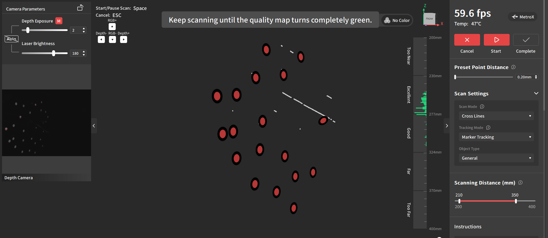

Yes cross lines, i donβt know why cross lines better scan when parallel.
Yeh big horse ![]()
we need to rest and discuss with the other participants what to do next.
p.s. I need make our software - you know scanner with open api with cross line mode ?
