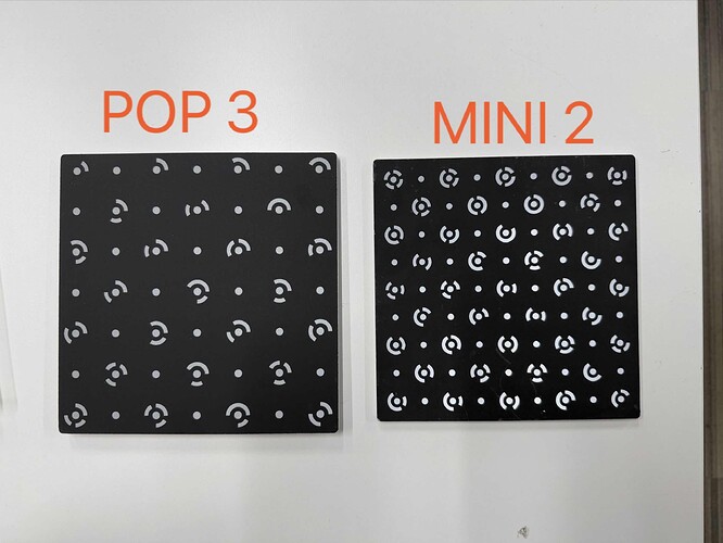

It is not , that are 2 different boards and none of them is glass , the glass is for POP3 Plus, MIRACO’s Near Mode and Mini 2 Pro that was never released.
POP3 left and Mini 2 right

Could you please confirm the type of calibration board you received? According to what PUTV mentioned, the calibration board for the POP 3 is the one on the left, while the MINI 2 currently ships with the calibration board on the right (which means the one you received should be the smaller version on the right).
Neither of these calibration boards is made of glass. Glass calibration boards started being included as standard with the POP 3 Plus 3D scanner, and it can also be purchased separately on our official website. If you wish to use a glass calibration board with the MINI 2, please update to the latest software version (V5.5.2) to ensure compatibility.

Yes, I have the board on the right for the MINI 2. First of all, I didn’t even think there were so many versions of the boards. Secondly, you need to look closely enough to see the difference. I managed to calibrate my MINI2 with the supplied board. Thanks a lot for the clarifications, before these clarifications I was in shock and didn’t know how to calibrate my MINI2.
I have so many of them that sometimes it is hard to follow , but after the last update of RS 5.5.2 now the glass board covering Mini 2, POP3 Plus, Miraco, MIRACO Plus , one board for all reducing the need for the old boards.
