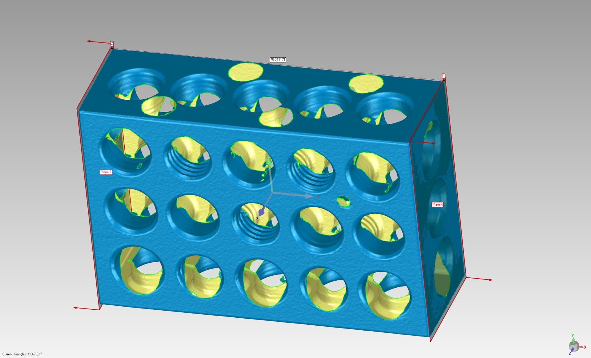

I did an actual accuracy check on the mini2 and this was my method and my results:
I used a 25-50-75 block (same as 1-2-3 block in the US, but this one is metric). These metal blocks are used in cnc mills to clamp and position workpieces.They are ground flat and square to exact nominal edge lengths of 25mm, 50mm and 75mm.
This one I got sandblasted to get a matte grey finish for scanning, without using scanning spray, so theres no additional thickness gain by it.
Scanned the object on turntable in marker mode from two opposite sides, one lap around the object in each scan.
The two halves were aligned and meshed in geomagic afterwards.
Plane features were created right on thescan data.
I’mcurious of others results!
Update on mini 2 accuracy:
Using the latest 5.4.7 version of revoscan 5, I scanned the block again, using the same methods as before, with the new fusion algorythm, accuracy increased a great deal:
Accuracy will wary regarding the object size , the angle , distance , fusing and meshing parameters used and if course the surface preparation as it can induce or not some level of noises .
