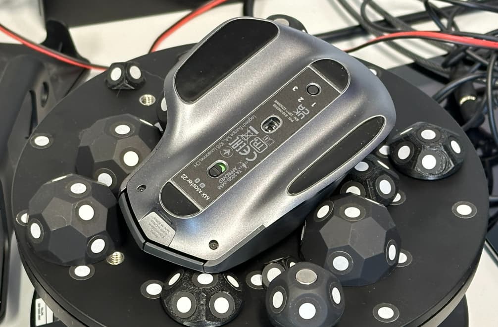

I have a Logitech MX Master here at my desk. I’ll do a scan for you later today.

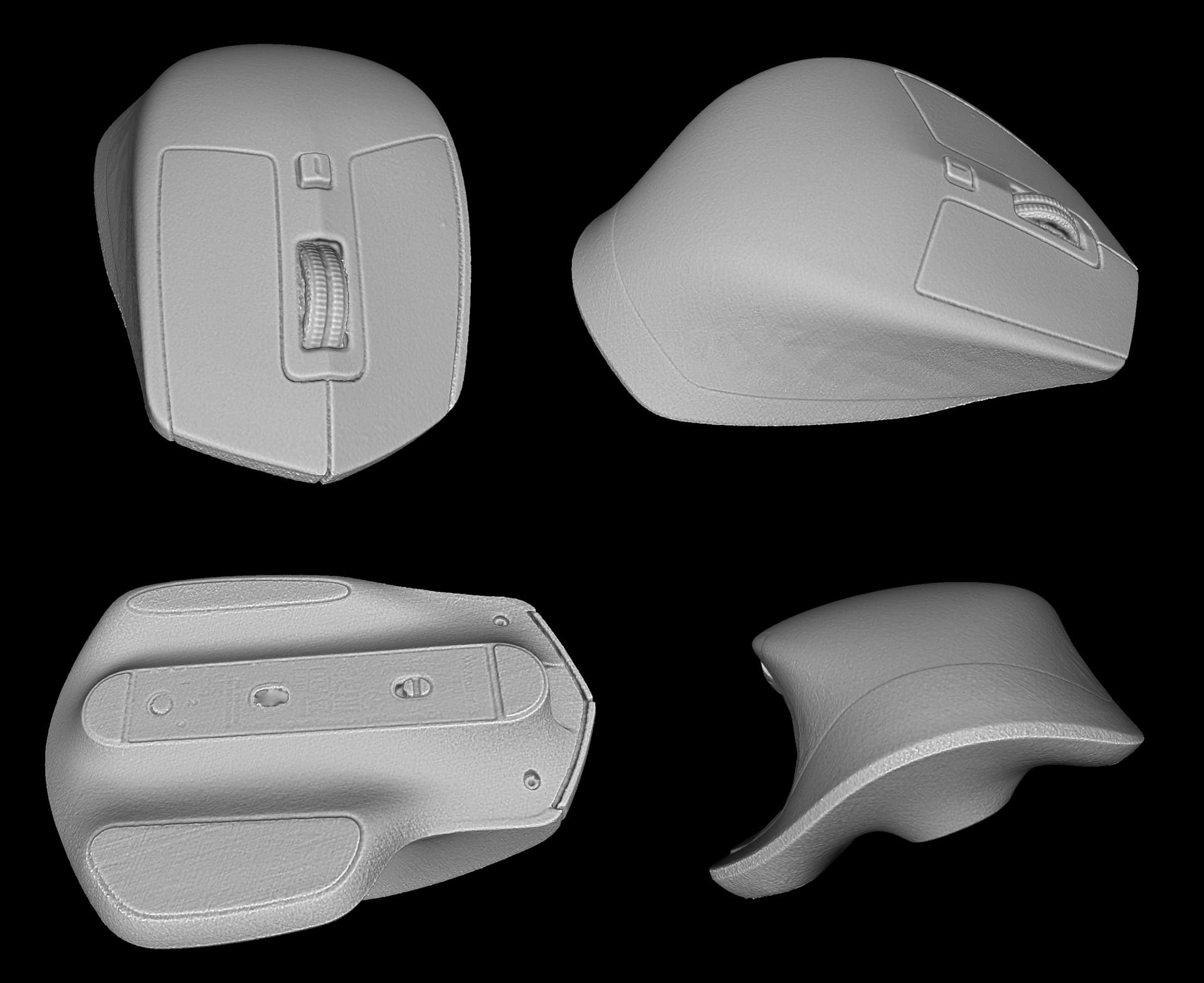

Here you go @theFlow I scanned the MX master in cross lines mode. I’ll have a go at it in full field mode in a bit.
And here it is in full field mode. Not a great scan and not something I would normally use to show off. Scanned in full-field mode. No spray. 3 scans that were merged. No cleanup other than isolated points.
I had to scan at gain 6 to capture the shiny and dark areas and this caused a lot of noise. It’s still OK and perfectly useable, just not very pretty.
