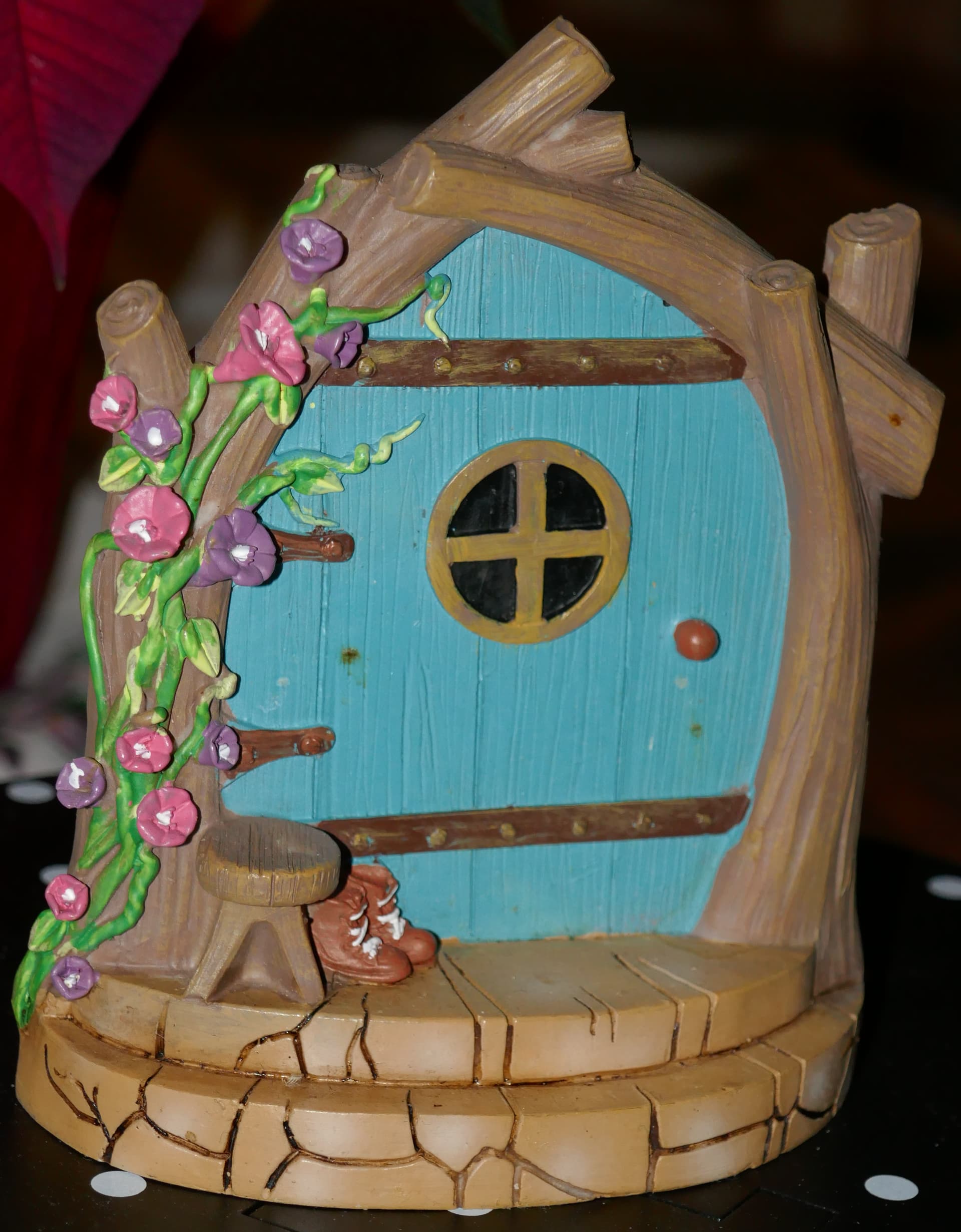

One of the tchotchkes my girlfriend likes is a Fairy Door.
It scanned pretty well (meshed in Revo Scan).
The black (supposed to be) window panes need some cleanup and there is a minor error on the right side of the door frame that I will have to investigate, but the overall results are quite nice.

The color scan worked well. I had been concerned that the cyan-colored door would not come across well, but was happily wrong.
Before texture application.
With texture applied.
What happened to the mustard wood color ? Why it is gray ?
In your first picture it shows different wood color ?
The photograph was taken with a flash. The color scan was made with the afternoon sun lighting a wall some 15’ away and off to the side.
What impressed me was the 4 black sections representing window panes. Without color, they were irregular, but are now flat.
