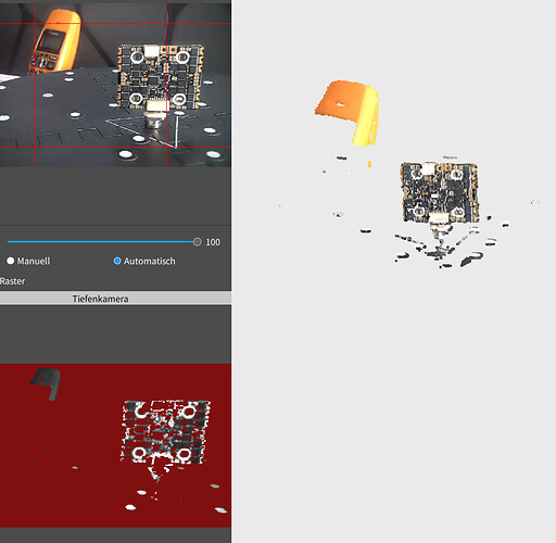

I spend a lot of time learning about the POP2 scanner. I believe that this is great hard- and software. Nevertheless the software needs some improvements as far as I can tell, because it looses the track and doubles the surface on e.g. the second rotation. I tried to scan a body and it looses the track very easy. It also spins the object upside down for no reason. I thought the IMU should prevent this. Is there something like a gimbal lock? Maybe quaternions can help here.
I look forward to see some bugs worked out. To speed up this process I would like to have a debug version with most parameters open and to add a few additional parameters. Users could share the best parameters here to generate a standard-set. For example: Add the min and maximum distance. If you have objects behind the platform like shown in my picture I would like to set the maximum distance to e.g. 15cm. So every object behind will not be used. Also a minimum distance would also be great.
I also would like to have parameters for the circle detection. I like to adjust the threshold for that detection, because it is not detection all of the circles, when the angle or the light is wrong. Maybe a “grey code wheel” as a sticker for the platform would be a precise and easy to encode solution instead of the marker. I also like to disable the turn-table mode. This combined mode seems to be user friendly at first, because you can switch to hand-scanning without configuration, but I tried to scan bigger flat objects with markers and it started rotating the scan like it would be on a turn table. In my case I tried to scan the bottom of a guitar.

Thats it for the feedback. I could need some assistance trying to scan the PCB from the picture. I try to archive the 0.1mm resolution with sharp edges. But it always generates round edges. Also flat surface like the example statue is always very rough. I can clean with Studio, but It seems that I loose precision.
I already tried to calibrate the scanner (20x or more with camera gimbal to ensure it is flat), but it is always the same rough surface. I do not know if this is normal or not.
Is it normal, that the right-side of the image is used for scanning and the left side is not scanning?
Left side:
Right side:
