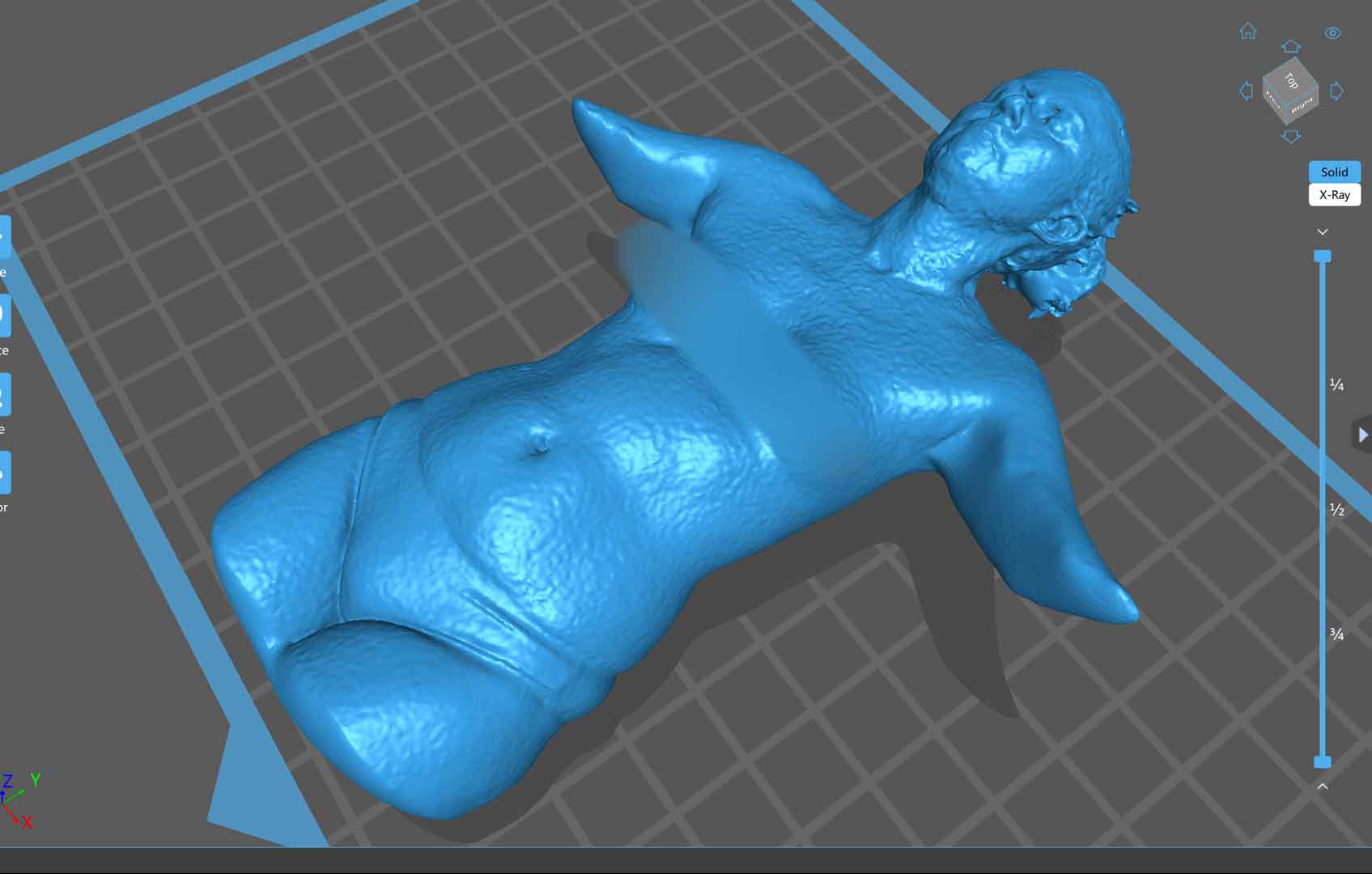

I made a 24" turntable with poles for the arms to stabilize her a bit. The whole process took about 10 mins. An uncomfortable amount of time to be standing tall and still… But we got it done.
My first scan had trouble as the scanner was tripod mounted, the range to the subject kept changing as shoulders moved in and out of frame, So I got a good amount of digital noise in the first scans. tracking was also… challenging…
But we eventually succeeded and got a full scan done that was useable after some smoothing due to digital noise.
This led to my first successful project of creating a basic chest plate by cutting away the parts I didn’t want and 3d resin printing them out. finished in Urethane automotive paint.
