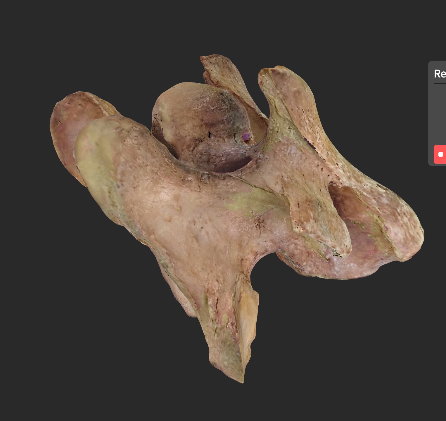

Good to know. Also good (for me) is that not all of them are that âcolorfulâ and I can manage by opening the .txt file in Lightroom and tweaking the saturation/hues.
This is the result of my tweaking (same file as previous attached)
This is pretty much true to life!
Excellent color palette Pamela , well done !
You getting better and better with the scanning !

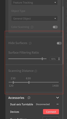

thanks for sharing your skills! I see, your bones are shaped as voluminous that you can flip them upside down and resume scanning. But you must enable âhide planesâ for not having the turntable form both sides on your scan?

Yes, I Hide Surfaces and also set the Scanning Distance to a more narrow window, typically 130-380.
