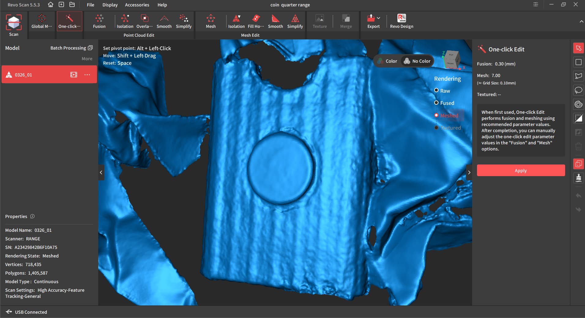

Just for the fun of it I scanned a US quarter tonight. It is smaller than your coin but not by a whole lot. I sprayed it with attblime permanent grey. For the first 3 scans I used the old little turntable that came with my pop2 and for those I used continuous feature tracking with the crumpled paper around it to make sure it knew it’s whereabouts. The last scan was with the auto turntable mode and metrox. I haven’t calibrated the metrox in quite some time and did a firmware update recently also so it may get a little better. No cleanup on any of them besides generic isolation and overlap. These were also done at a 45 degree angle to the coin, not head on.

Excellent information thanks. It convinces me that with the right scanner, the fidelity of what I need is there. That quality of your last image is perfect for my needs.
