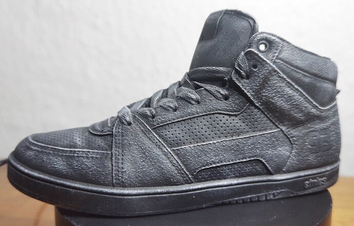

Here’s my most recent scan and print of (another) sneaker. I’m most happy with the detail and the scanning process (single-shot-mode, one scan).
Unfortunately there’s an area of misalignment that I only noticed after two prints failing on the same spot:
