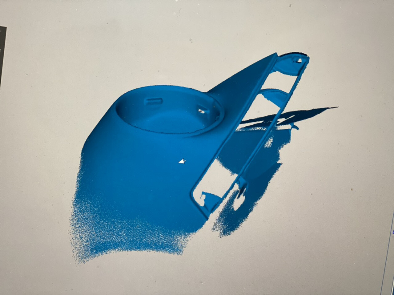

This section was about 5 minutes of playing around. Front bumper of my porsche IROC style, the car is matte white so it worked great
You used markers or not ?
No markers, with the Matte white 3D scanning works well. The issue most will have without a dulling spray is the sensors have a hard time unless it is Matte white. This scan was literally my first try just in my shop with the car up in the air to see what I can do. The data points are dead on and I could use to make parts easily. I have some spray coming to test on shiny parts like my headlights, but I am sure based on this simple test it will work.

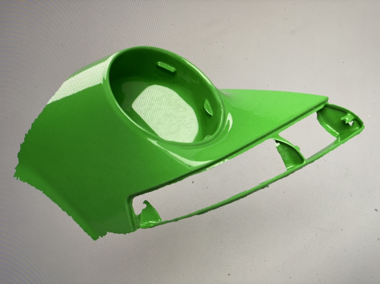

Here Is my first scan for making and building real car parts. Once I scaled it down by 90% it seems almost dead on. I’m going to cut a mold to stamp a steel blank so I’ll be able to tell soon how exact it is

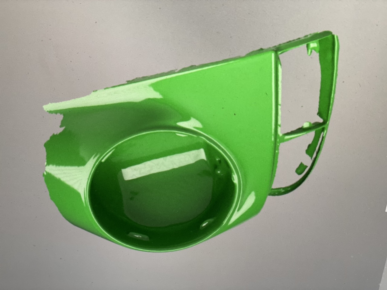

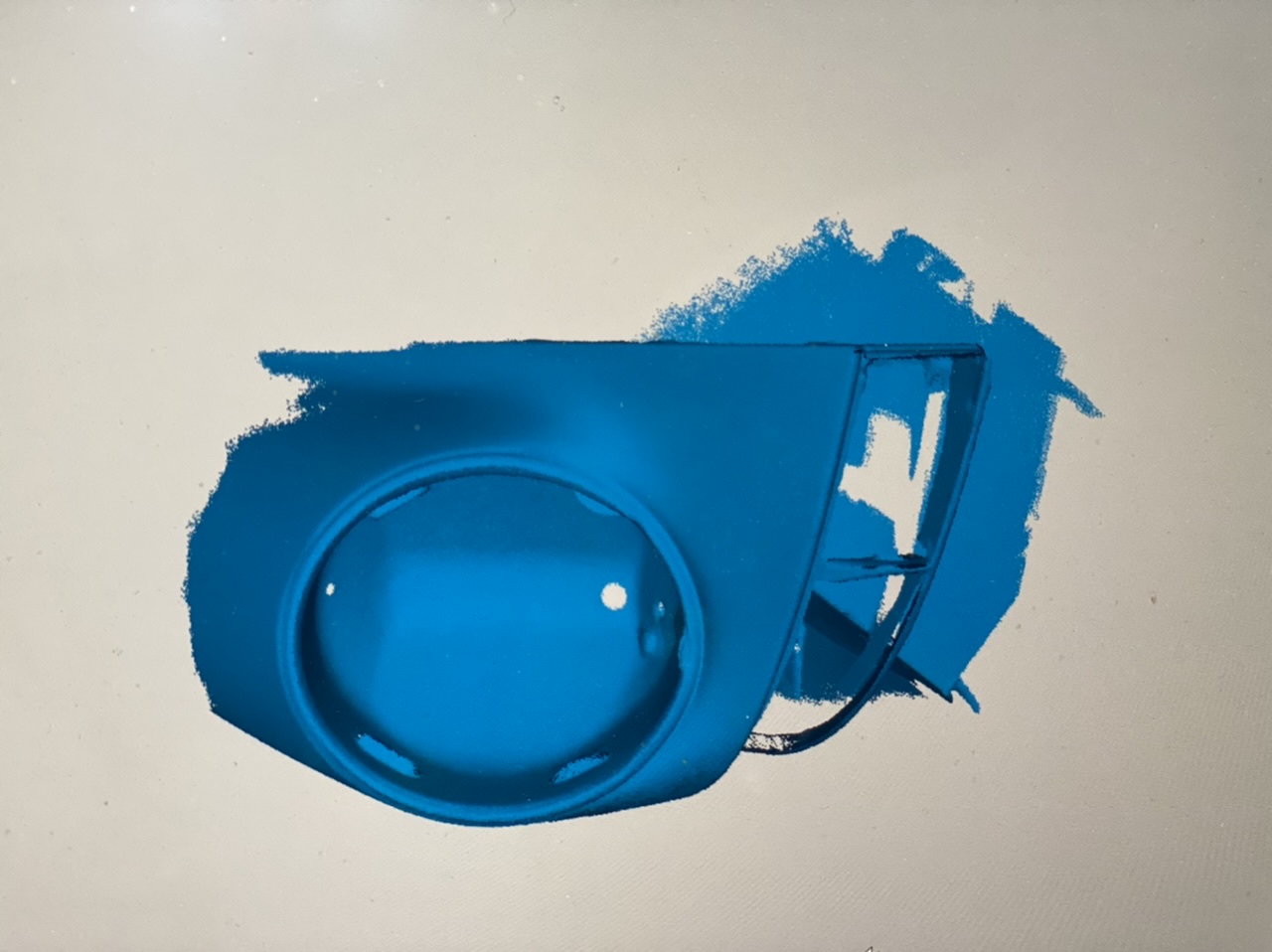

Lots of new progress testing the scanner, using body and then scanning a main alignment area (in this case the headlight bucket) I scan, press space bar to pause, align with the bucket in the screen, hit space it aligns then scan more sections. I’m blown away by the quality!
