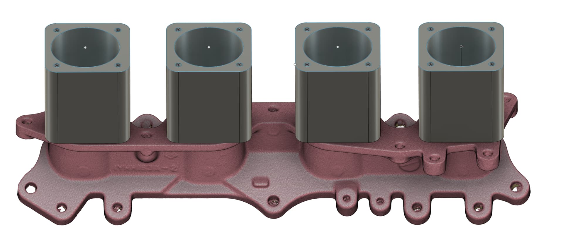

Here modeling intake adapter to throttlebodies
Really not the easiest part to scan. alloy and shiny part. Did take few atempts to get good scan. trakking dots on scan plate and “spray” to item and just multiple scans. Dimensions look really good and speeds up working lot.
Very good scan @corolla , structured light scanners can’t project well pattern on metal and shiny objects, it is like projecting a movie on a shiny metal , you will see not much , for that reason the surface need to be matte enough so the sensors can see well the projected pattern. So this is not the scanner issue but the surfaces.
Anyway you managed it well !
