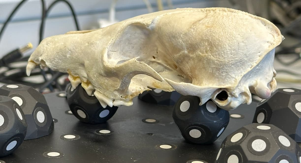

- Rise up - Try to raise any object you want to scan off the platform it’s sitting on. This will reduce artifacts at the interface between the object and the platform.
- Marker targets - If you don’t have the marker targets from the advanced package, make some. There are tons of marker targets on Printables and MakerWorld for you to download and 3D print
