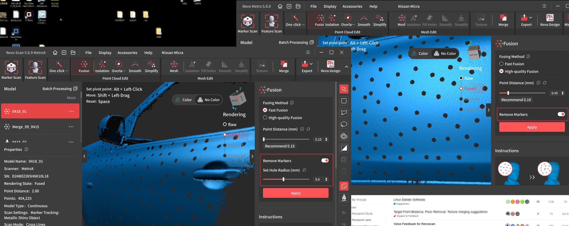

wondering is it possible to bring the function back from the previous version
”remove markers → Set hole radius (mm)”
or is there any alternative method replaced?

thx for reply, i knew its already archived,
but will this function br re-add into future version? coz it does make big different before hole fill process
with old version, there is hole radius, and final hole fill is smooth
but with ver 5.80, same process the hole fill is noticable, any work around for this?
although v5.8 has huge imrovement of processing speed, but the hole fill function is un-useable

Hi Ken, I can confirm this issue as I was testing out again everything and reported back to the Dev team last night fir revision.
In some cases the marker holes are not even closed while fusing as it should by selecting the option ( remove markers ) it do remove the markers but not close the holes behind as it should. The (closing hole ) function after meshing do create bulges as well so slightly backward .
Hopefully new version will be released ASAP addressing the issues.
