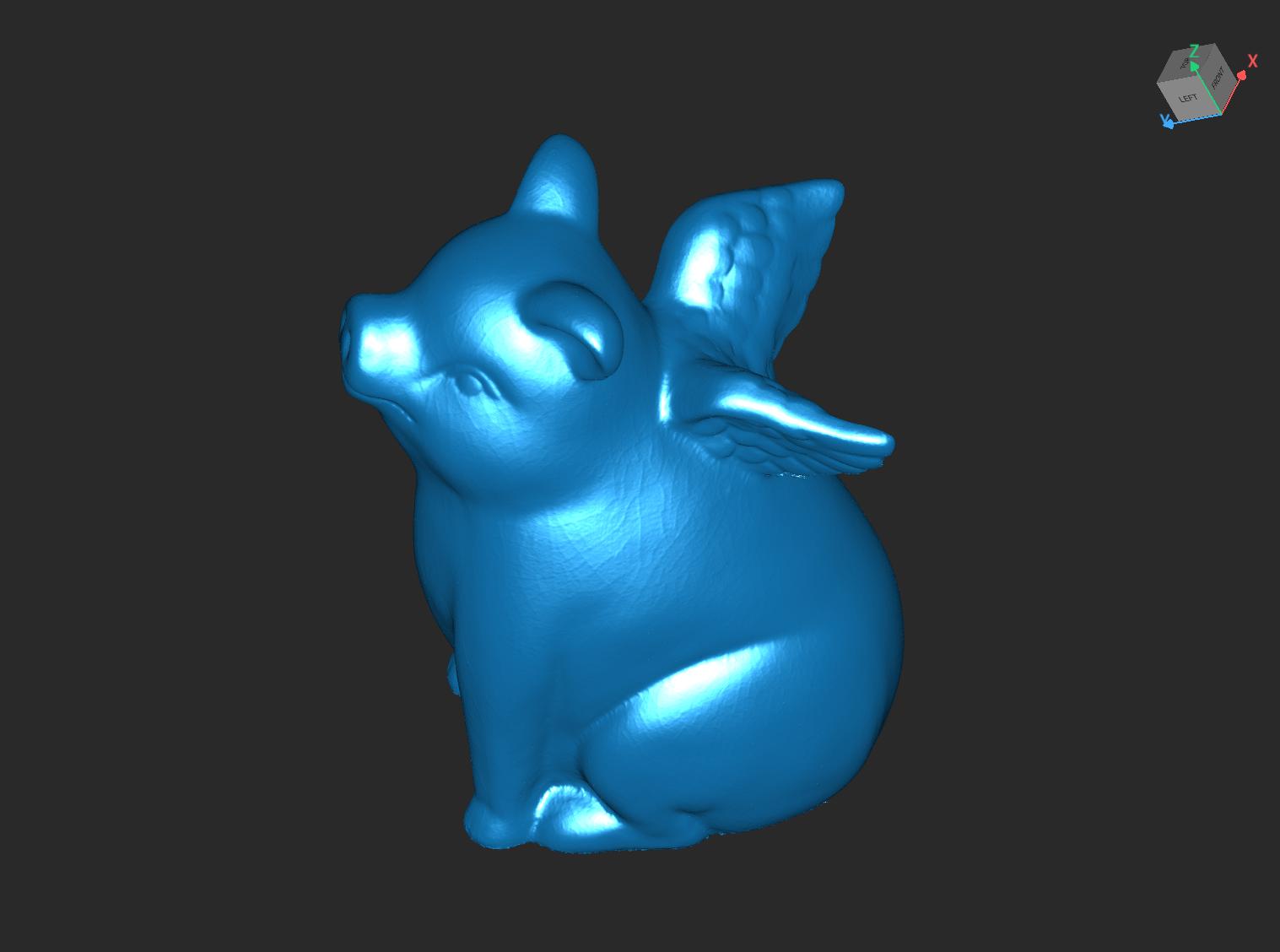

This is the exact same scan of a small toy dinosaur I scanned using my Inspire.
The smoothing in Revoscan hides more detail than the other application (Microsoft 3D Builder).

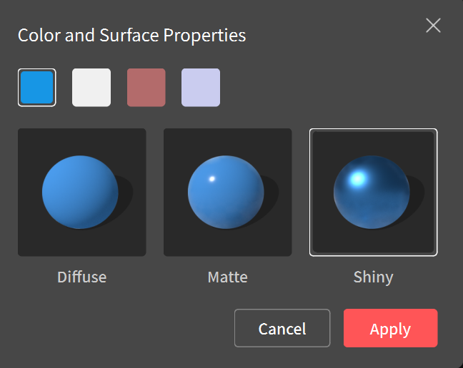

As an alternative, you can also adjust the perceived detail in Revoscan by navigating to Model Properties and changing Color and Surface Properties to “Shiny”.
The Shiny selection will show more detail than the other options that you might not realize is there otherwise.
Below is the same model with Diffuse and Shiny. Notice the crack pattern in the surface showing with the Shiny option, but not in the Diffuse option.
Basically, a lot of it comes down to visual perception - your model likely already has more detail than you realize!
