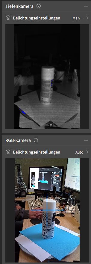

just started after a long time with my Range and Revo Scan 5. When I watched the howto videos I realized that the depth camera and the RGB cameras are not fully alligned but tilted against each other.
Is this an issue and if yes, what to do?
I attach a screenshot to show it.

@Atsch Hi Atsch, from the picture, it shows all good.
Whether the depth and RGB are aligned depends on the intermediate point cloud, not the camera content. The cameras themselves are mounted in different positions with slightly different field of view coverage.
Did you meet any trouble using the scanner? If yes, we can have an online meeting to help you solve this, don’t worry.
