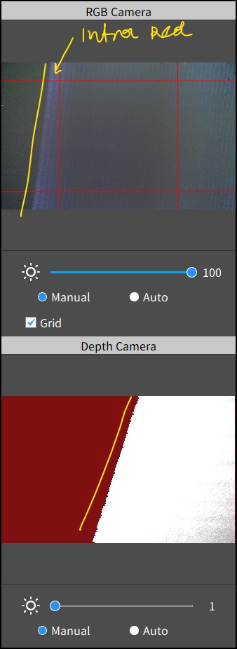

I have just recently received my POP2 and have been going through the “getting to know you” phase with the scanner. As I have been doing my testing I noticed something which I wanted to validate with Revopoint, other users, to understand if it may be a factor in some of the issues I have been experiencing. I’ll start by saying I have quite a few 3D scanners in my arsenal ranging from standard light projection, to IR, to LiDAR standalone (Intel L515) and integrated units (ala iPad PRO), so I am very familiar with the trials and tribulations involved with 3D scanning as well as the strengths and weaknesses of the various technologies employed. As I have been testing the POP2 I have been having quite a bit of trouble with both obtaining and maintaining tracking in what should be ideal conditions. I am not yet ready to say there is a problem with my unit, however, as the POP2 is new to me, and even with the other experience each device is unique. I did notice something, however, that if it is not an expected/normal state, could be directly responsible or at least exacerbating my general scanning and tracking issues. This post is to put it out there, and see if others have noticed it, or at very least find out if it’s a normal state for this device .
The Issue:
I first noticed this on the iPads PRO connection, what I describe below seems to be a bit more noticeable in the mobile app for some reason, possibly just because of the extremely bright/crisp screen. While observing the depth sensor feed I started to notice that 1. there is a pretty serious amount of parallax between the depth and the RGB camera views. They are far enough apart that I expect this some, but they also appear to be operating at different focal lengths. It’s entirely possible that this is normal, but I wanted to note it as it did seem a little more extreme than I expected. 2. As I see data move over the depth sensor, I noticed that the feed appears to be coming in a bit cockeyed as if it were not mounted straight. The first issue I have seen before, at least in part in other devices; this, however, I have not, and as such is what I am most interested in validating to be an issue, or not an issue, so that I do not tread down pointless troubleshooting paths. Other than describing it as cockeyed, or tilted, I think a screenshot will best illustrate. It’s possible I’m seeing a cropped part of a very wide angle lens view (say the NW corner) which might make it appear slanted from that perspective, but without the ability to do a calibration I don’t really have a way to tell for sure if that’s the case or not.
So, next time you scan something, watch your depth feed when on a particularly good full-screen depth hit, and please let me know if you guys are seeing this same behavior below - and if you are seeing it, whether or not you have been able to maintain a reasonable quality of scan and subject tracking. Note that the areas I point out in the screen shot NEVER see any depth hits and remain blank .

The cameras has nothing to do with the scan results , the “Depth Camera” has a different focal length than the RGB but it is only for visualization , but what is really tilted is the Infrared Laser that project the slightly tilted pattern on your object as that is what is important and read by the software .

I don’t believe the tilt matters, as the position of your POP2 while scanning do not influence the scanning result unless the already calibrated MODES ( face, body, feature) do not correspond with the position of the Infrared Sensor
Since the software is still in beta , anything is still possible , but you can’t change the tilt of the infrared laser, you can only adjust the software to its position by calibrating it on different focal length , small drop of a package could influence it already , lucky me I have no issues at all .

@PUTV thank you for sharing your screens with me as well, it is very helpful. I want to be clear about what I was attempting to demonstrate above, though. I am talking about the edge to edge return of depth data on depth camera screen. I can see from your screen shots that you are seeing data edge to edge though it looks like a tilt difference in the subject view. I am not really concerned about that as I know calibration can resolve such things, however, I am not speaking of the RGB texture mapping/calibration at all here, I am talking only about the depth sensor. The view that I showed above was about as close as I could get to illustrating depth detection over the entire frame. The tilted black “frame” that I am pointing out at the far edge of the screen are basically dead spots. No matter how optimal the subject material, distance, or detail level that area of the depth camera never displays any depth data at all. The closest thing I can think of would be to compare it to the “letterbox” view of wide screen video displayed on a 4:3 format display, though obviously not symmetrical or purposeful as in that example. The main reason that this behavior raised a red flag for me, is because that issue, in addition to the behavior of the tracker, both are very similar to what I experienced on another of my IR scanners when it started to go out of depth sensor calibration (not RGB alignment calibration).
All of the things you mentioned regarding subject, detail level, and depth exposure have not really had any demonstrable impact on my tracking results (it has been losing tracking even in good environmental and subject conditions without anything moving at all - it is almost like it is trying to track a ghost image/being spastic, which is again something I have seen when alignment is seriously off). Keeping the sessions short is not really an issue as I have to abort generally before I hit the first threshold anyway. While it feels like past experience with depth calibration problems on similar devices, I do not want to anchor myself in faulty diagnosis or jump to conclusions, however I have to follow Occam’s Razor and do what I can to remove the variable given all of the other things I have ruled out. I have been too busy to keep up on the threads but I am hoping that there is a calibration utility available now for the POP2; I do not wish to waste any more time troubleshooting before I am able to do at least that and mitigate it as a variable. I did also notice that my box was a bit “roughed up” when it arrived, so I am not ruling out that it might have taken a bit more of a tumble than it could absorb without having a negative impact on it somewhere in the shipping/delivery process. :frowning:
@EventHorizon i just calibrated my POP2 yesterday and the infrared patterns now projecting vertically independently from camera position what is new . It is already good but could be better
