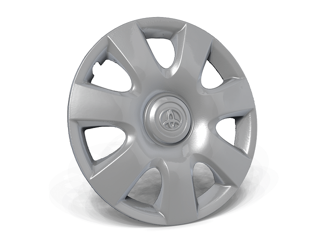

Toyota Wheel - Hubcap Standard Mode | Handheld Scanning
Revo Scan 5.2.4
Zbrush Preview
16 years old souvenir : original Toyota Corolla Wheel Hubcap ![]()
2 scans merged, front and back .
Hybrid - Old and New
Catharina, Your scans are amazing as always! Tell us how you scanned the wheel hudcap. On a turntable or manual scanning? Are you using supplemental light?
Do you have a video recording of the scanning process?
Hi Nick, thank you
I actually needed just the logo , but when I saw how well it scanning I go for a test out .
I put a high can on top of a turntable , then on top I put the hubcap , far away from the bottom around 10 inches , then used my Attblime ABX super white 3D spray since the hubcap was chrome .
I set the scanner on a standard settings and feature mode .
I handheld the scanner and started to scan outside part first , after 350 rotation I moved slowly towards inside until I catch everything . I keep the scan at 45 degrees so it don’t hit just the top flat surface to avoid losing tracking …I did not even once …
The same with the inside part however it was slightly more difficult because I needed to take the inside parts as well .
I had like 2 attempts scans just in case before the 3D spray vanish …
I fused it at 0.35mm and merged inside Revo Scan with around 16 matching points .
To be honest I did not believed it will be successful scan session and merge , but boy I was surprised … and when I saw the metal wire …I was shocked
I scanned in a very dark environment , I just look on the Depth Camera viewer while scanning , I could use tripod arm for more precision , but I wanted to check the IMU capacity.
No I don’t have video while scanning as it was just attempt to capture the logo that got out of hand ![]()
I will make picture of the set later today , if you scan a hubcap make sure it do not touch the ground or top of the turntable , because you will get bad edges .
I made test the other day with POP2 and the results was 50% less good , especially the edges and surface … so for me INSPIRE landed just before POP3 on the list …
Actually You do, you can export your raw capture directly to video with the Frame Player ![]()
I don’t used color scanning so no color frames ![]()
, I may actually create video on that as I think users would be interested to see process like that .
i will update the Player to run on depth converted to Greyscale when no color is present i will tag You when it is done ![]()

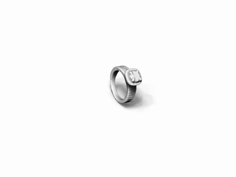

MINIATURE Beta Test Color | Turntable| Standard Feature | Tripod
Revo Scan 5.2.4
[] Standard Fusion at 0.1mm
[] Advanced Fusion at 0.2mm Point Distance
Zbrush Preview

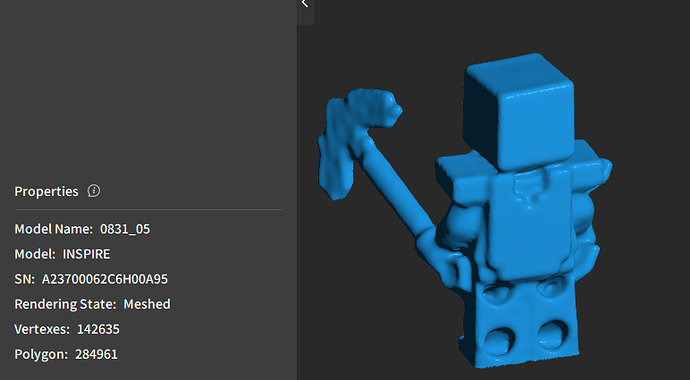

Lego Minecraft
Zbrush Preview
NOTE : Please remember that INSPIRE 3D scanner is not advertised to scan miniatures not it will replace MINI , just becouse we as Beta testers pushing it to its limits to see its hardware potential with our scanning skills and practice , don’t means that what is advertised or claimed by Revopoint. Please always relay on the specifications of a 3D scanner your purchasing according to your needs provided by Revopoint, and you will be never disappointed .
